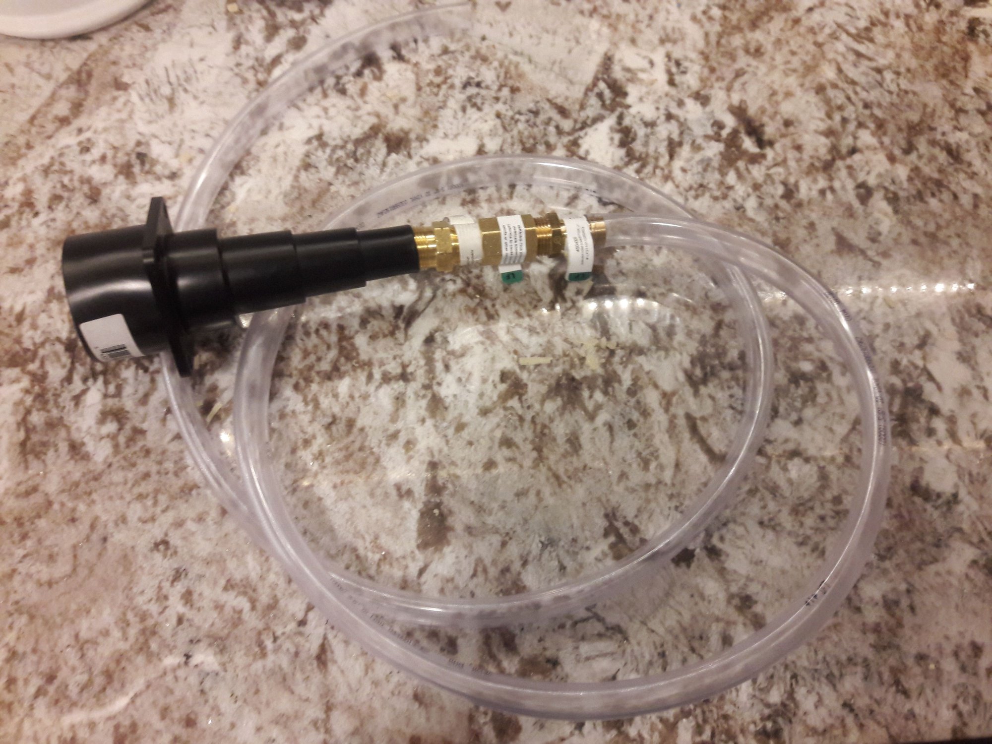

Go to Lowes or Home Depot and buy a piece of 5/16" Tygon hose, about 2-3 feet long. Use duct tape to secure this piece of hose to the nozzle of your shop vac. Also use a little duct tape to seal the gap in the nozzle around the hose, to create better suction. Stick the Tygon tube against the spark plug hole, and (hopefully) suck out the plastic tube. Might help things, if the piston is at the top of the cylinder. If you need to rotate the crank, to raise the piston, do it manually, with a ratchet or breaker bar.

Shop Vac Attachment
This is what I've come up with to attach to a shop vac and reduce down to sparkplug hole size. If the vacuuming doesn't work, I'm not sure what's next. I like the, "grease on a stick idea," but, think I will probably stick the middle of the straw and just knock it off when trying to get it through the hole. I'm hoping with the vacuum, the straw will magically orient itself through the hole. I know, hope is poor strategy...
Scheduled to try the vacuum attachment tomorrow night. Will let you know the results.
