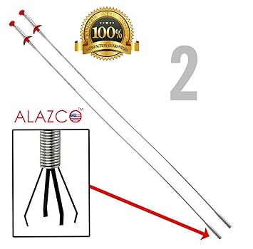

How about one of these?

Those are my plan B. I ought to be able to those and my scope through the sparkplug port but, I have virtually no control of the grabber end once it's in the cylinder. I'll have to get lucky - and if I were lucky, I wouldn't be in this position!
