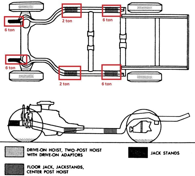

Originally Posted by beneharris
I feel like an idiot for having to ask this question, but here goes. I've got a quick jack, and I've tried a few different spots to lift the car, but every time I do, the driver's door get shoved up into the window channel and won't open. Is that normal on these? The lift goes just about wheel to wheel, and I'm lifting it on the frame right under the doors, about six inches behind each wheel.
Here you go.

Caskiguy, thanks for the diagram. I wasn't too sure about the cradle, but I had seen posts saying to lift there, but it seemed an odd place to lift. I'm glad you set the record straight.

I used the 4 next to the wheels on @caskiguy 's diagram when I put it on my 2 post lift a couple weeks ago. I forgot to unlatch the TTops and the doors. Perhaps I was lucky ... no fiberglass cracks.

Thanks for that diagram, its super useful.
