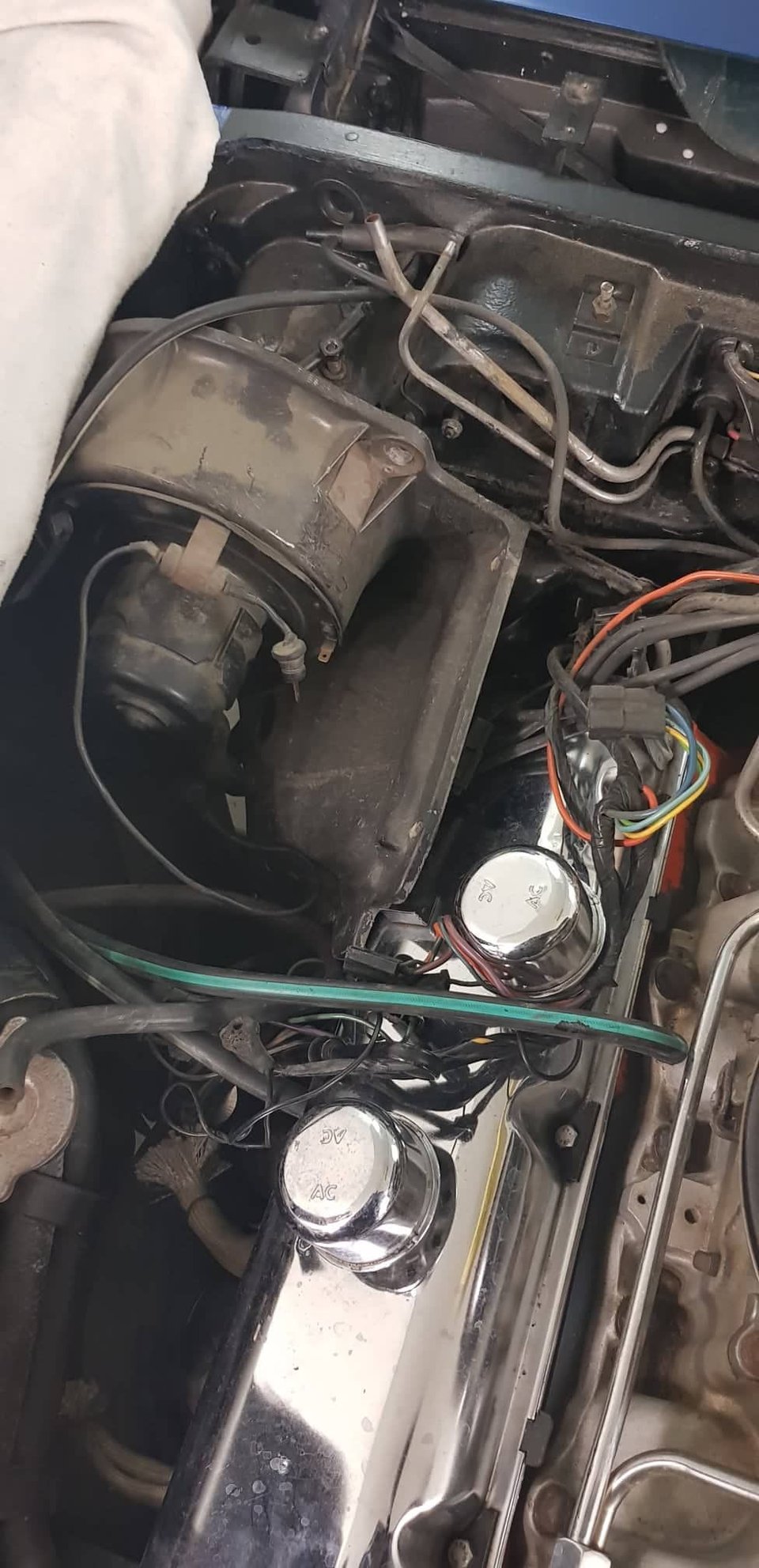

Hi all
I have a ´72 bb that was rebuilt in 2003. At that time the owner left out the AC on the engine but all other ac hardware is still in the car, taking up huge place in my engine bay. To simplify things I want to remove all the parts belonging to the AC as here in Iceland there is little or no need for AC anyway but I need the heat blower to stay in place. The space is very tight around the heat blower and Im wondering if anybody has done some write up of the removal of those left over ac parts. I know I need a AC delete plate or in my case I will build it my self. As well, is there something I need to be careful with?

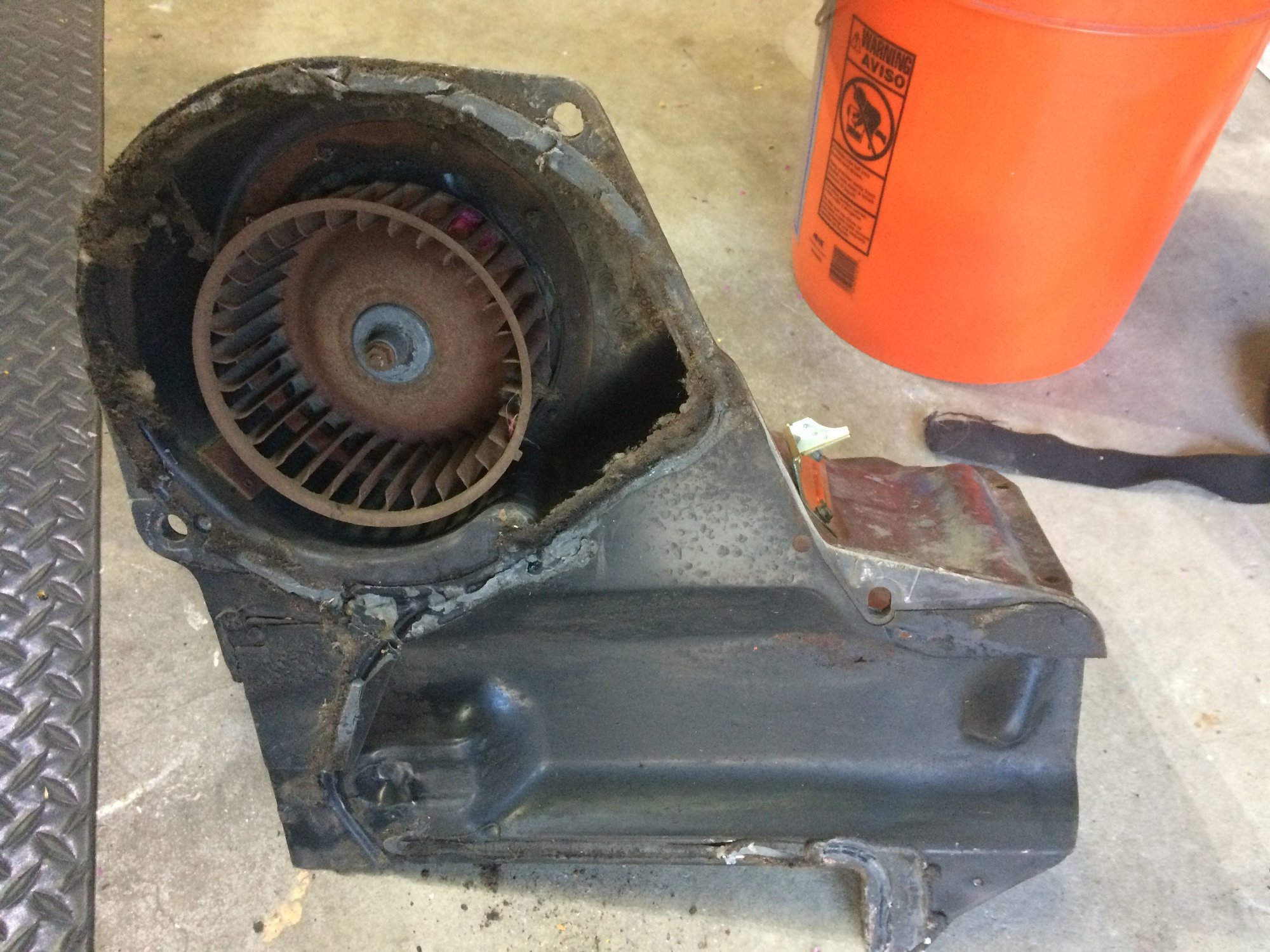

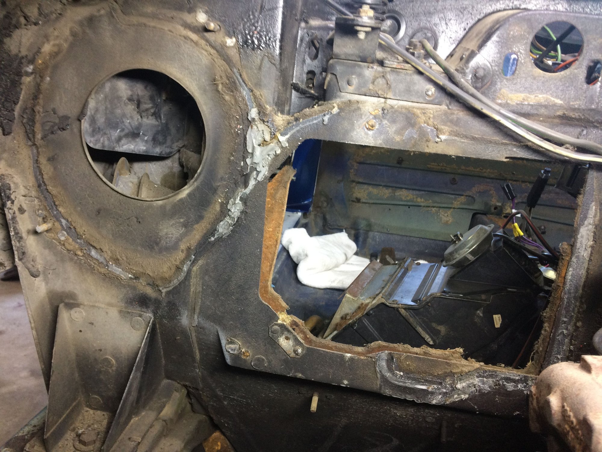

Remove the splash panel underneath below the side grill, then remove the side grill, careful (apply a lubricant to help loosen any fasteners, sparingly of course) this will give you access under the car. Here are a few pictures: Btw, Love your country, cars shows at the hall and Black Church.
Take pictures of everything you do. Think it through, it can be done.

Thanks 7T1vette for your response. All you say is true and I should figure out the problem before I tear everything a part BUT what I actually am aiming for is movement of fresh air, no heat or no cold. The average temp here during summer is 13°C(55F) to 20°C(70) so there is actually not need for heater nor AC, just fresh air. The BB makes sure that I do not need heater anyway :-)

Thanks caskiguy
I hope you enjoyed your stay in Iceland :-) and maybe we have met without knowing it at Harpan where the carpicture is taken. Thanks for great pictures, some of them I have not seen be for and was looking for. In my case, the things that are missing in my car to day are at least,
1) Retainer to Fender skirt
2) Condenser inlet hose
3) Condenser and the condenser bracket
4) Receiver dryer.
So by the parts Im missing in the AC the easiest way to go is to clear the rest out of the engine bay and those pictures help me realize what needs to go and what should stay.

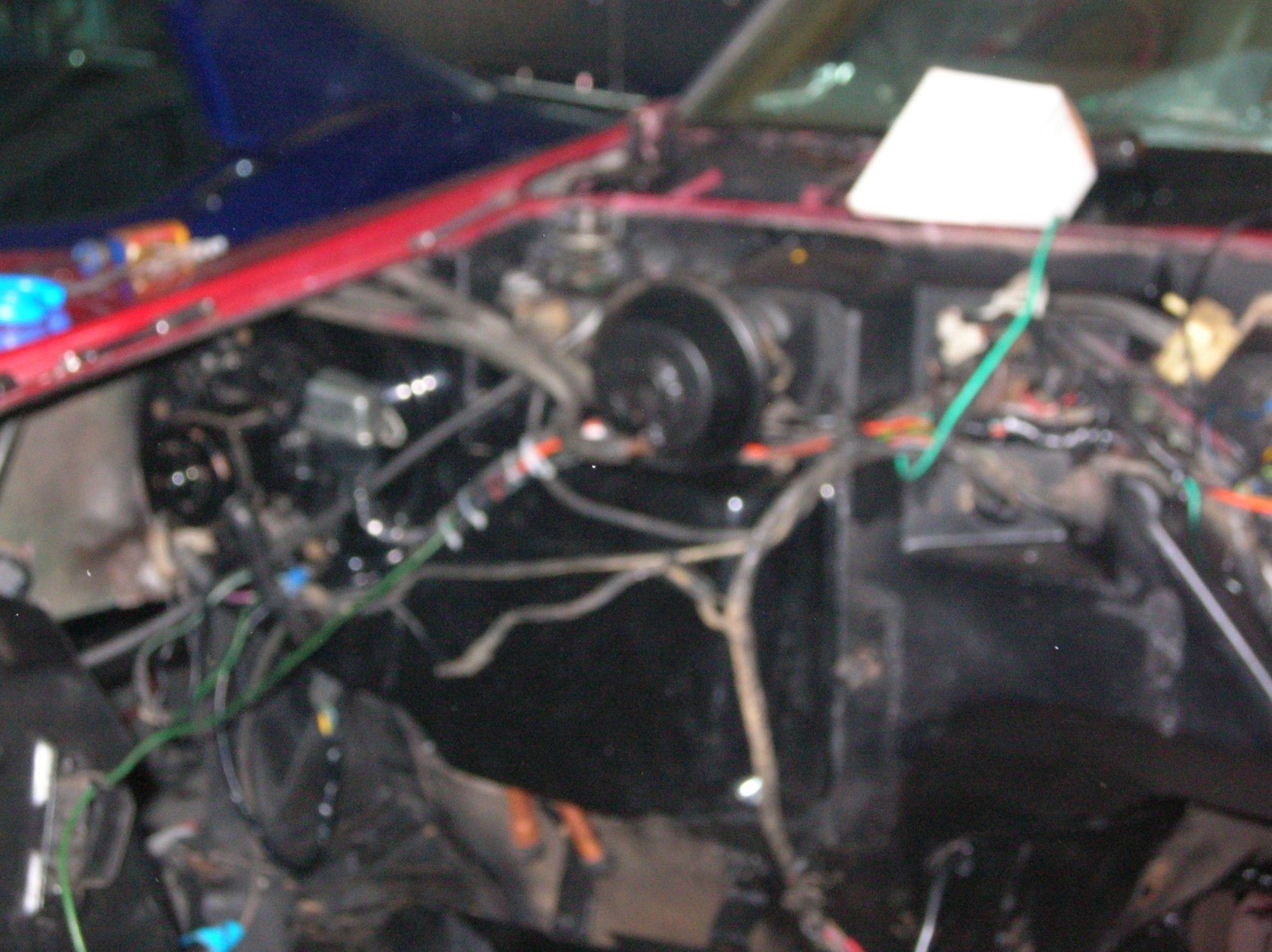

So to day I started and got everything out of the engine bay. It took time and some thinking as this area is totally full of stuff in a engine bay with big block. There is literally no extra room for the box to come out. Had to strip everything before removing the box, taking the box apart witch was the key thing in this work. Here are some pictures of before and after en one during.
