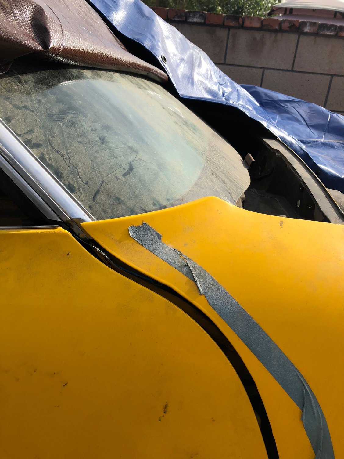

here is why I think it was a bad repair.

I would leave clip on,put body back on and then close the door gap via the VPA trick.From the pic the repair looks like maybe there was a crack/water leak maybe.I dont think its related to the gap

Can you measure the gap between the windscreen and the top of the yellow painted body on both sides (same position) and see if the numbers are close to same?
also agree not to do body work until it's back and shimmed properly on its chassis .

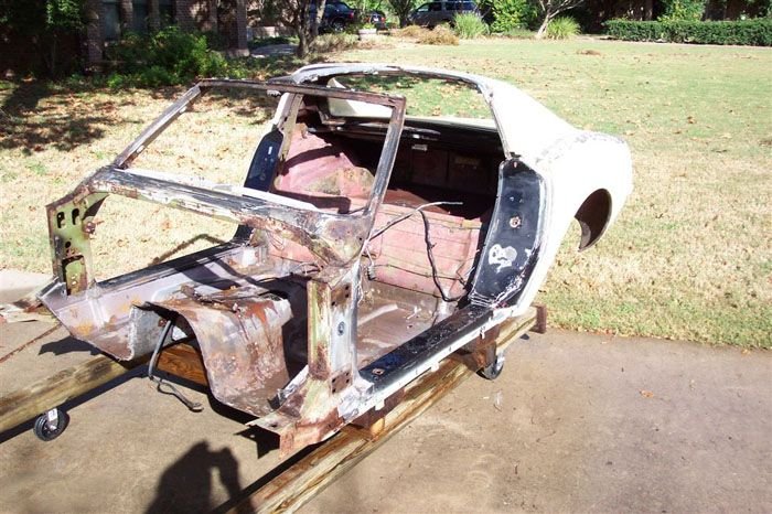

this will be your future. firewall was removed due to separation around the bird cage,
after the front clip was removed, exposing the firewall separation and corrosion.
repaired, reinstalled better than new, corvettes are basically glued together, you heat the seams and separate.
This is my Silver 69 before !

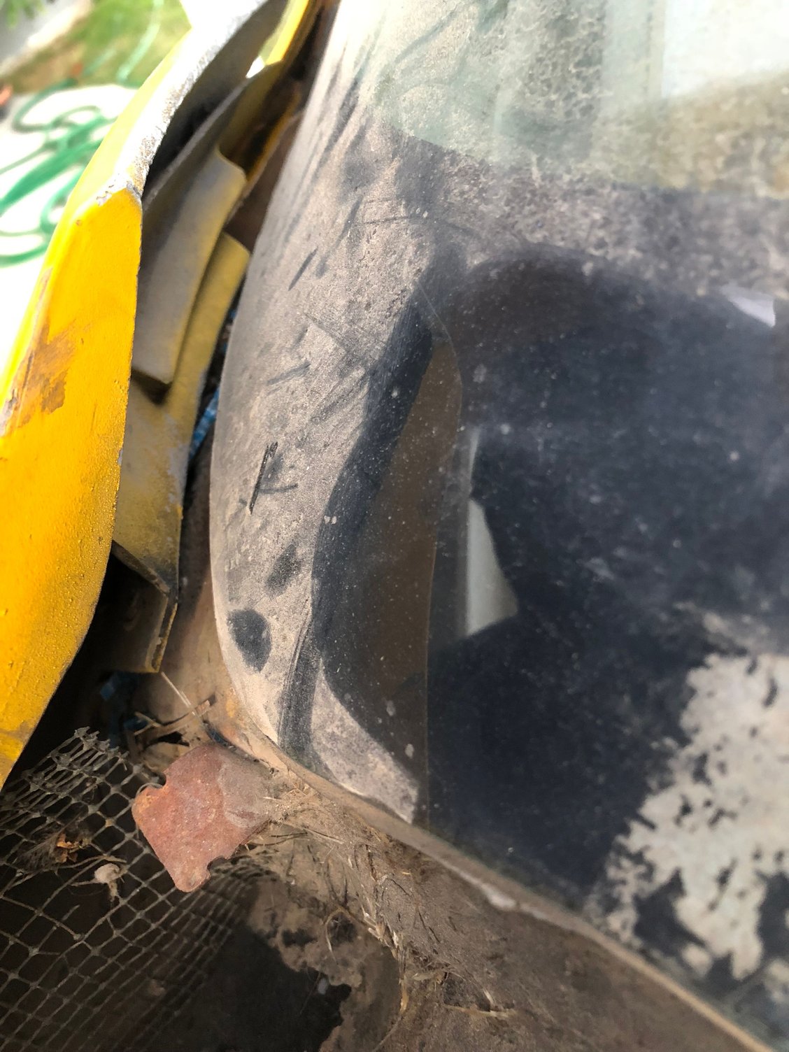

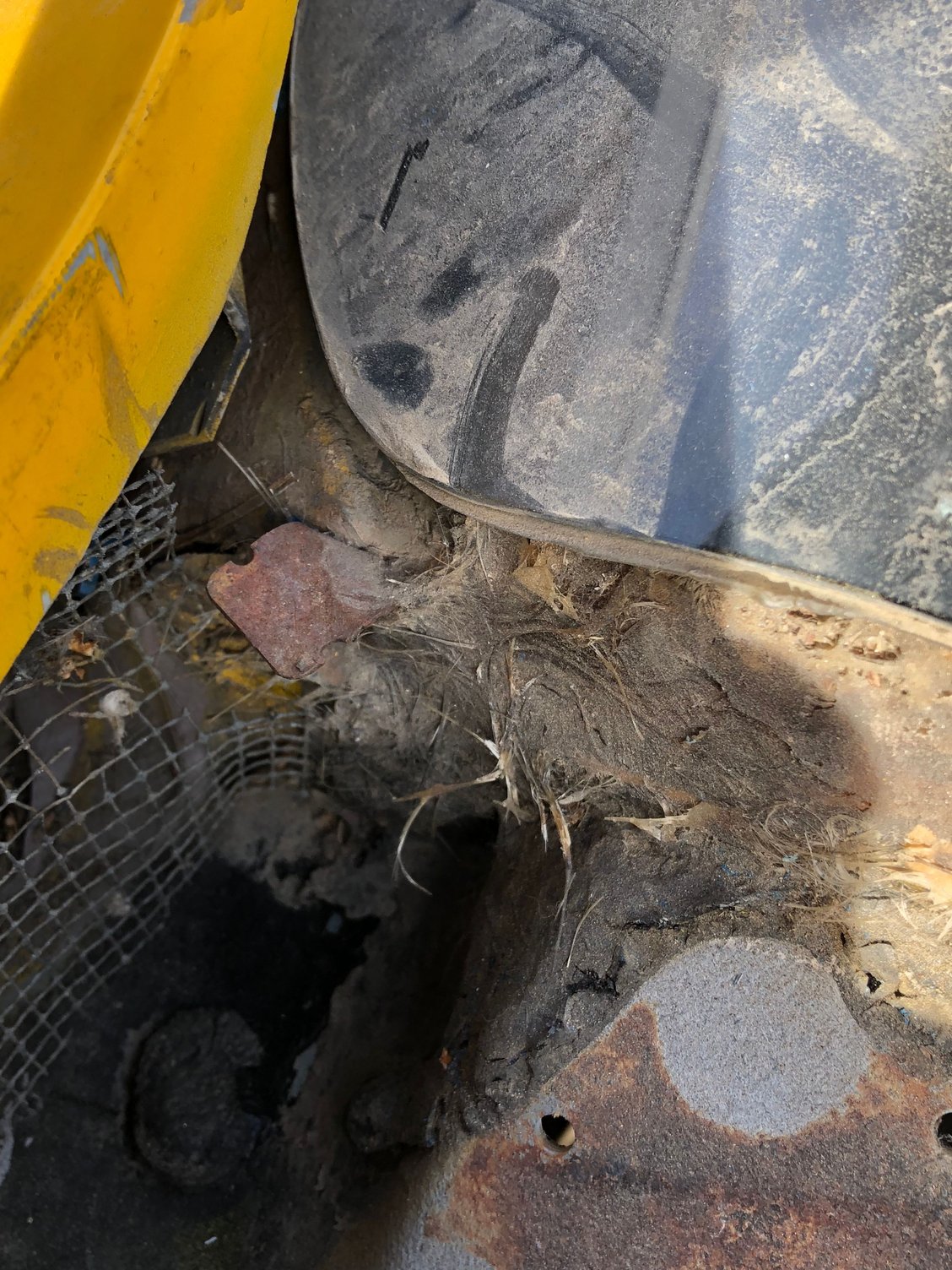

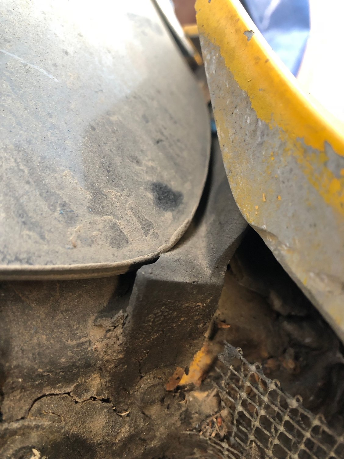

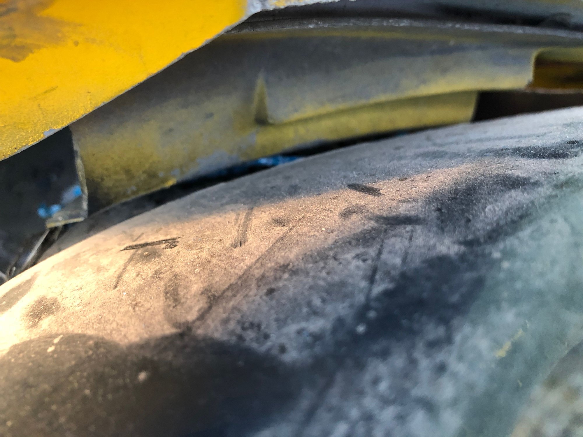

Here are pics of the gussets ( i think). First two show quite a bit of space between the cage and the glass. the next shows the passenger side upper door opening. then the third shows the driver side sitting close and tight.

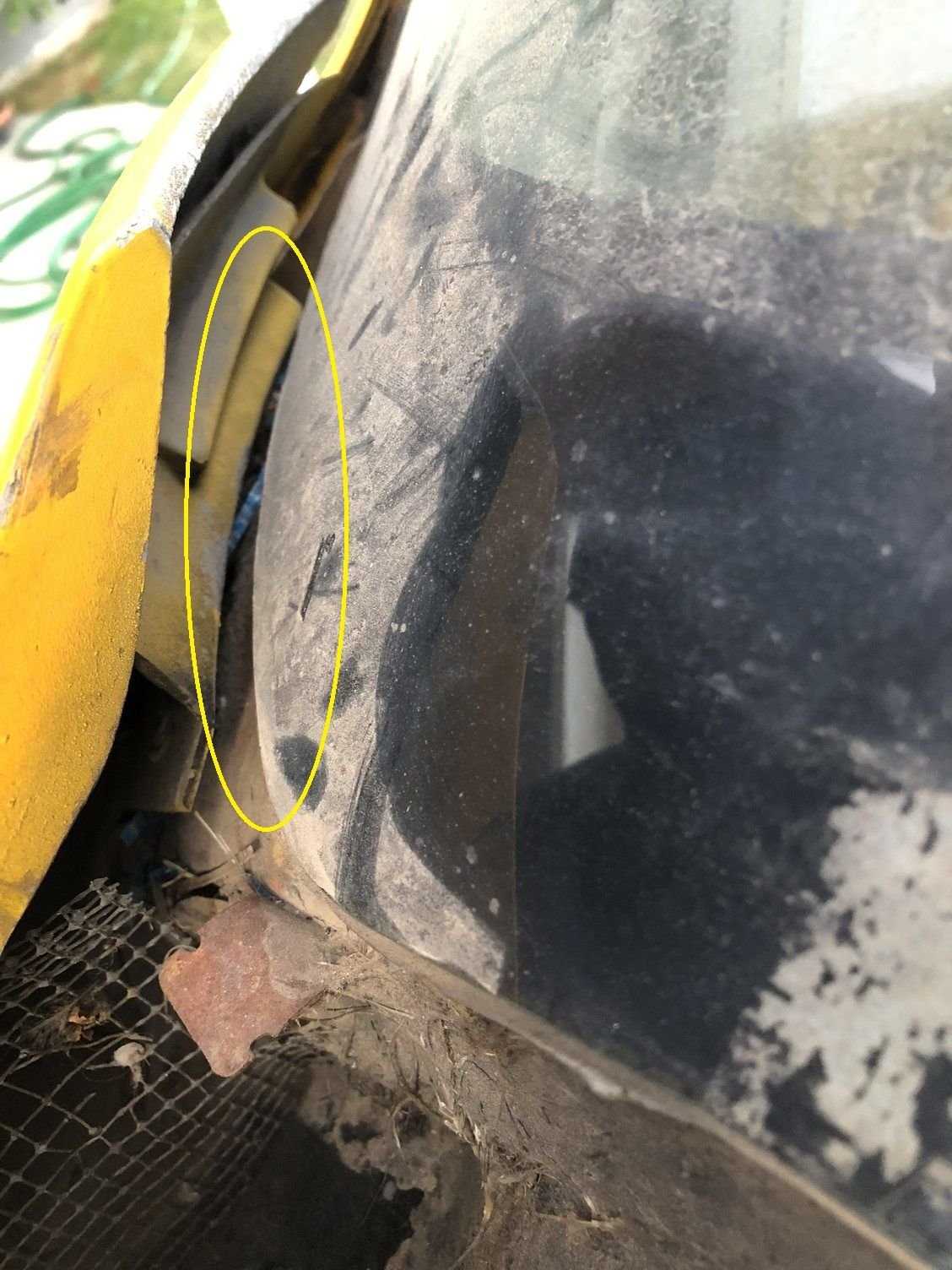

I circled the area that can be separated from the birdcage and IF any old sealant has fallen into this area. It will not be able to close up tight....thus it can effect the top gap of where the top hood surround meets the door area. Also...this area can thus begin to rust due to water can now get between the gusset and the birdcage. like you can see in the photo in the previous post. above

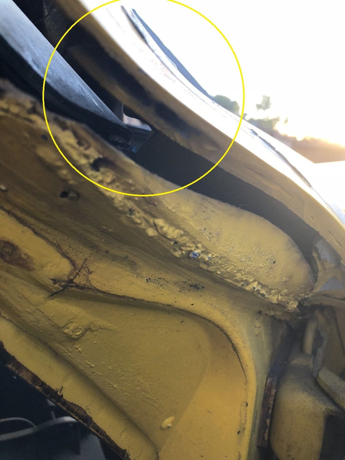

The area where I have circled it in yellow is something I have seen NUMEROUS times and is not a major concern.. Often times this is due to a lack of adhesive when they were building the car and the adhesive just did not ooze out and as long as this area is flush with the door it does not matter. I often times fill in this area just so it is more visually pleasing to the eye when the door is open and people look.

Heres the pic i posted of a close up of the trouble area,
