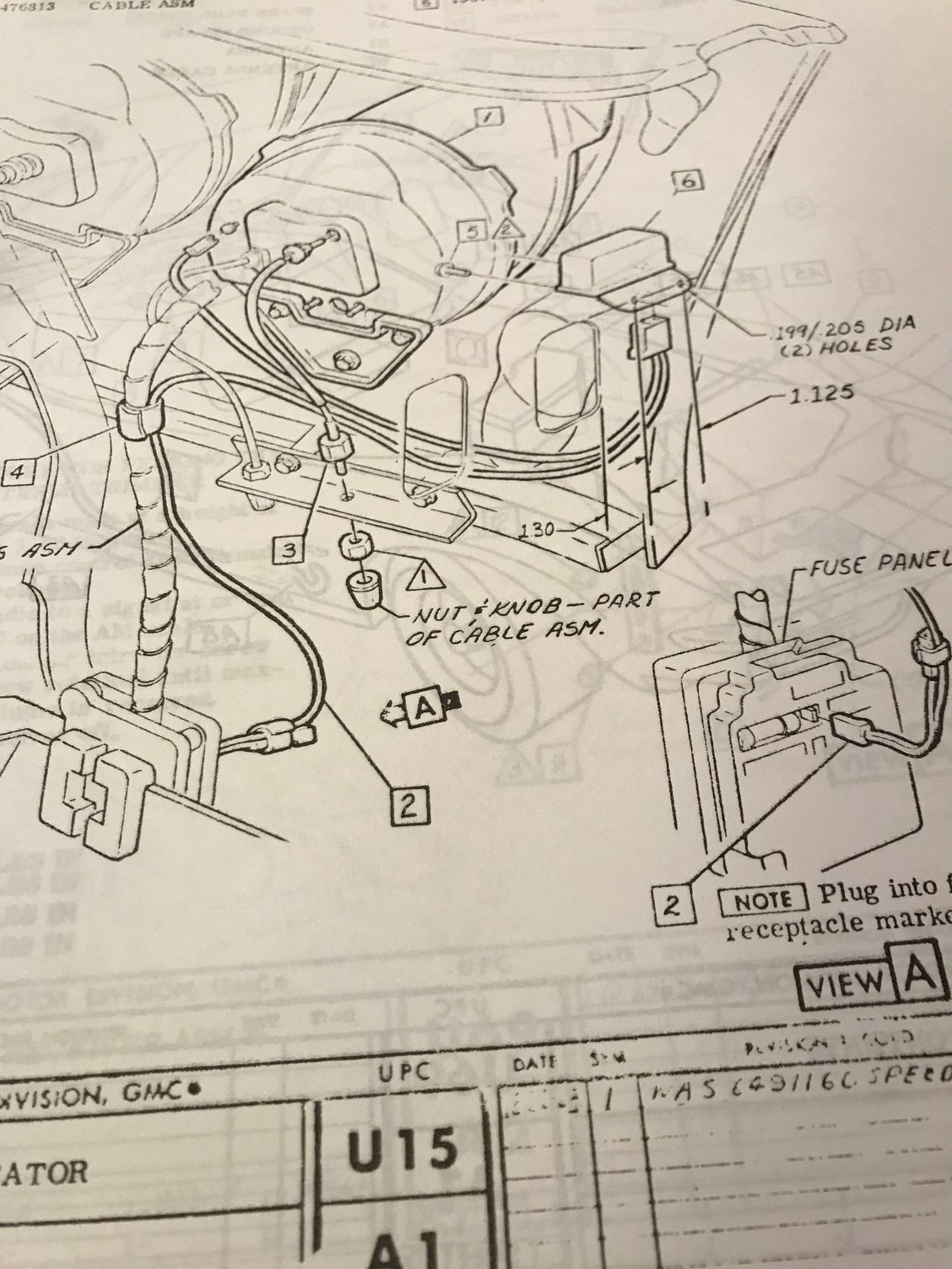

I saw this in the AIM. Putting together the LH dash after many years and was wondering was this on every car or was it an option? Not sure mine ever had it or maybe it did and was removed by a previous owner?
This is a non alarm equipped car.
any help appreciated, thank you
Mark

You found that in the AIM under U15 in the options section in the rear of the manual. That means it was an extra-cost option. So no, not all 69’s had it. And it is not at all related to having an alarm in your car. This is part of the speedo, you set the needle for your chosen max speed, and when you exceed that speed, a buzzer sounds.

It was an option; I had it in one of my ‘69s.
