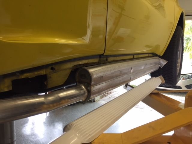

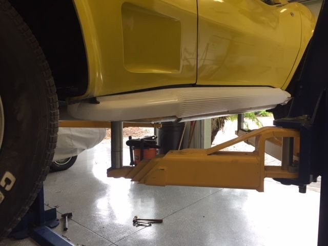

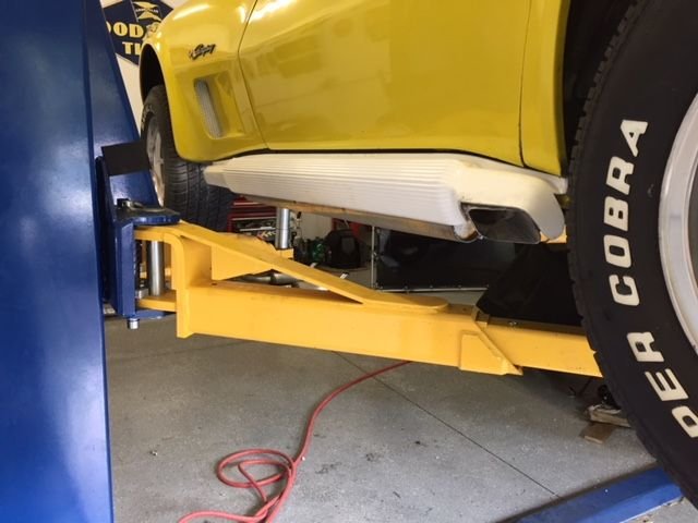

I'm in the midst of installing factory style side pipes on my 76. I got the fiberglass covers and "quiet" pipe kit from Central Corvette and while I am pleased with the quality of the parts, I'm struggling with the fit of the covers. I've got the pipes tucked up as far as they will go and they are within 3/8 of inch from the rocker, but they hang about 2 inches below the covers.
Has anyone out there run into the same issue? Is this common? are their other pipes that would be not as wide and thus not hang so low? I couldn't swing the additional 2 grand for the steel covers and thought these would be a good alternative. It looks very obvious while on my lift, on the ground it's much less noticeable. If this is the best that I can get, then I'll probably paint the mufflers VHT flat black.

Actually the covers look to fit pretty well to me. The mufflers do stick out the bottom some. Much less danger of your leg getting burned down there.

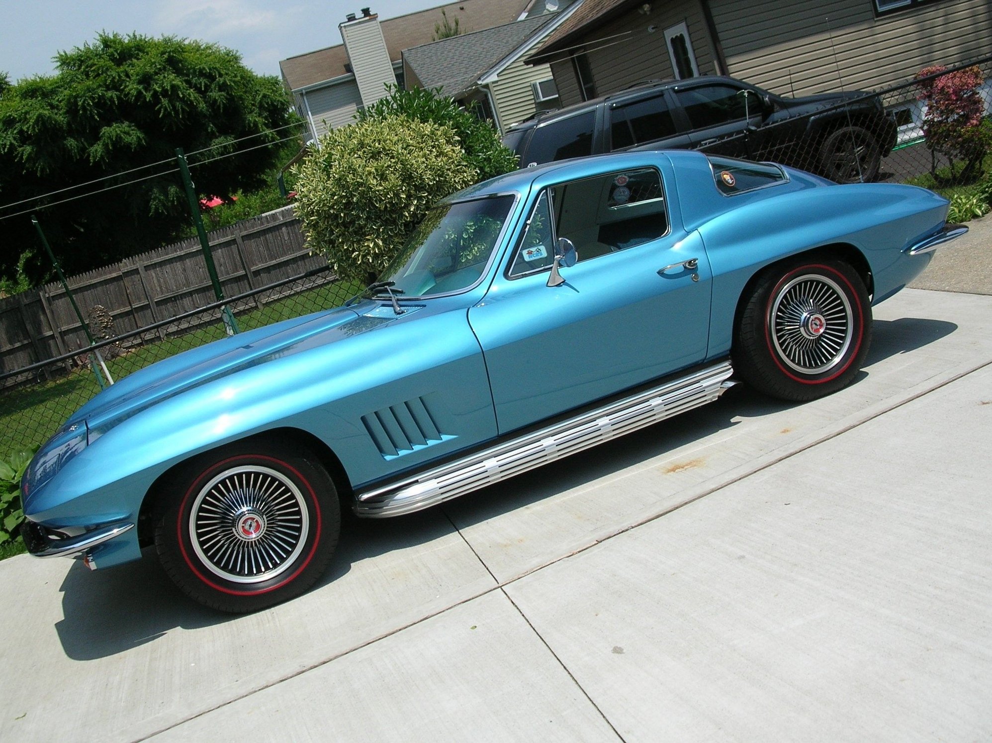

how do you like the quiet pipes. I'm thinking of changing my 67 to quiet pipes.

that looks good. you have to look hard to see it once its on the ground. If it is still a concern get some flat black manifold paint and paint them. The hard part is getting a good fit at the tail pipe which you look to have sorted out

I agree with the above comments. I'm old enough to remember when those side pipes were "current", and to the best of my recollection, the C-3 sidepipes hung that low, even from the factory. The C-2 pipes, being smaller in profile, always were "tucked up" better....

My 67 has factory off road side pipes, basically (glass pack) straight through exhaust - you can't hold a conversation unless you are over 70 mph. Do not drive in the fast lane with a concrete barrier or in stop and go traffic. On long trips it gets old fast. Not looking for stock under car quiet, but less noise than I have now.
