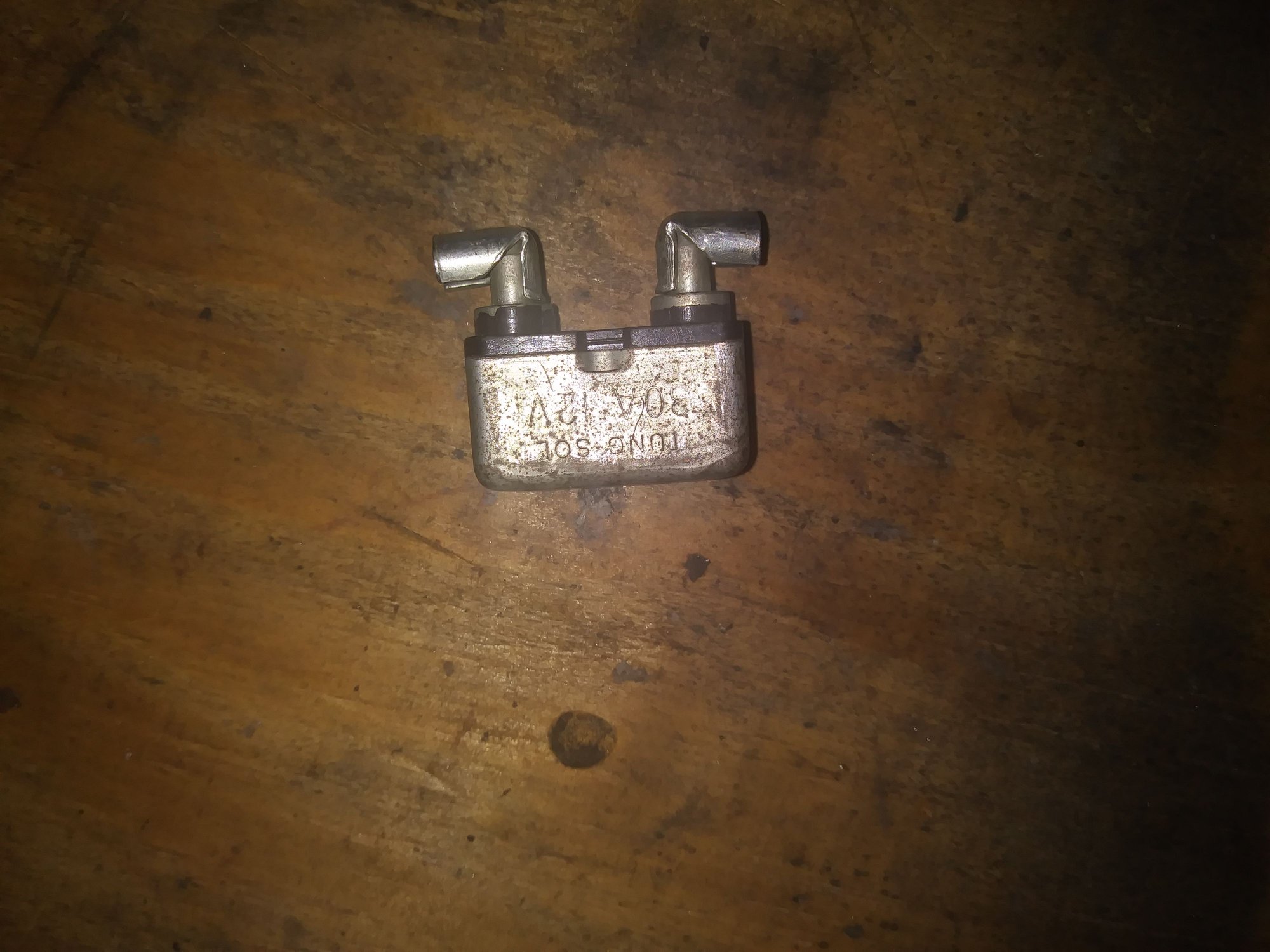

Originally Posted by HeadsU.P.
In your house? Yes, reset. In your car? No, buy another FUSE.
But why is it blowing?
It probably popped when I had the interior out and something shorted. This is what I'm talking about

H-m-m-m-m. 12V & 30 Amp. Long something, Long Sol? Solenoid or a Relay.
You got me.
You got me.
Tung Sol. It's a CB.
What was 30a being used on ?
That style should reset itself, so either the short isnt getting fixed or breaker is bad,
I guess i lean to short still there but run a test meter set to ohms across the breaker see if its closed now that its out and cool.
Tung Sol made mainly blinker relays, but when you think about it, a 30 Amp CB that resets is just a larger, current carrying slow motion blinker. LOL

If it has electrical continuity from one connection point to the other, it may be a unit that resets itself. If no continuity, it won't reset...or it is TOAST....

In the fuse panel left at the top

The power windows didn't work before I changed the CB. With the new one they do. Now everything is working. Thanks people!

Glad you got it working and now knowing you have power windows that did not work before you changed it... YES...there is a 30 amp circuit breaker used for the power windows that goes in the fuse panel.
