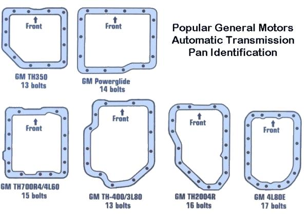

Look at the shape of the pan, it will help you determine which transmission you have.

Yep thanks. I’m positive it’s a 400.
