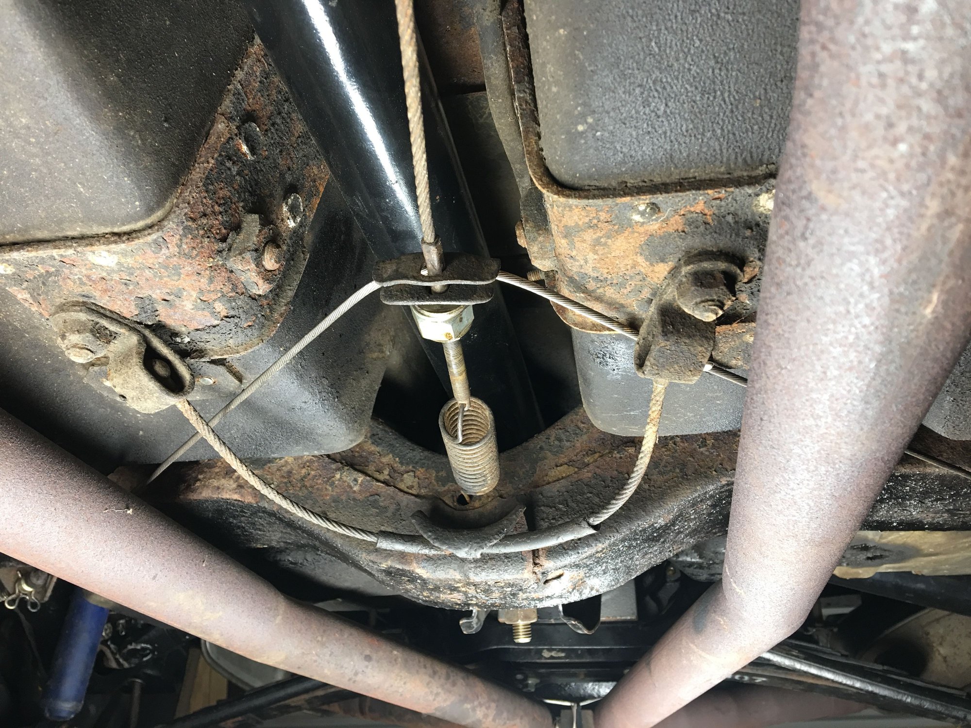

I was under my Dad’s 71 yesterday adjusting the emergency brake cable. Something must be wrong with the setup. I have the cable adjusted as tight as possible and it still isn’t engaging properly. It looks correct according to diagrams I have seen. However, there is a cable looping around the frame not connected to anything that has me confused. It looks like it is part of the setup but I don’t see it in any drawings. TRYING TO UPLOAD AN IMAGE BUT DANG! So awkward.

What is the cable opposite from the e brake loop?

It looks like the cable is positioned much steeper than originally.

That "loop" in the pix is a driveshaft safety loop. Its to contain the driveshaft in the event of a U-Joint failure and keep the car from catapulting into the air. Instead, the cable will harness the spinning shaft and allow it to fling into the soft fiberglass near your ***. But, its the thought that counts.

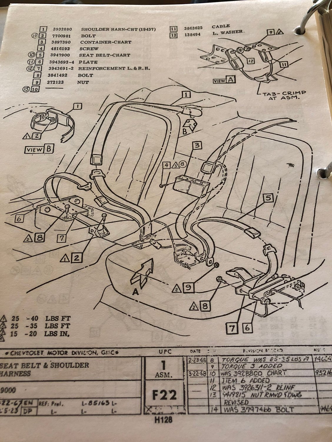

The cable is part of the seat belt assembly as shown in the page from my 68 AIM.

The extra cable is the seat belt restraining cable so they don't pull out of the floor is a crash.

we have all new brakes. The brakes work great. There is some resistance but not enough. Someone added a lug nut in front of the adjusting nut to give it even more tension so I know something is not right. Maybe the cable that goes between the brakes is stretched?
