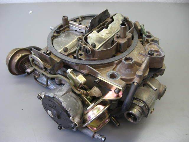

Here are some pics and a bit more info.
http://www.carburetion.com/CarbNumbe...umber=17055038

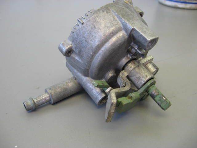

The photo from CU above is not entirely correct in that it does not show the rear vacuum break, which was on this carb number. Here are some pics of one on my workbench right now:
1975 is unique in that it was the only year that Chevy used a rear vacuum break on the passenger car carbs. 1975 also did not have the Adjustable Part Throttle (APT) feature on the power piston. The rear vacuum break was deleted on the Vette carbs and passenger car carbs after the '75 model year, since it is redundant and not needed.

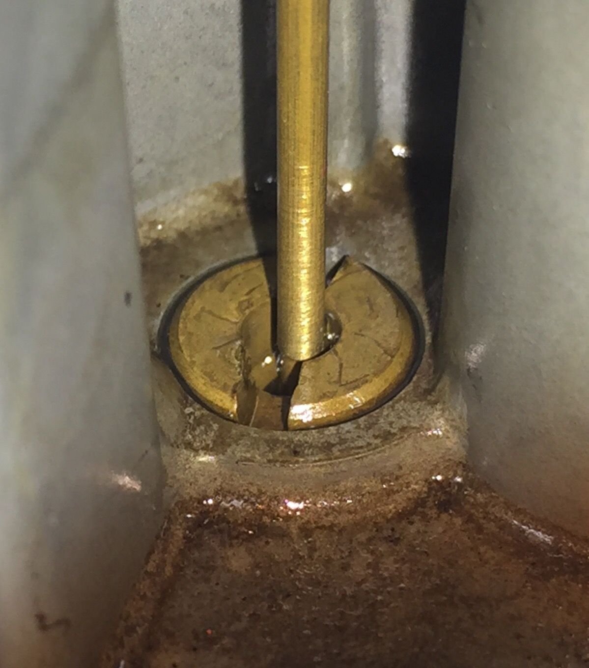

Lars, I have my 17056211 disassembled. Is there a spec for main well bleed tube and secondary accelerating well tube height in relation to the air horn?
This is what I have:
Main well bleed tubes: 1.168"
Secondary accelerating well tubes: 1.228"
Thanks,
Jim
No - there are no specs available for those parameters.

Lars, what do you think of this metering rod depth? You help is greatly appreciated!!
Old Nov 12, 2018 | 10:33 PM
lars's Avatar
lars
Joined: Aug 1999
Posts: 14,380
Likes: 6,391
Looks pretty deep, but impossible to say based on that photo. Set the height up as outlined in my paper: .020 - .030" of the power piston above the retainer lip.

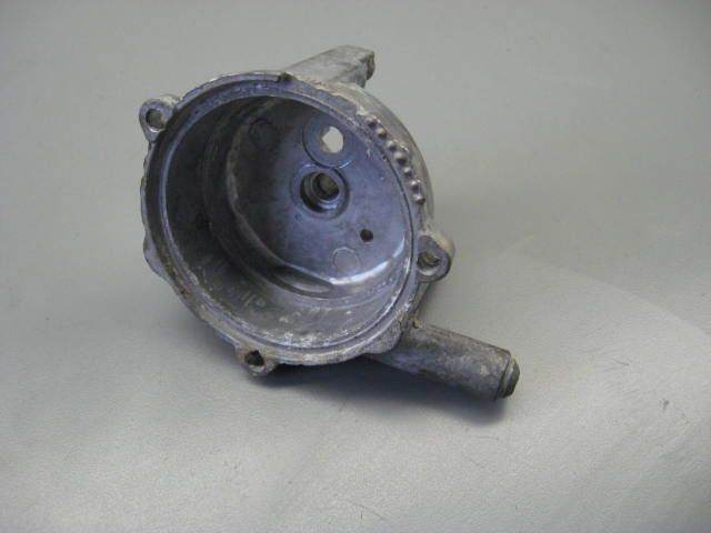

The part number for the choke housing for your carb is 17051917, but this number is not stamped on the housing, so I don't know how you would ever verify it. As long as the housing looks like this you can use it:

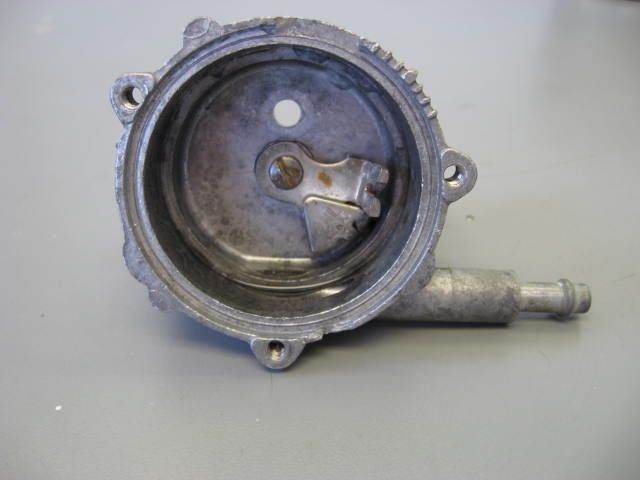

In 1980, Rochester went to the electric choke system, which uses a housing without the hot air bleed provision. You cannot use any housing that looks like this for the electric choke if you plan to use your stock hot air choke system:
