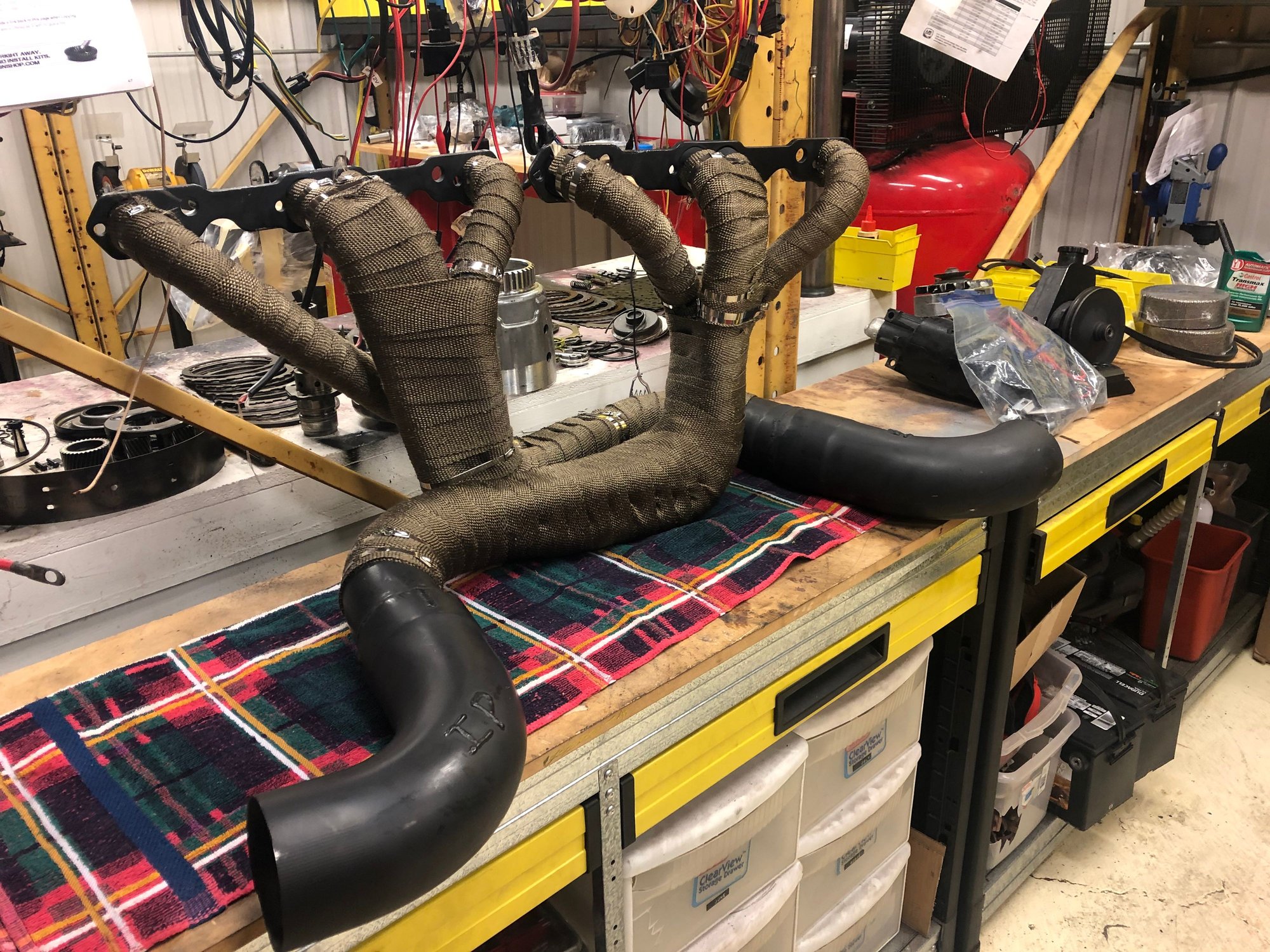

Haven’t been on in awhile with how busy I’ve been, here’s the final product. Will be installed on engine once chaises returns from paint!

pffft... your this close to being done, now for the final step. pull the mufflers outa the side pipes and let that engine breath naturally!!
FYI: your ears will thank you even if your neighbors don't ^.^

im on the fence about the mufflers, I’m one for no exhaust but there conflicting advice and data from some the of engine guys saying we may want the mufflers for a bit of back pressure to help scavenging, then the next experienced guys are saying no need for mufflers as the volume produced from the Cubic inches the small block produces would hinder its ability to breath with mufflers. Plus, I really don’t want to have to deal with police every time I want to go for a drive because it’s “to loud”. However, rules are meant to be broken and nothing beats the noise of pure un-muffled header noise

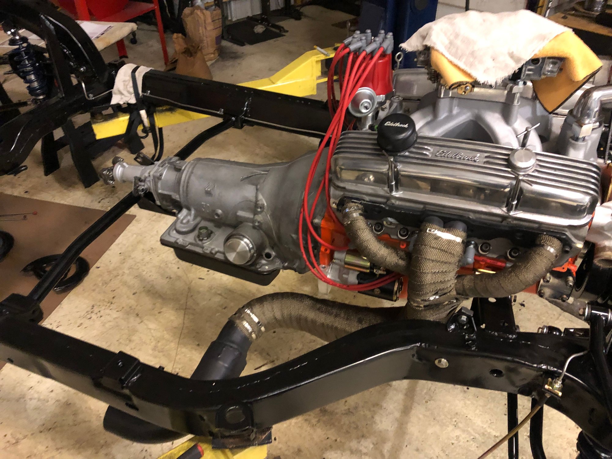

Little quick mock up. Waiting on trans mount and hardware to get in, hence why the pipes aren’t sitting closer to the frame.
