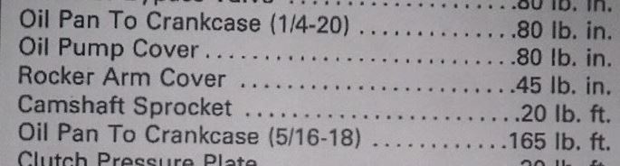

So, my Corvette is leaking oil fairly badly. I've got dye on order and intend to try to clean up and try the talc trick I've read about here. In the meantime, I thought I would check the torque on the pan and any other bolts I can find.
According to the torque specs I found here, the smaller bolts should be 80ftlbs and the larger 165. My torque wrench only goes up to 75 so, I'll have to go get a higher rated one but, tried hand tightening a few. They were awfully loose. My question is if the bolts were that loose, should the gasket be replaced as well or is proper torque enough?

I think you need to read that torque spec again 80 ft lbs and 165ftlbs ???? on little oil pan bolts?? that should be INCH lbs.. you will twist them all off .. also you need to start in the middle and work alternating sides to each end

No, your wrong, and so is that chart.

Nope, I'm 50% wrong. Repeating: "According to the torque specs I found here..." I misread one of the torque specs.

screw vanity ... the table is wrong ...165 foot lb on pan rail is way too much ... heck thats double head bolt tq

that chart is a typo... its inch pounds ..trust me.. its wrong.. you will snap those bolts right off..

chart is right.
far right it says "in"

It says 165 FOOT LBS for end bolts THAT IS NOT RIGHT its a 5/16 grade 5 bolt... it will snap off.. Cylinder head bolts are only 90 Ft Lbs
yes.
wrong

And torque oil pan bolts to proper specs, lol.

FWIW, I have the same chart & numbers in my 1978 Chassis Service Manual.
