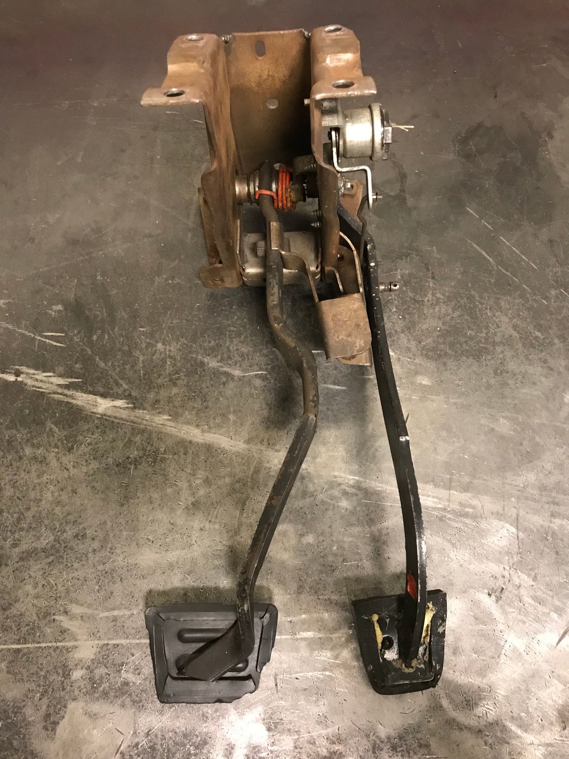

I took out the clutch / brake peddle assembly out today. I was just going to buy a new one... but I think instead my sons and i are going to rebuild it using bearings rather than bushings, change the pads out to something more the race peddle none slip none rubber pad type... should take 2 weeks... as my sons, they do the welding, are finishing finals. 1 week for that, lol...
The question is, has any one else done this? or something like this? it always helps to not have to invent the wheel all over again...

Before:
For the record:-)

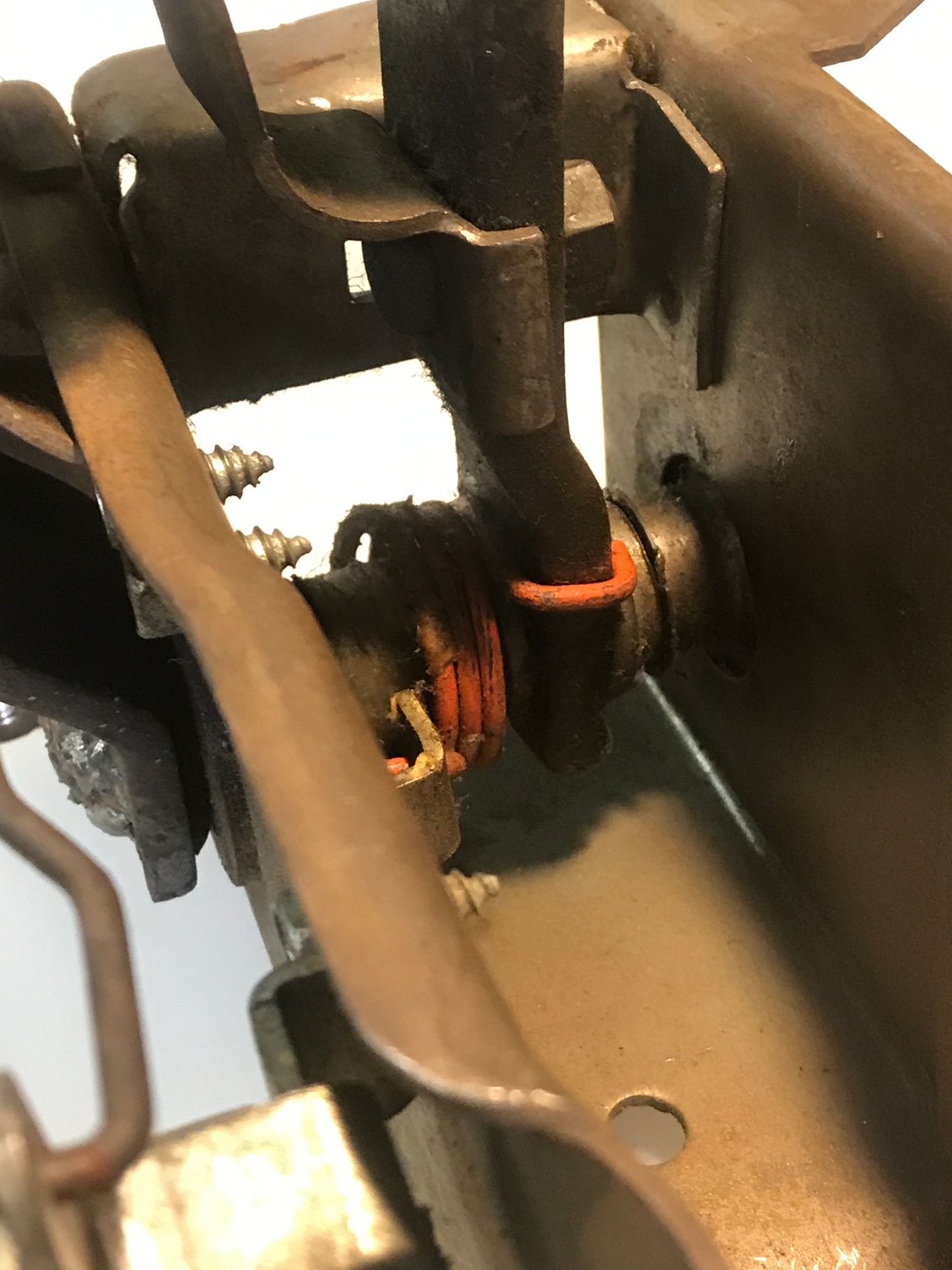

Sounds like a fun project. I will be watching closely. I am cleaning, painting and replacing the bushings etc. on my pedal assembly of my 1976. For what it s worth, be sure to examine closely the weld at the clutch pedal shaft(one that supports the brake pedal) as mine was cracked and caused the pedal to have extra play. Good luck.
Crack visible at upper portion of weld

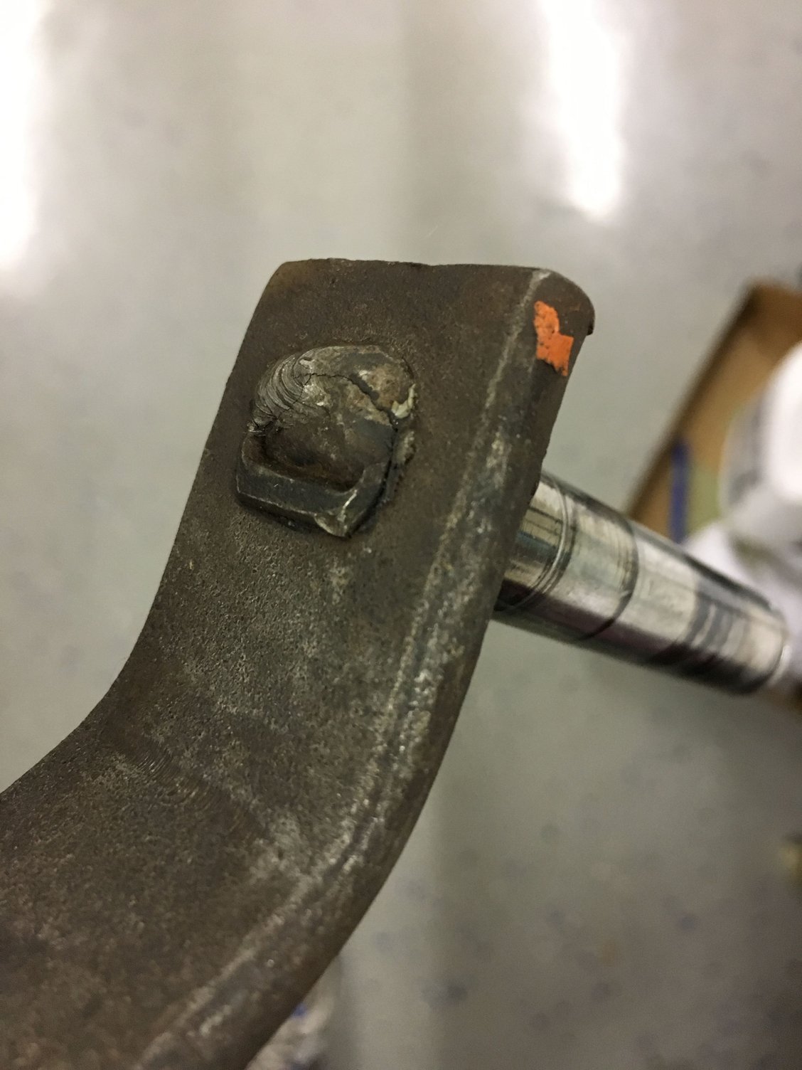

Just be glad you took this out due to the wear on the pin that is attached to your clutch pedal where the clutch push rod goes. The red circle is circling it and the yellow arrow is pointing to the worn area. But I am sure you already know this.

Paul, if you are thinking about needle bearings on the existing pedal pivot shaft, keep in mind that needle bearings need a very hard and smooth shaft surface, especially when it is traveling back and forth over the same small area. The needles will eat into the shaft. I would look more to delrin bushings with a grease zerk. It would still be low friction, would be easy to do and probably outlast you.

If you look at picture #3 I posted, it showed a crack in the mettle holding the pivot rod. I plan on replacing that with a bearing.. the bearing will have its own race, and the rod will be made to fit directly into that race...
As far as the cracks worn mettle and so on,,, yea, I know... total rework..

In the photo below if that is the crack you are commenting on. I have seen them do this and I have used a thick walled washer that I reamed out to slip fit over the end of the collar after I tapped it back together and welded it on to give it much more support so it can not split.
DUB.
yep, and that is where the bearings will be put.
