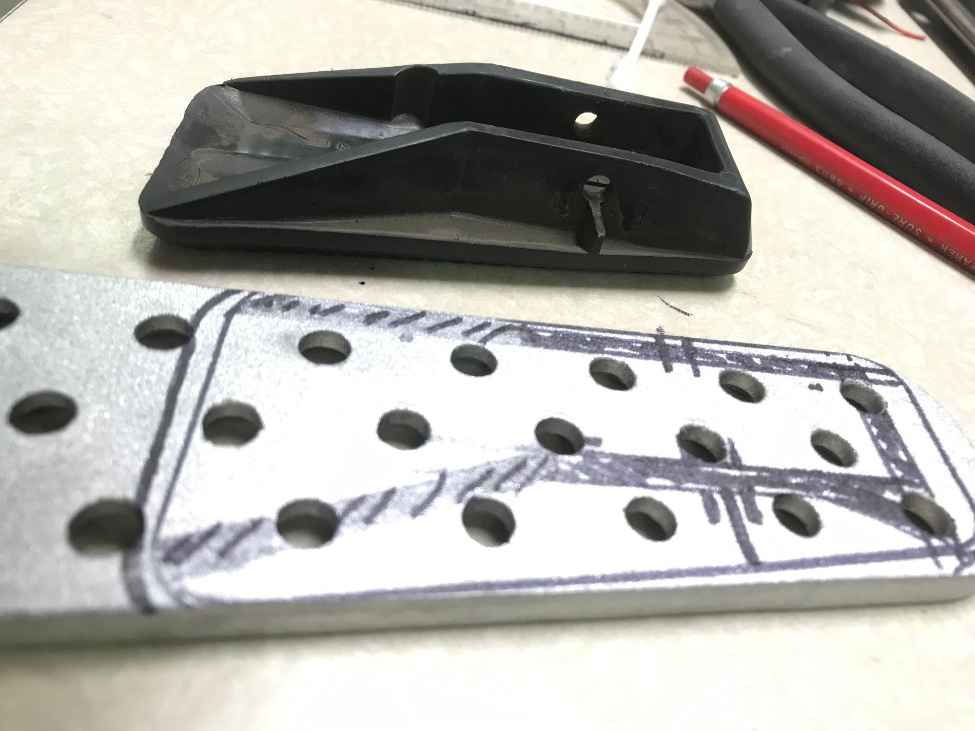

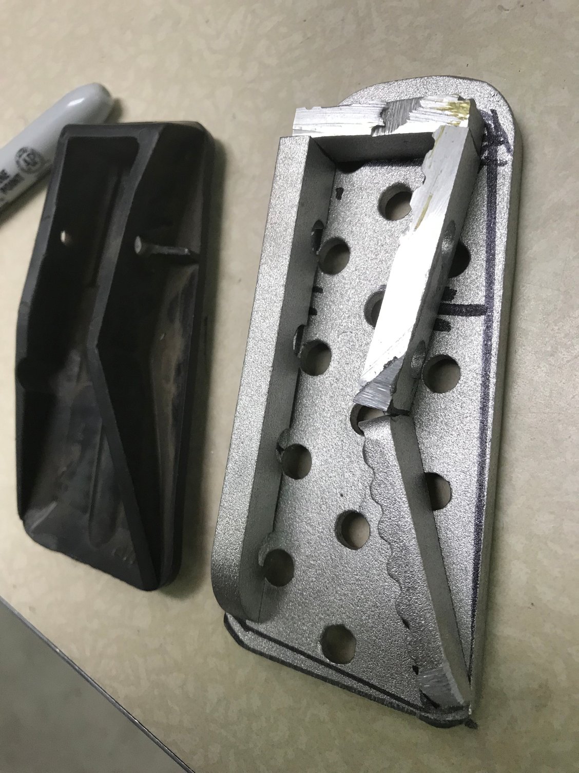

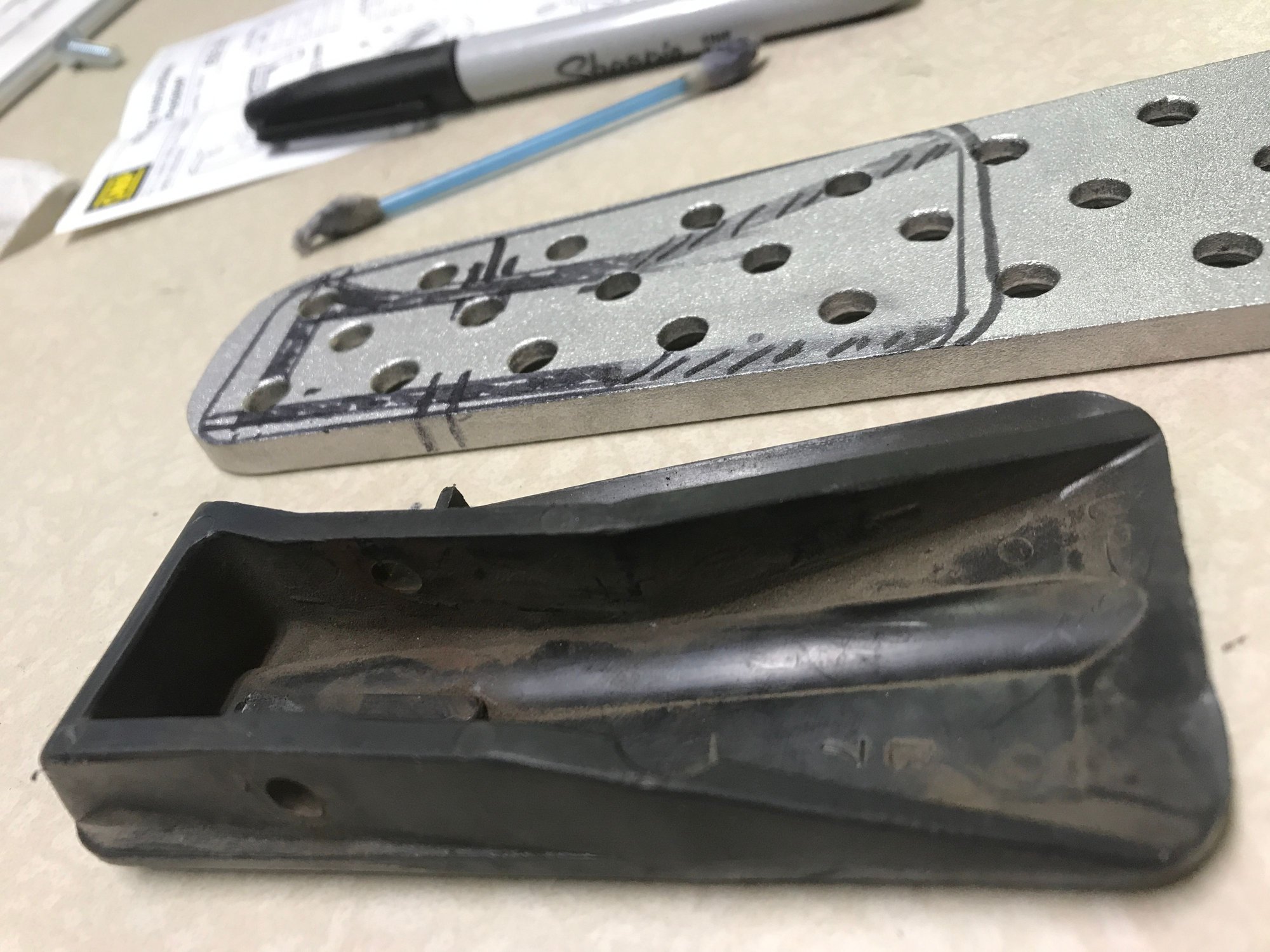

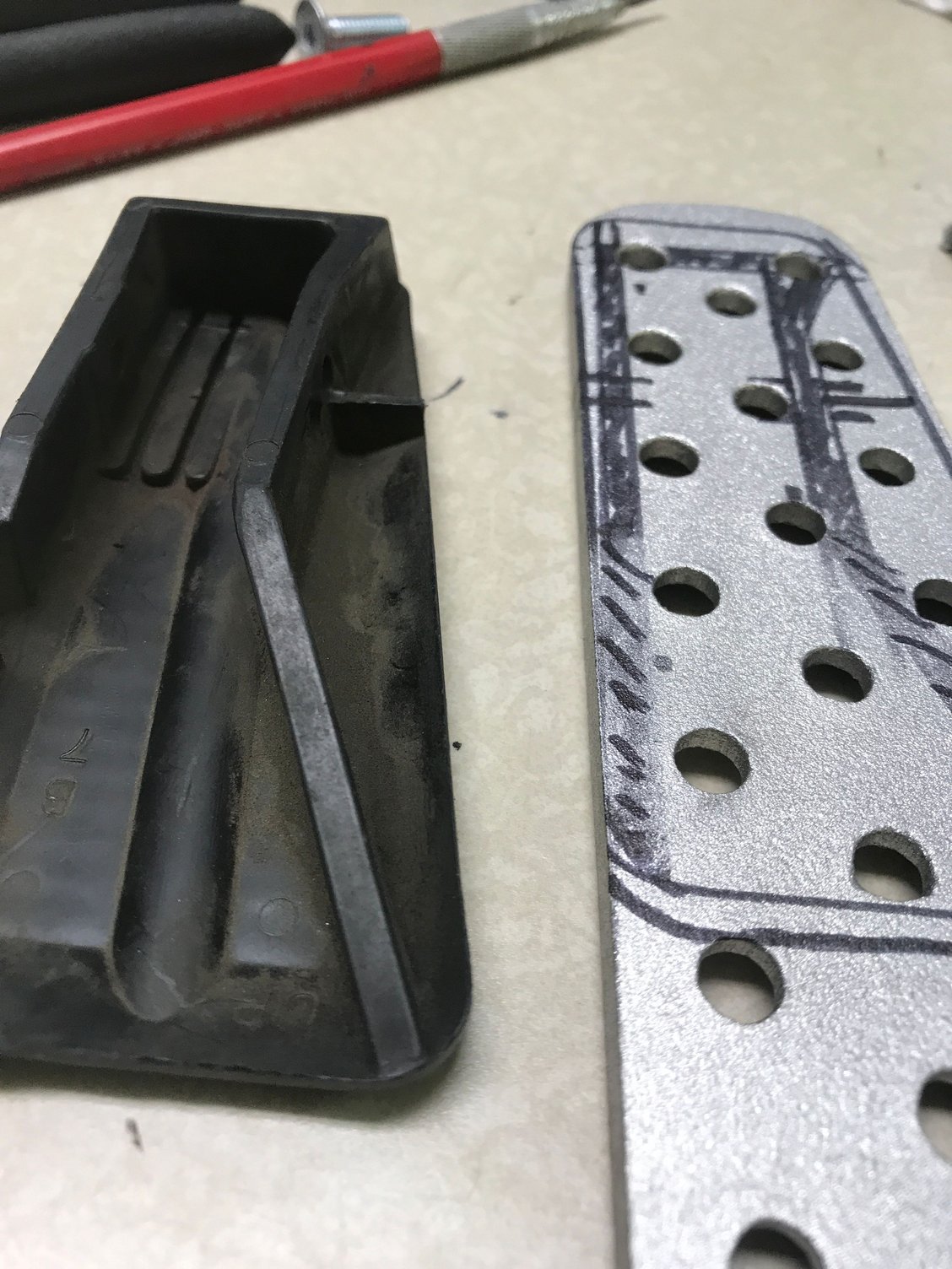

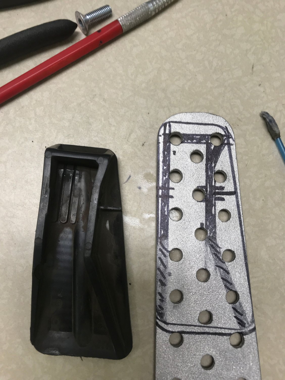

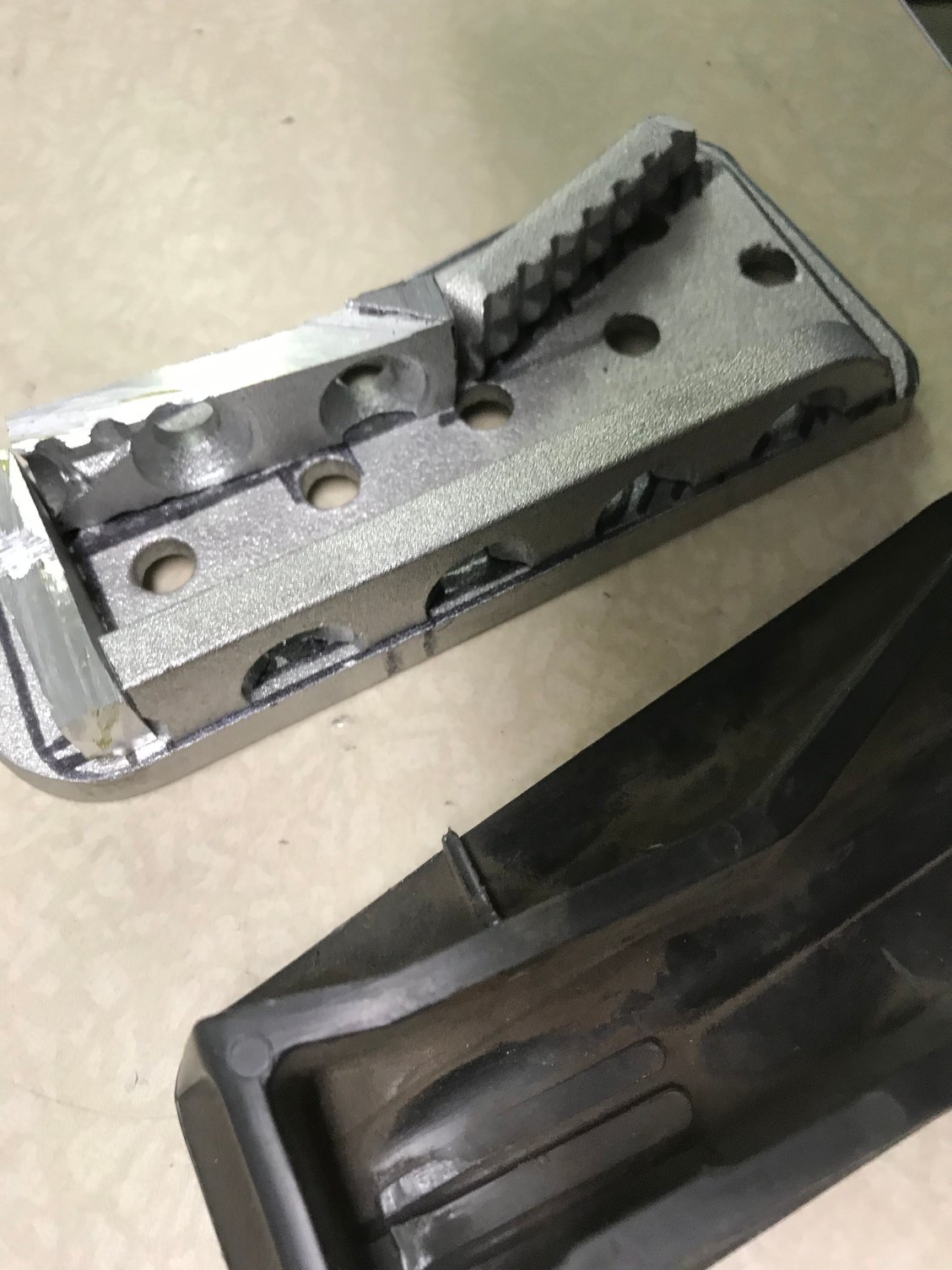

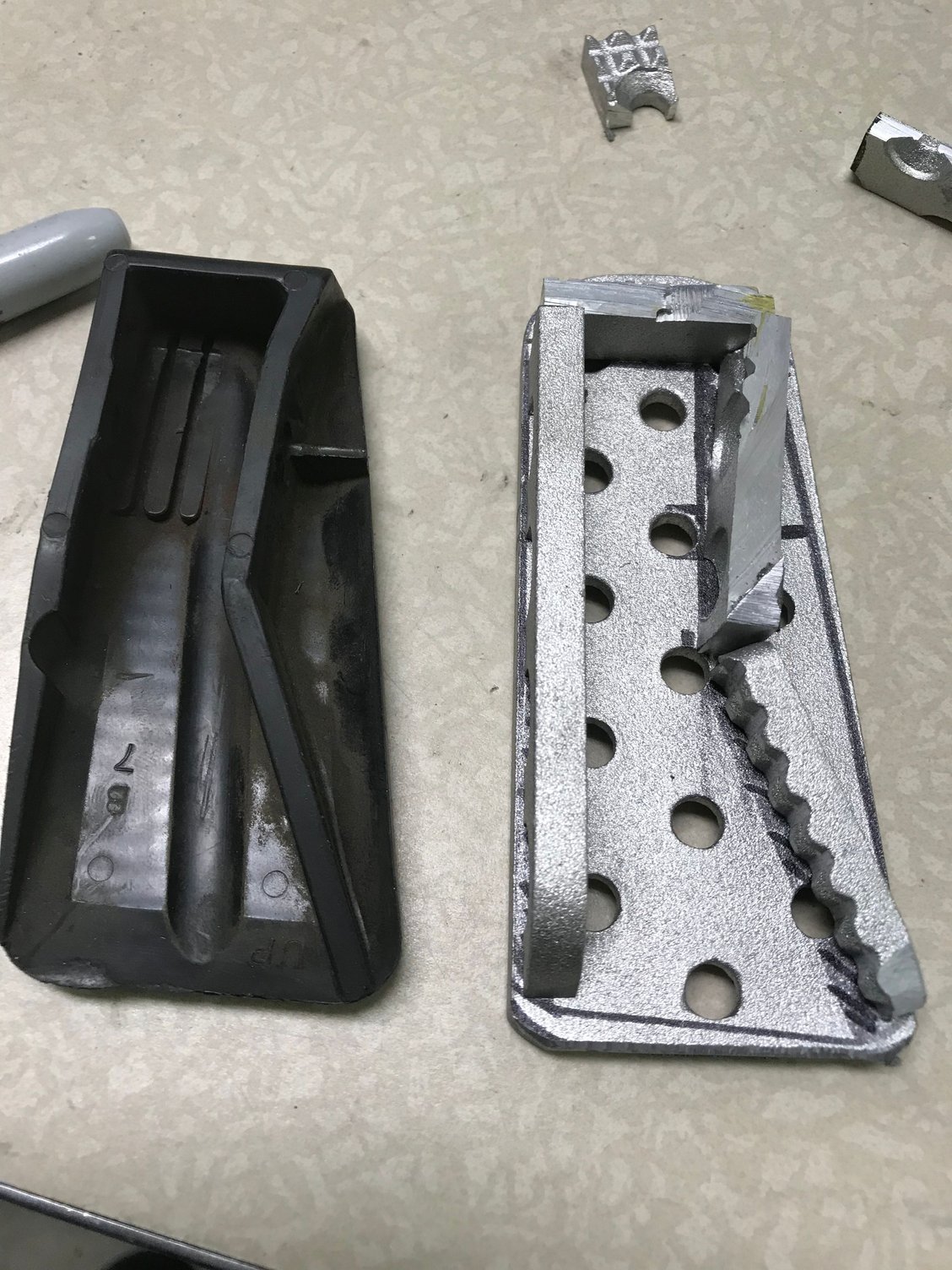

Working on the peddle. Got the pieces cut, will tig the mettle together tomorrow
then grind it all nice and level, then brush sand it to clean it up and make it look
pretty underneath:-)

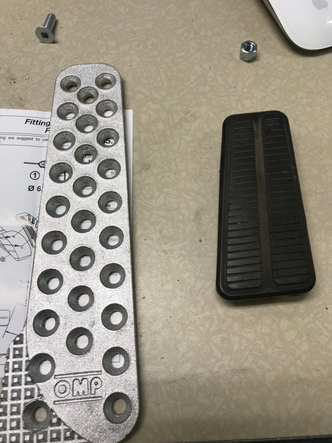

Gas peddle done....
That was a bitch... will try and post some pictures tonight...
if you do this, make sure you do an exact measurement of almost everything on the back of the peddle. it uses a spring on the back... and it will not function properly unless built correctly and an exact match.
