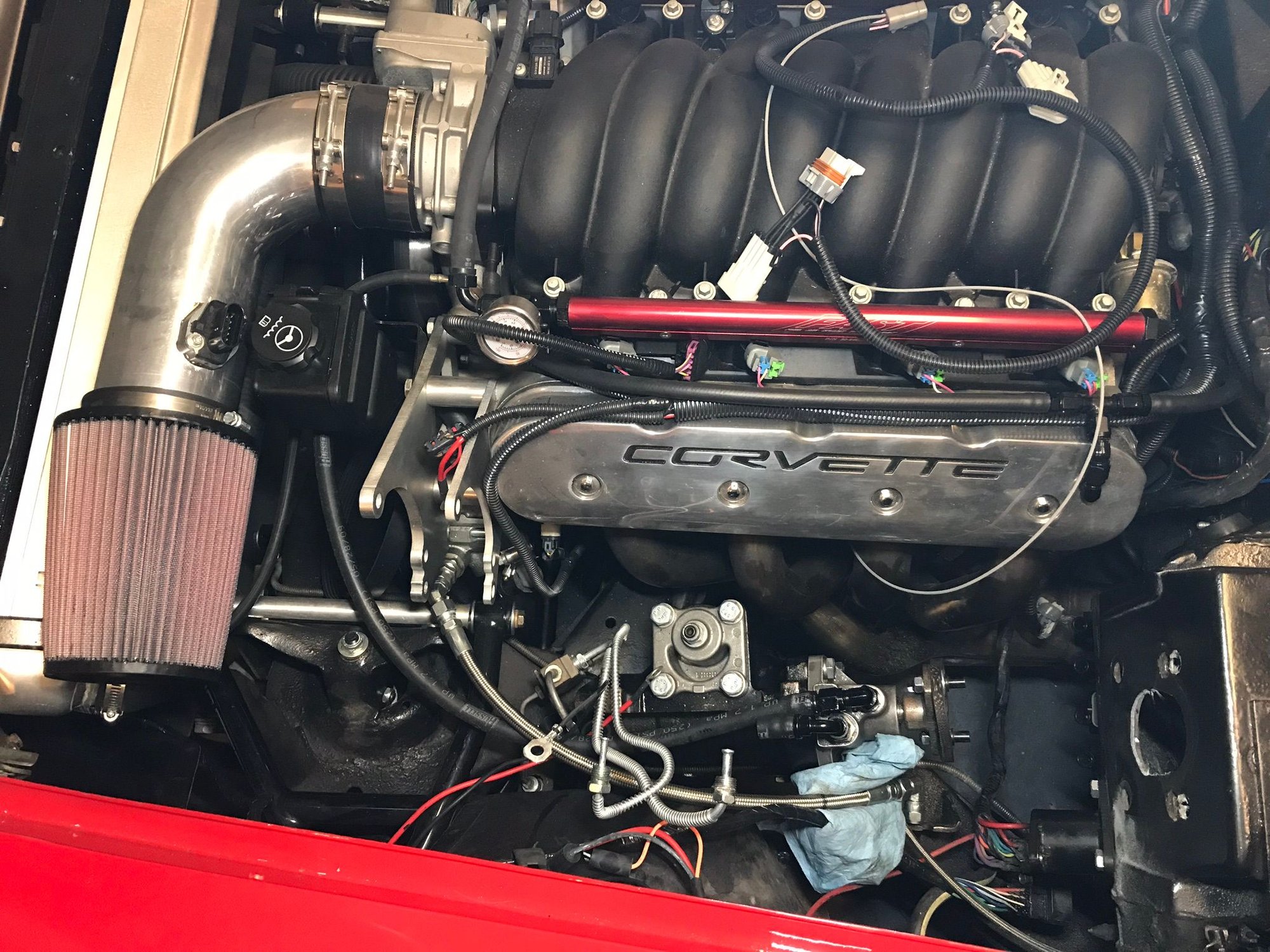

Just an update on my 72. I know this has been a long time project since I put the LS in and it seems to just sit there. Well after a divorce and now remarried, A Cobra build, rebuilding my beach house and many other friends Corvette projects I have the drive to get this back roadworthy. It was running but not road worthy. I decided this winter to do some updates and other things that have been in the back of my mind. First the garage shot, wow I have to organize some things a little better. After that you will see I have removed the Hydroboost and the clutch MC and some other things underneath you can't see. I will replace it with a correct size MC and a vacuum booster for many reasons on this. The clutch throw was way to short and was difficult to use, the clutch was very touchy. Either in or out. Needed a longer travel. Going with a 5/8 bore instead of 3/4. The brakes and some will disagree I never liked the overall feel of the hydroboost. Not linear enough. After driving the Cobra with manual brakes and oversized rotors and brakes I like that feel. Now also the Corvette will be more of the cruising car, the race car is next to it. Not that the Vette won't be driven hard just need a good feeling set of brakes. So going back to a vacuum set up. Now this car originally had manual brakes and I kept the manual pedal box so I also have now swaped out to a power pedal box which is one of the reasons you see nothing in the drivers foot box. I will have to make one new hose to convert the Borgeson box to just a PS setup. The pressure hose has to be shortened. I can use the return line. BTW the Hydroboost unit will be for sale if anyone is interested, probably no lines though. In the interior I am replacing the 46 year old wiring harness for safety sake. I eliminated all the unneeded wires. I actually am using a 73 harness since someone here on the forum was selling a brand new harness for a big discount. I no longer have any vacuum headlights or wipers so I don't need any of that in the harness. I am making it so I can just unplug 4 plugs and remove the dash pad and gauge pod. All the gauges are now electronic and I am using a GPS speedo since it works so well in the Cobra. Lots of other small updates and things you will never see Just cleaning up a lot of small details. Power antenna and an updated radio and the VA system will be a nice update. Then I have to bring the car in to get the computer tuned. As I said it runs but poorly. I am expecting around 500 Hp from the LS3 so with the T56 it should be a fun ride but not as brutal as the Cobra.

I have plenty of adjustment with the adjustable rod. The problem is for every inch of travel so much volume is pushed down to the TO bearing moving it so far. I need less volume of fluid for every bit of movement from the pedal.

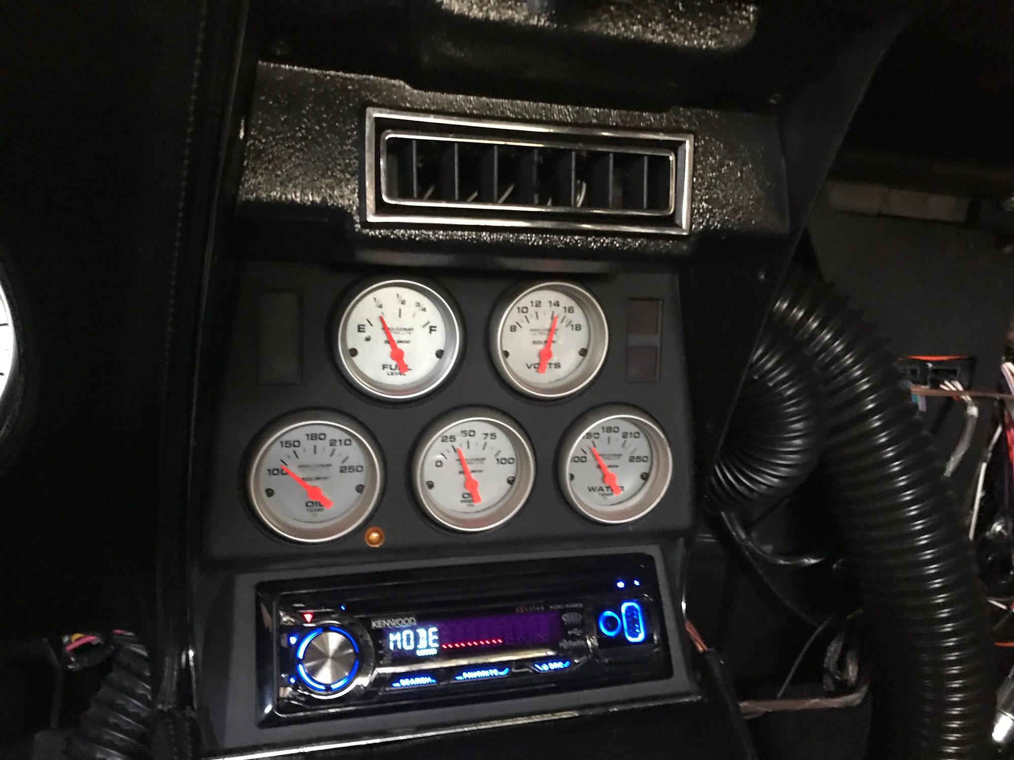

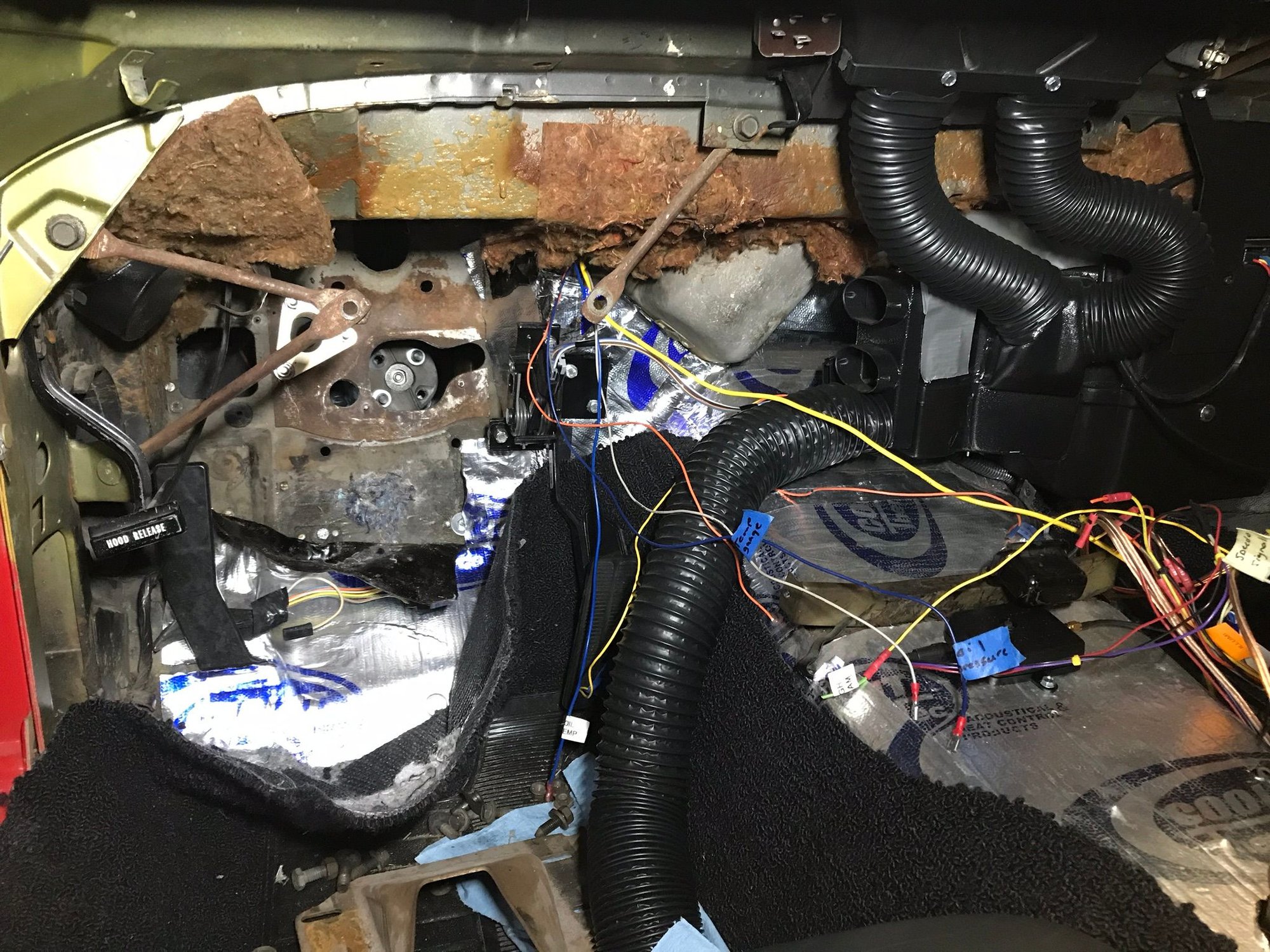

It’s coming along now. I have the dash mostly back in. The Vintage Air tubing is a royal PIA to get in and routed. Not much room in a C3. Also have the PB brakes back in and the new clutch MC installed. I fired it up and let it run for a few minutes also and the tune is pretty bad. I have to take it and get that sorted out. Once warm it barely takes throttle. To rich running. I have a short video of it running but it won’t load right now.

Motor picture. Don’t know why the double post of pictures above.

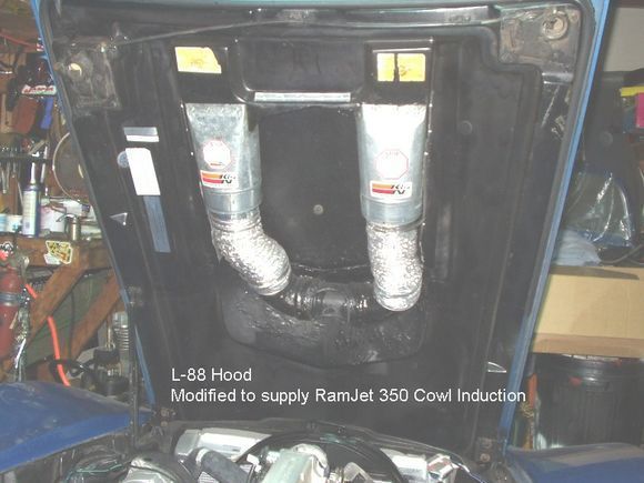

[QUOTE=Gordonm;1598500498]Yea yea. That is another project I'm looking at also. They really like the cooler air
You can try coming in via the L-88 hood. That's what I did with my RamJet 350.
