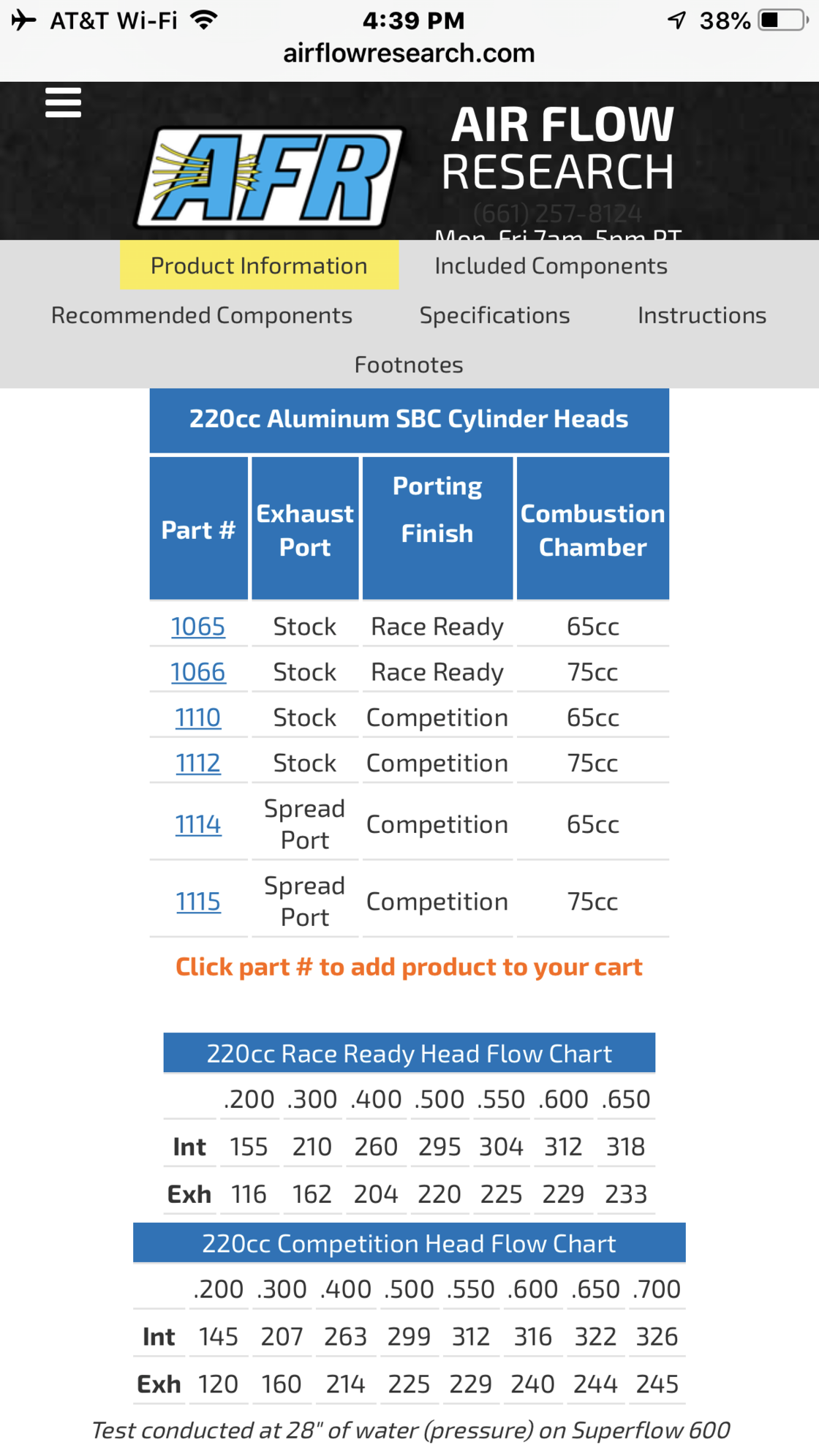

George is 100% correct about your heads being too small also your Cam doesn’t have enough lift.. there’s no way in the world you’re gonna make that power with thoes heads and cam

pauldana's Avatar
pauldana
Joined: May 2003
Posts: 10,956
Likes: 409
From: California
Old Jan 5, 2019 | 09:42 PM
pauldana's Avatar
pauldana
Joined: May 2003
Posts: 10,956
Likes: 409
From: California
I run the 220 competition ported heads with close to the .65 lift for 322 flow..
427. 11.2:1 compression
650hp

I made all my comments based on the original post about 180cc heads
to the poster, please buy a very efficient 9.5 inch covertor. I used a 3500 with 4.11
as head flow goes up less cam is needed to make the same amount of power
