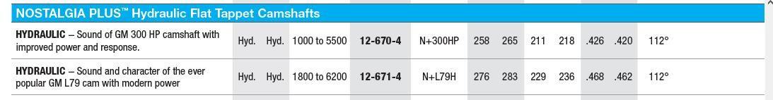

I'd suggest a stone stock 300HP cam, but the Nostalgia Plus from Comp cams. It's a little better than the original, and has nice mild lobe ramps for long life.
Alternatively you could run the larger L-79 cam, but it would only help over 4000 rpm, and I don't know if you would even notice below that. Your 9.5 CR should result pretty close to the original 300 or 350 hp power output, but they are basically the same below 4000, but you will definately feel it at 5500.

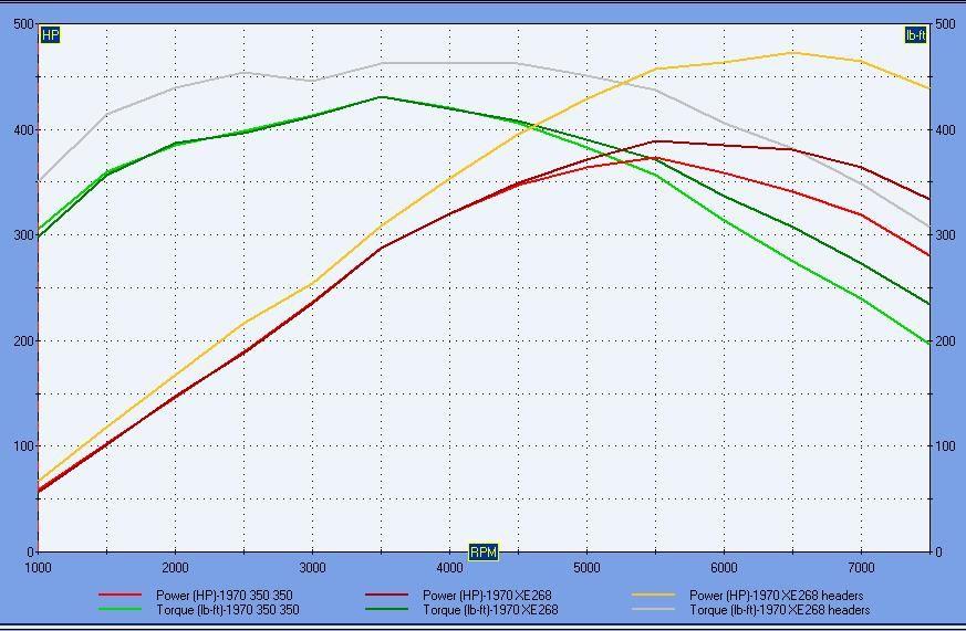

Your car with 8.5 CR will be soggy, and the mentioned 71 even with a better cam had the same and was also soft, especially with 3:08 or 3:36 gears.
The 300HP cam with 9.5CR will be a torque monster, and have a dead smooth idle. I had that exact engine, trans & gear setup in my 68 SS350 Camaro and it ran fabulous. 100% stock.
The L-79 cam is a decent bump up mostly upstairs, it also has a little bit more noticeable idle, but good vacuum.
The XE268 cam I also love. It may only give you another 10HP with stock manifolds. The rpm peak starts to move upstairs some more. And the much tighter lobe center makes it sound pretty good&nasty, but it does retain power brakes etc. Ran it, loved it. . However the almost 6000 rpm peak of it may be starting to move outside of the rev range you mentioned. And it would really like some more gear, headers, etc. Then it would really come alive, like the 70 Nova mentioned. In my Z28 it ran mid 13s with 3:55s, and headers, etc. Any more cam than that and you would really require more compression, gears, headers, etc.
It all depends how much you want to spend....AJ and I both love HP, but I am tempering my recommendations a lil more because you said cruiser and <5500.
Note that I don't necessarily believe the power ratings this software puts out, but it is excellent for making cam comparisons like you are doing here.
