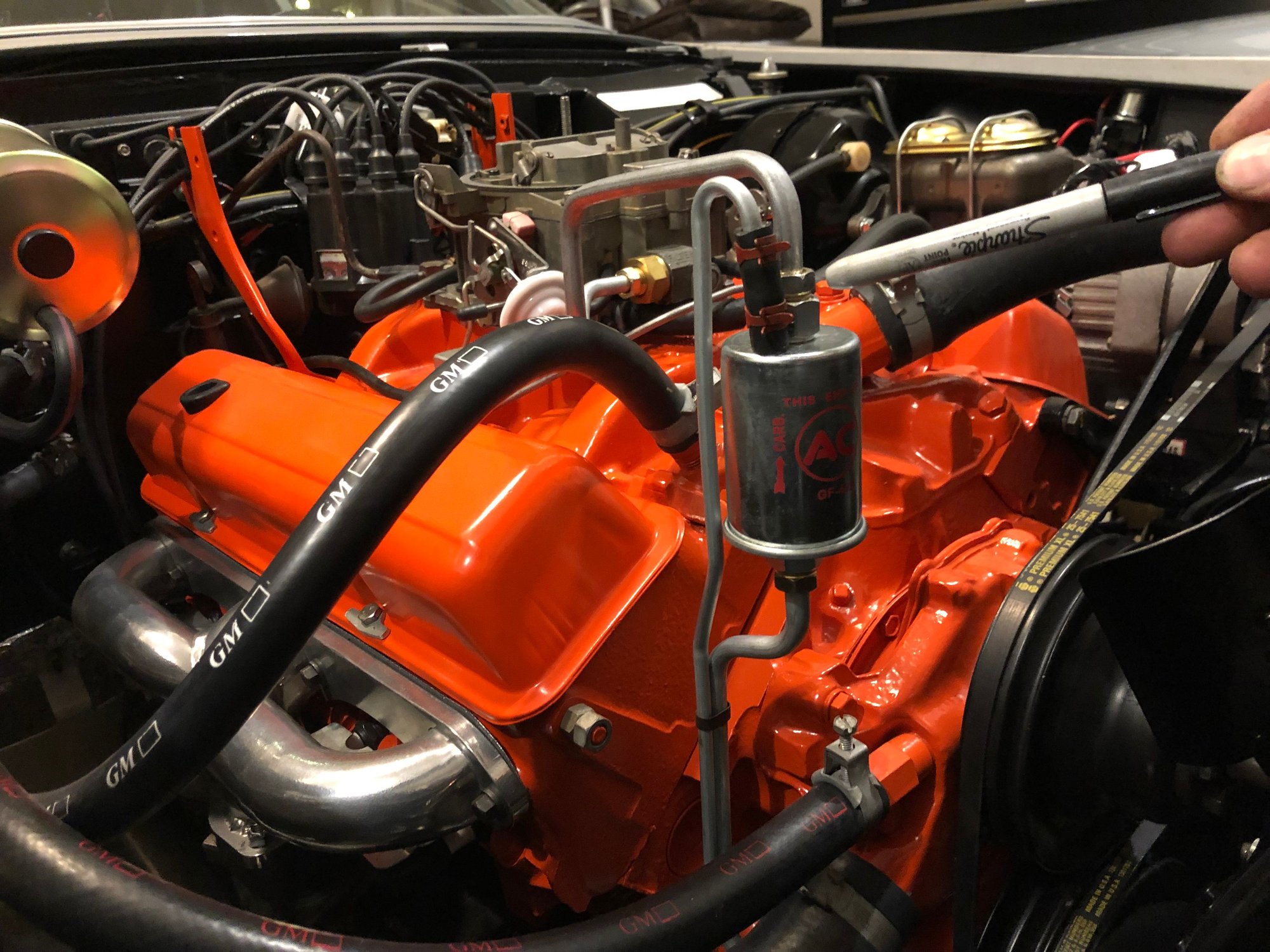

Hi,
I'll do my best to explain this...
(69, Auto, 350/300, no AC, PS, PW)
After a chassis restore and all new wiring I've got to the point that I wanted to fire it up. It's been about a year from last running and about everything is new or has been rebuilt. As the engine turns over fuel starts to gush and bubble out of the top of the fuel filter and fuel to carb line connection. The line is not loose and is aligned with no issues of threading or anything like that. The fuel pump joint is fine, the bottom of the fuel filter joint is fine....its just the top. I disconnected the carb to filter line and the carb end is bone dry...as if it's being blocked and not making it to the carb. There seems to be a good amount of pressure that's being forced out of the top filter line joint. I'm not sure where to go with this?? The lines and filter are new and the Carb was rebuilt by LARS. The sharpie is pointing to the area that fuel is being forced out.
Thanks!
Nick

If the car were in my shop, the first thing I'd do would be to back off the nut a little bit and then re-torque it, it may take a couple of times...
The flare may not be seating in the filter...
You can put a small amount of lubricant on the threads and on the flare which will also help it seat.

Not sure what fuel lines you are using as they look new. On my 69 427 I bought the filter to carb line in stainless and there was no way that line would seal on the filter. I tried backing the nut off and on tighter and tighter repeatedly and lubing it up to try and get it to seal on the aluminum AC filter with no success. The stainless line was too hard to conform and seal to the filter. The filter fitting finally broke from too much torque before it would seal. I went back to a standard steel line and another filter and there was no problem. Those AC filters are not cheap either....
If it's a standard steel line just apply some lube and tighten it down another eighth of a turn until it seals.

Apart from the leaking join , that looks really high , can you close the hood with it there ?

I would look at the flare seats on both the filter and pipe for any knicks, deformaties, out of round, or just not flared properly. I have two sets of lines that leaked at the fuel pump because of mis flared ends- one steel, one stainless.

I've tried to seat and reseat and the last few times it was really tighter than I thought it should be - I really torqued it down. I'll try it again today. I have an older filter to try to.

That looks like the correct line. It is made that way to clear the smog pump and diverter valve.

Got it! ...and start up! I put some oil on it and threaded it on an off a few times about as tight as I could get it.
Seems to run smoothly but high rpm. Lars adjusted everything so Im not sure where to start just yet and I'll likely have more questions but I'll start another thread if I can't seem to work through it.
