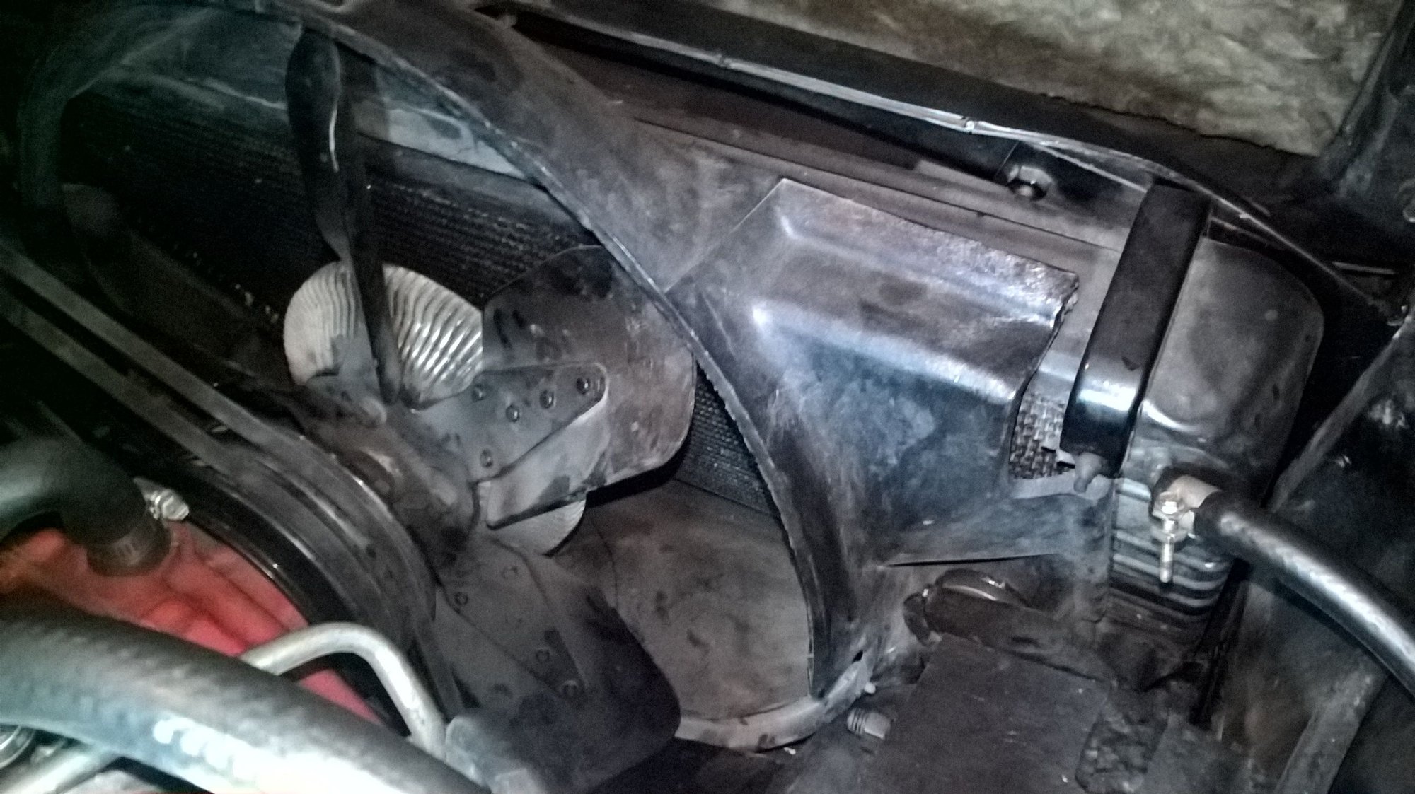

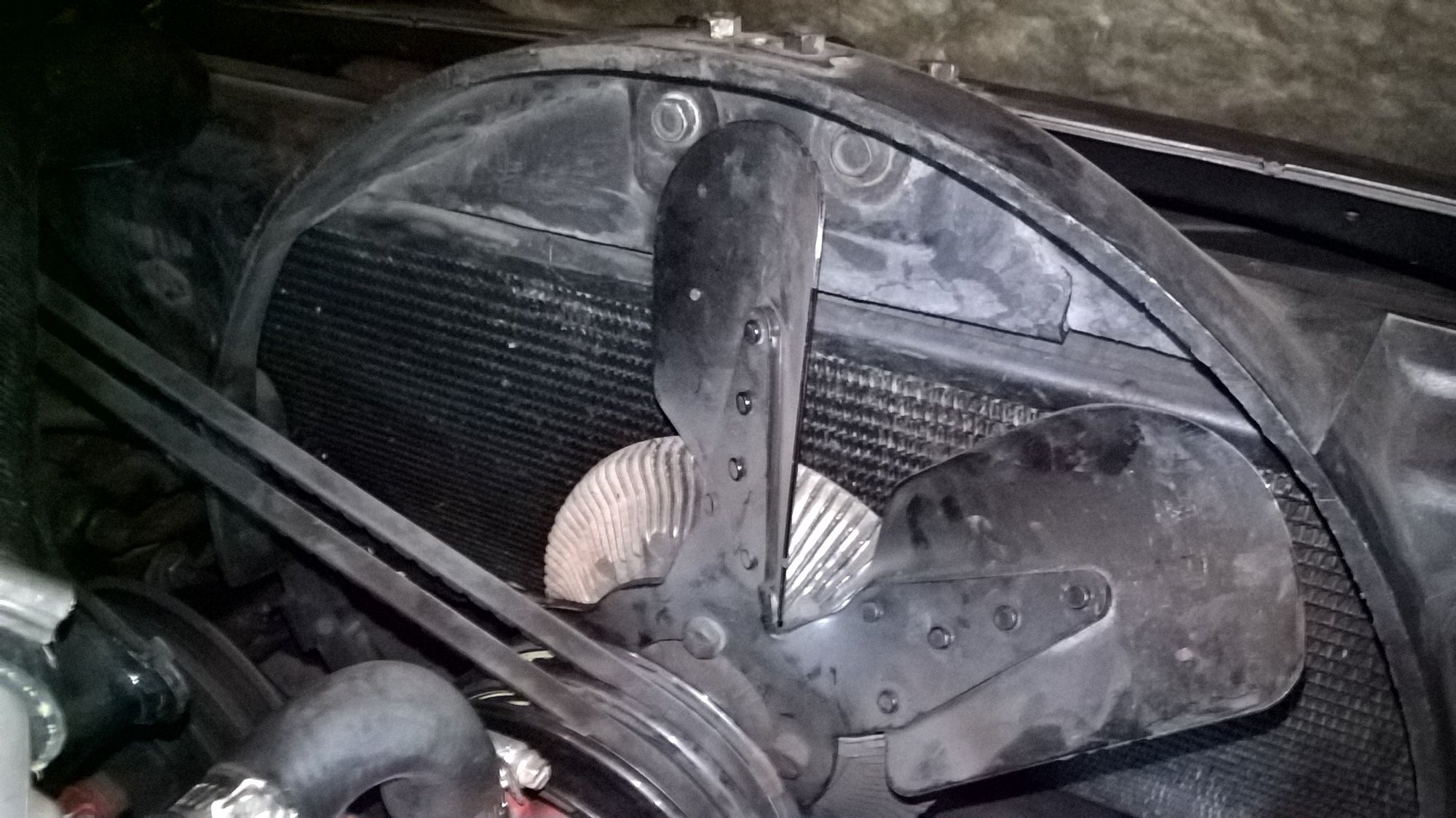

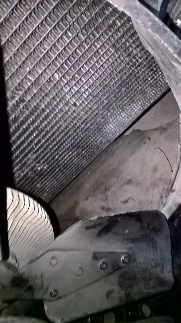

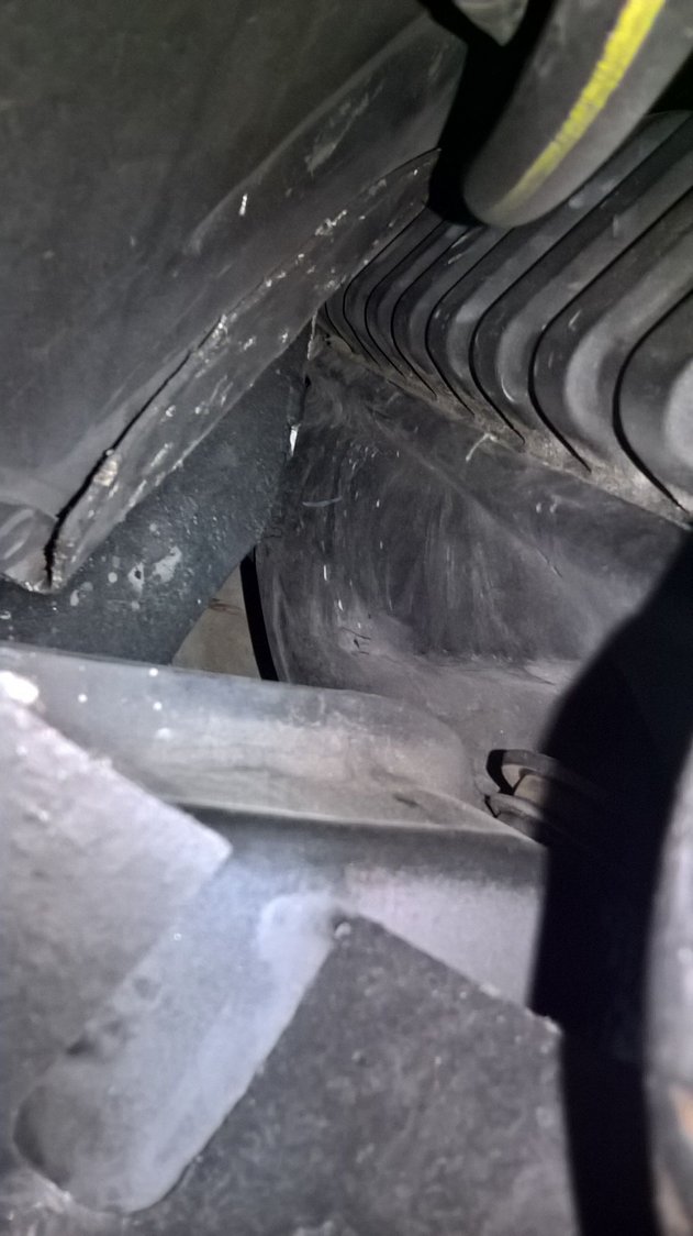

Good morning! I checked with IR gun pointing the water pump, I read about 215 ° at idle, more or lees the same of the gauge, so the sensors is ok…
the radiator seems work because I read about 195° on the top of if and abput 135 ° on the bottom.
the fun clutch is gone but maybe it's not enought for justify the heating… I must to say that the ext temperature is quite cold here now, about 35-40 °F. I reacj 230° max just in sport drive and about 215 ° on highway at 70 mph
I didn't understand what do you mean with seals and spoiler, I post some pic…
Thank you!

You appear to be missing the seal between the hood and radiator support. I cannt see around the rest of the radiator but here is an example seal kit. If your fan clutch freely spins with the engine cold and off it should be replaced.

Thanks a lot. I'll go to change the fan clutch and put the seals where needed and let's see. I hope it'll be enough for erase the 15 degrees more that I have...
