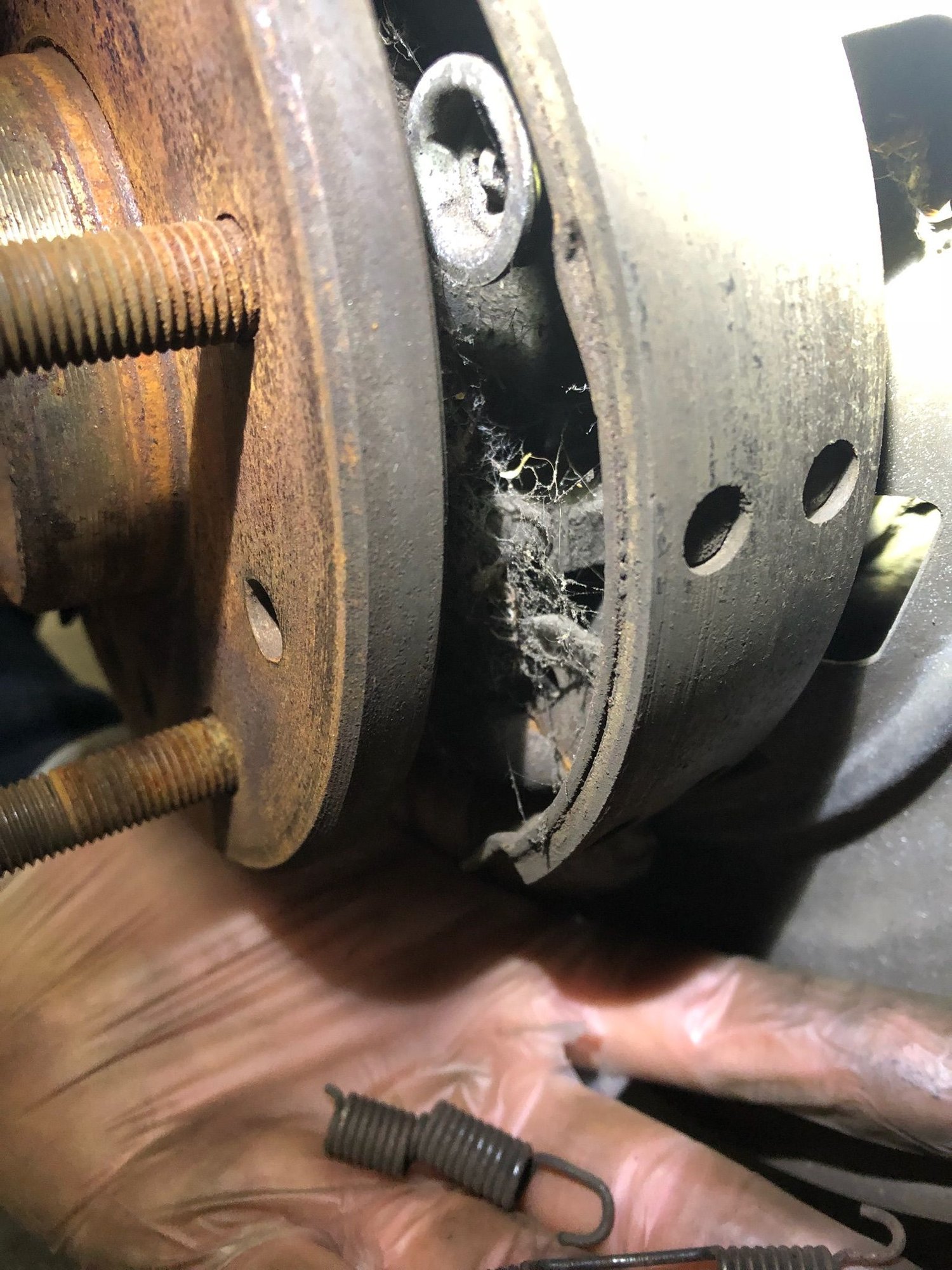

When I was having my car gone over by the awesome people over at Corvette Express they sent me this picture of the broken parking brake spring.
Since I was already at the upper limit of my budget for repairs, they essentially told me that it would be fine as long as I didn't try to use the parking brake. Is this a really difficult repair to make or could a relative newb like me manage this?
Is it just taking the tire off and replacing the spring or is there a lot more to it? Do I need specialized tools or can I do it with basic tools?
Thanks for the help... I just don't want to forget and accidentally pull the brake one day a couple years from now because they said it would not release if I did...

If you have never done it before it will be a b**ch of a job. Completely doable but you will use a lot of colorful language. There are youtube vids you can follow.

#1 Remove the wheel
#2 Remove the caliper
#3 Looks like you rivets are removed already so mark the rotor and a lug so it goes back together clocked as it was.
That looks like spring #5 so just replace it.

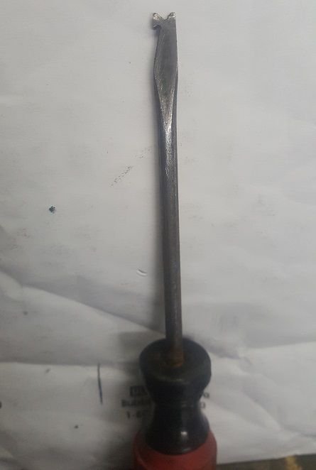

When you tackle this job make yourself one of these out of a old screw driver. It will save you a lot of time and aggravation.
Ken
Ken
Absolutely make this tool. I already had one that I made for installing a spring in a Ruger No.1 Rifle. I just moved it from my Gunsmithing toolbox to the Garage.

ok... so the million dollar question is..... What is that fancy tool used for with the spring? To stretch it?
Yes, and insert it into the hole. All of the parts shown in the above photo are behind the spindle and not easily accessed.
