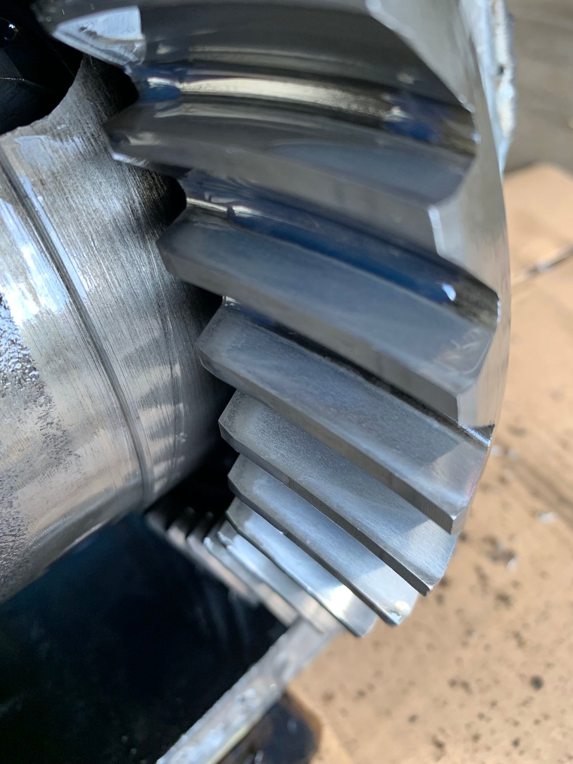

Looking for help assesing current condition of my diff. My amateur assessment is that the ring and pinion look fine and the spider gears look damaged but usable. None of the ring gear bolts are backed out.
I guess the clip that fell off the side yoke and got broken up went through the spider gears.

Pinion
