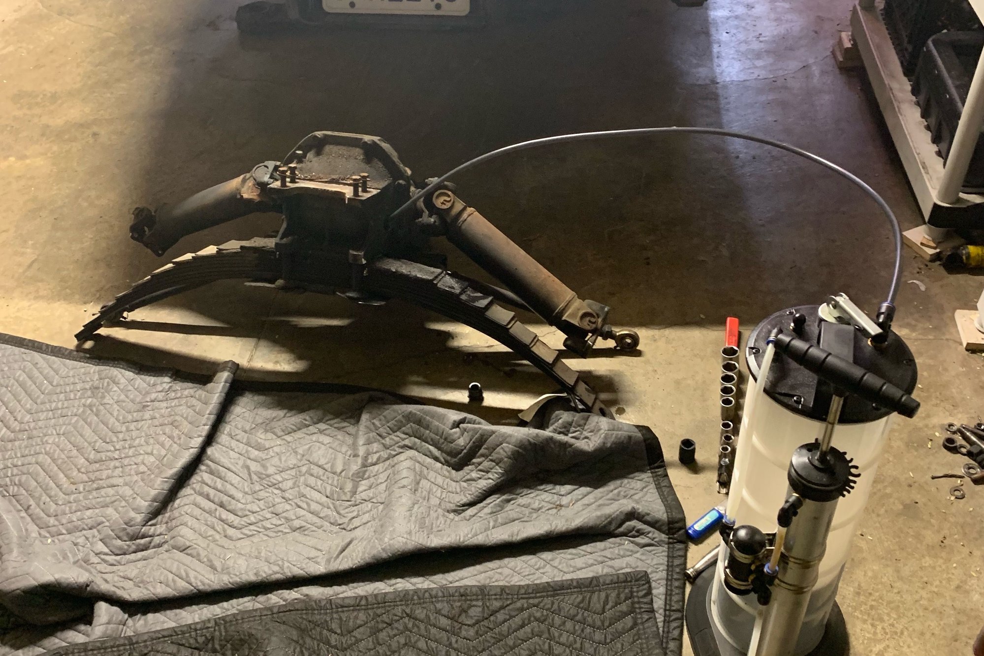

Im getting ready to drop the diff today to inspect stub shaft ends and just inspect for issues.

Ill post pics soon of the diff internals and stub shaft end play.

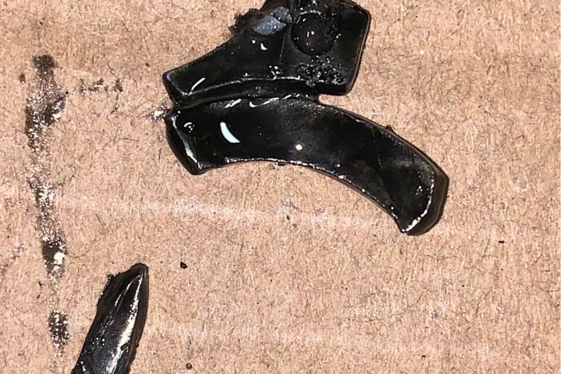

really glad I pulled the diff today.

More carnage

BUT make sure to have it all set back up in proper spec (not that hard). See the "good" stub axle side? Look how much gap behind the snap ring clip - that is way too much. Leads me to suspect badly worn posi clutch plates to get that much room.

Ok so you have it out, good. From what I see you have an original 77 diff with the very common issue of worn axle faces. This is how they all were from 1972-1979 it created a market for rebuilt axles that make people a lot of money and provided a good replacement part. The issue the past few years has been QC or lack of it. Whether new or rebuilt I have seen issues with these that should never have been sent out but also at the same time some come in that are pretty good, so you have to check them when you get them and if no good return them. I agree you shouldn't have to do this but that's the way it's been for awhile.
Sounds like you are capable of doing the work and possibly have access to a machine shop? I know guys have built up axle faces with hardened rod and fit them, others have faced and bored the axle face and bored them to press in a hardened tip- that is exactly what a rebuilt axle is. To save money these are options, most guys won't have that option though. I have a machine shop and I still use rebuilt or the best new axles because it saves me time. Your time is worth something so you would have to decide on that.
If you just want to get the diff back in the car and go you get a better axle in it and go. I certainly would not do that but it's your call. What many here just don't know and I have typed out countless times is axle endplay is dependent on 3 things. Just replacing the axle will not typically count the endplay down to where they should be. For instance, many of these diff's are out there with 030-040-050" etc endplay in them. You swap out the axles and you're at 025-030" let's say and off you go. That is still more endplay then I like to see but for an otherwise good diff it will work.
So what are the 3 areas that affect endplay? I am sure many out there now know but it comes down to this:
1- axle face wear. You can clearly see the difference in yours but what is the hardness of the better looking one? They have to be hardened and the 72- 79's were not. They will always ride up against the cross shaft in the posi and that is hardened.
2- Posi setup. These are spring loaded posi's, not a bad design but the spring load also compensates for mass production tolerances building these posi's. MOST of the time the posi is not dialed in as it should be, been a problem since 1965 when the first Eatons were used in a vette. It continues to today with the aftermarket units. Those have different clutches and spiders but the design is the same as it was in 1965. I have taken apart new out of the box posi's and once the springs were removed found up to 030" endplay in the side gears. Are they all like that? who knows they are production built unit, same as always. If you tune it like I mentioned above this will dramatically change the endplay in the axles so those rebuilt axles with face dimensions all over the place may actually work. There seems to be a misunderstanding on the clutches too. Most likely because few have actually taken them apart and just pass on information and that sometimes changes as it passes from one to another. The new carbon fiber clutches will in fact wear, you can rub the material off by hand without a lot of pressure. The original steels do not wear out like that, if you want to go cheap you could measure them and I would expect you to find them in the 068 range +/- 001". They have a diamond stamp pattern on them but they were never a sharp diamond like a deep cut knurl on tool handle would be. Will you see a shiny "ring" on them - yes but that shows up when I am seating new clutches and they are not worn out. Years ago I coined the term "snowflake" clutches, it caught on here and people refer to them all the time. They were an attempt in 1972 to stop the posi chatter common with a spring loaded production built posi. they did not work. All they did was make the posi weaker and those that abused the cars ended up breaking the clutches. Look on ebay and there are still people selling these "original" clutches, they are junk. They are also what you have in a 72-79. Bottom line the best posi's are ones that use solid steels, are fully polished, and tuned. Those will go a very long time and out perform a stock spring loaded posi every day of the week.
3- Posi case cross shaft hole. Not as common as the other 2 items but something to check are the bores. They should not have a step in them and should be round. Extreme cases of wear will allow the cross shaft to move once an axle hits it which is at any turn. If the bore wear is loose but not crazy it can be rebored and a 12 bolt cross shaft fit, you would also have to install 12 bolt spider pinion gears and thrust washers. You could also bush it to original size as well but if I am going to do that work I would use the 12 bolt setup. This is something you have to weigh against just replacing the posi case. Replacing a posi case is another story- that I am not going to type out today.
In addition to having lousy axles and clutches, the 72-79's had issues with the ring gear bolts backing out. Around 1977 GM saved a penny by going from a hardened shoulder bolt and lockwasher to a flanged head bolt. Again with a production built item some were good but many were not and the bolts backed out over time. No Loctite was ever used on them. While some of the shoulder bolts also backed out in the earlier cars it was common to see in 72-79's. I rarely have seen it in pre 72's and even less in pre 68's. Same with the axles used from 63 to 71 or so. I have taken apart 100's of them and most of the time, even with over 100k miles, the original axles are still good. In fact, when used with a correctly tuned posi I have to kiss cut them on a surface grinder. This is only a few thousands so they are still hardened and the end play is dialed in to 005-007" where it should be.
Now you know more about these and can make up your mind. You have the diff out, if you have the tools and experience you can slap it together, sub it out, or build it right. Some will tell you these are harder to build then other diff's of the period and that only tells me that person either doesn't know what they're talking about or worse they are just trying to get your money. The principal is the same, you need to set the backlash correctly on what your are working on - a 77 vette or 77 C10, Camaro, etc to have it last and run as quit as possible. If you cut corners in the build it will not last.
Worn clutch plates is NOT what is causing the snap ring groove to be where it is at in that photo. It is because the end of the side yoke wore down and he is pushing in on the side yoke to make it contact the pinion shaft.. I see this ALL the time on side yokes that have worn down that badly..
Not saying that the clutches are also worn out but ...but bad clutches is not what is happening in that photo.
I guess how you feel you can repair the side yoke and not spend money on them is all up to you. I have no clue on what your capabilities are and if you have the equipment to do it correctly and harden the end correctly to the correct Rockwell hardness due to there are companies that DO IT. So if you feel you have it all figured out....have at it. You have only yourself to either pat on the back if you get it right or blame if it grenades. I would get a new pinion shaft due to I would guess it is worn and NOT smooth and would begin to eat up your repaired side yoke ends.......unless you feel you can repair that one versus buying a new one from GM.
