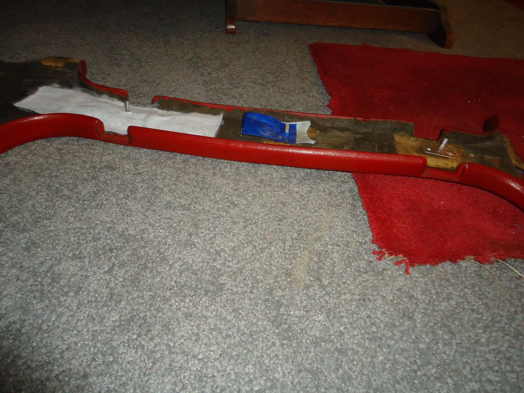

Ok now I'm trying to reassemble the trim after replacing the rusty header. Naturally nothing seems to fit, but all my projects are that way.
On this stainless t bar, on the under side there was some type of sealer on the edges, looked like a foam. What do you use in that area? Windshield sealer?
On this trim piece there's 3 pins that are supposed to snap in to hold it in. My t bar only has one installed from the factory. The other 2 were never installed. I guess mine was a Friday car. Any ideas what I can use to attach the other 2. Some type of aplastic retainer I can put in the holes ?? ( That white stuff is a repair I did, the underside had a crack in the fiberboard from it sagging )

I use CR Laurence's CRL 7708 as my go to sealer when wanting to make sure I seal up areas to prevent water leaks in most areas. I do not worry about the foam that GM used and clean it off due they never figured these cars would last over 40 years...so when install this trim I pump in the CRL 7708 really good to make sure it never leaks but it still can come back out if needed due to the CRL 7708 does not harden and stays gooey all the time.
AS for your studs for your trim. This must be like a 1970 or so due to these studs were installed BEFORE they wrapped it in the vinyl and trying to get something to make sure it will stay put on the fiberboard backed part is kind of a hit or miss situation. For me doing this type of work for living know I would not nor could not waste any time on it and just buy a new one due to if it failed and it released. I would have to deal with it time an time again and it is just not worth my time. I have several ideas... but once again...by the time I did what I needed to do...the cost would be close to buying new one. So best of luck with that.

Thank you D U B for responding. Ill try to get the CRL 7708 sealant. As for the studs, the metal retainers that are supposed to be riveted in the t bar were never installed. The only way to put them in is to separate the 2 halves. I'm not going through that. I found some plastic retainers at napa that are used for attaching bumper covers on new cars that might work.
