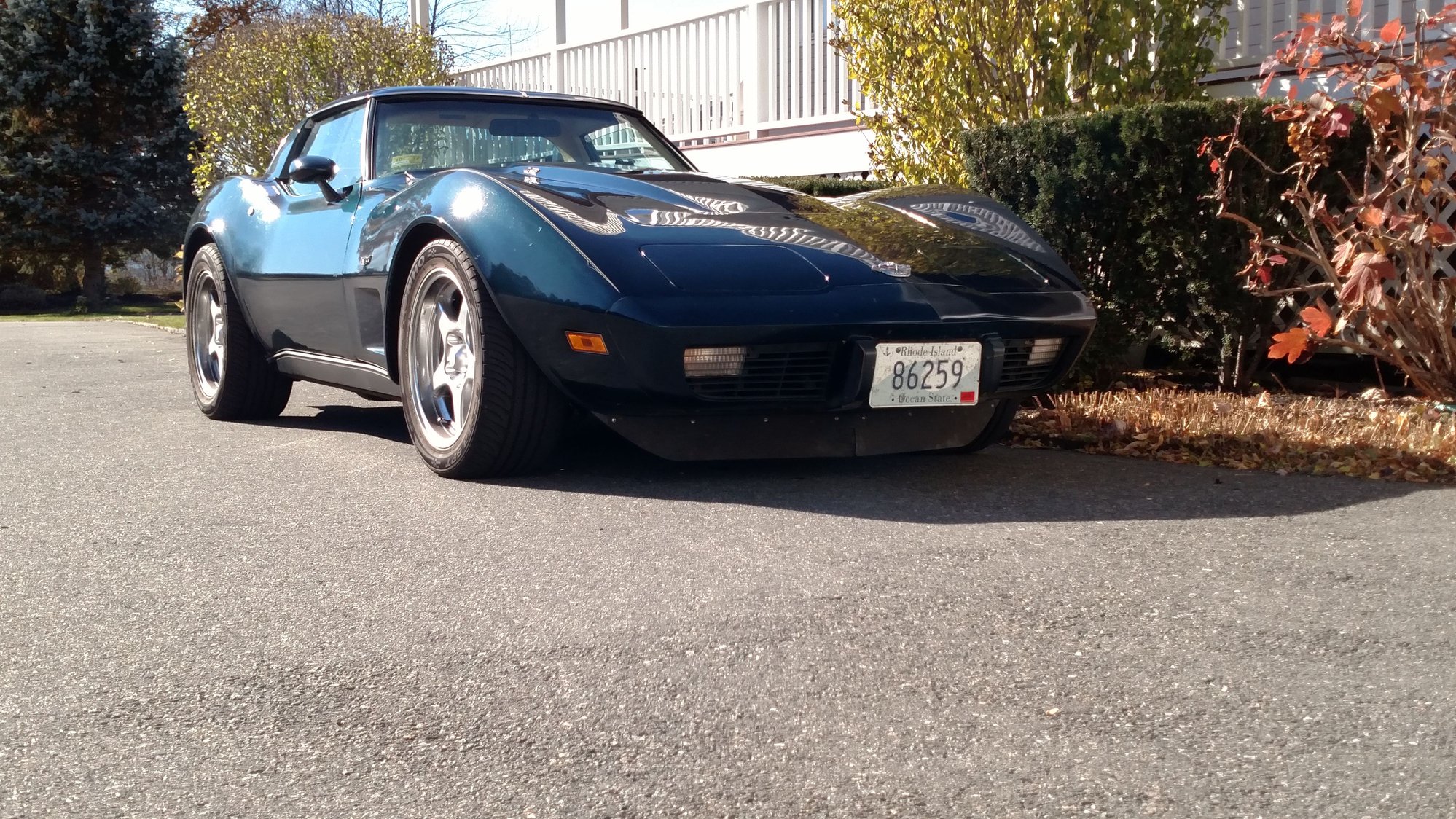

this is a close up of the extension JB78L wrote about. It lowered my temps during highway driving, but find out first if you engine is operating correctly. You might not need the extension which you can put on later but the factory spoiler is there for a purpose:
