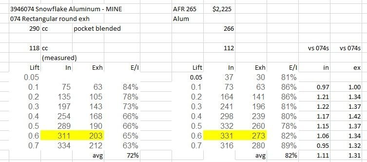

I know some of you were following this and many of us were rooting for 550HP, but it just didn't happen.
Well the cause finally came to the surface.
It was the 50 year old GM Snowflake Cylinder heads, particularly the poor flowing round exhaust port.
There is not a lot of difference in the intake flow, but the exhaust on the AFRs is 32-42% better!!!
And the exhaust to intake ratio is a poor 65% on the snowflakes and it jumps to 82% on the AFRs.
The computer model showed that big 70cfm exhaust flow difference is directly related to HP.
Switch the heads in the model and bang...560HP.
INSTANT 80HP
The snowflakes are just that ..old.. and the AFRs are just that much better.
Neither of my builders or I were expecting that big of a difference, but yeah, they are 50 years old. I was guessing half that.
I am not changing the real engine now, and at least the difference is mostly above 5000rpm.
But, if I would have known 1-1/2 years ago, what I know now, ....hmmm.....
So now YOU know.... Do you want to run old OEM heads....or new ones?
