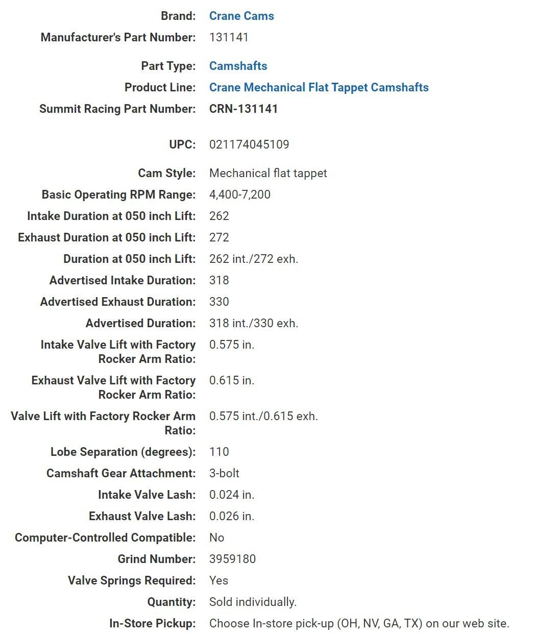

And then there is the blueprint cam from crane, with a little different advertised duration:
ZL1/LS7 Reproduction cam from crane
As can be seen regarding lift: The 1973 sheet says 579/620 lift, the 1993 catalogue says 580/620, crane reproduces it with 575/615.
There are also small differences in advertised duration, but all share the ~580/620 lift split and ~262/272 duration split.
