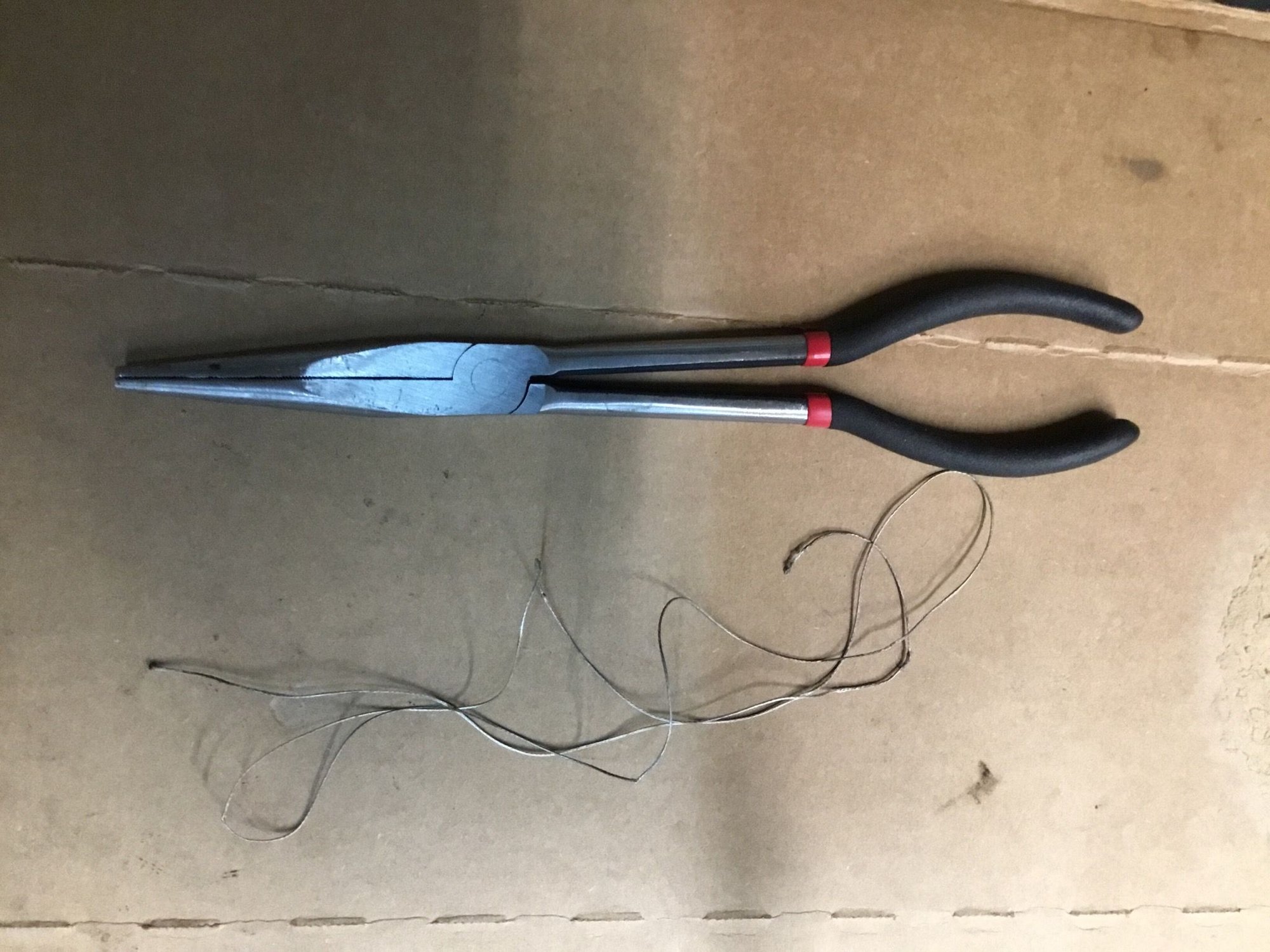

Thanks for all the help. I bought a long nose pliers from Hime Depot that worked great

+1 on that one. Worked great!
