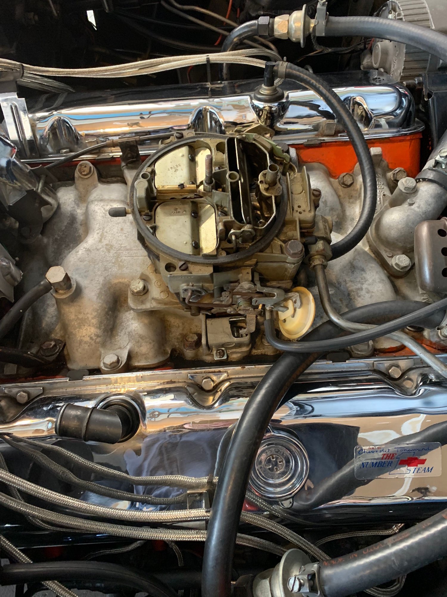

Hoping someone can chime in with some help here. I've had my '69 427 390 car for a few months now. Let me preface this by saying the car does not have the correct Qjet on it, but it is a 7040502. It's always started and acted like the choke was working fine. Recently, I changed the timing which got it running better than ever. Only changes I made to the carb were the idle mixture screws and idle speed screw. Soon after though, it was idling high, acting like the high idle was sticking...once in a while when really warm, it would kick down, but occasionally get stuck up again. I started messing with it, and it seems like the choke spring is not releasing fast enough. It's at the point where the choke will not open fully, even though the engine is warm. I tested the spring with a heat gun, and it does respond to heat. Just puzzled as it worked fine before...started at about 1200 rpms on the high idle, then dropped to about 800 when I tapped the throttle. Maybe I knocked something out of whack when putting the air cleaner on and off while
I'm hoping someone can take a picture or video of their carburetor when the engine is started cold, and then show how the choke comes off. Things I have checked so far:
Vacuum pulloff is functioning and not leaking..checked with vacuum pump
Not sure if car has correct choke spring, or rod, but it worked fine before
Car runs excellent when warmed up with choke disconnected
choke rod is disconnected in this photo

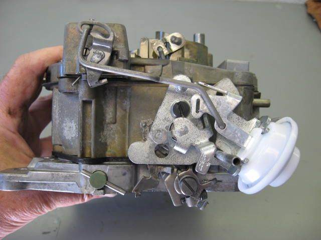

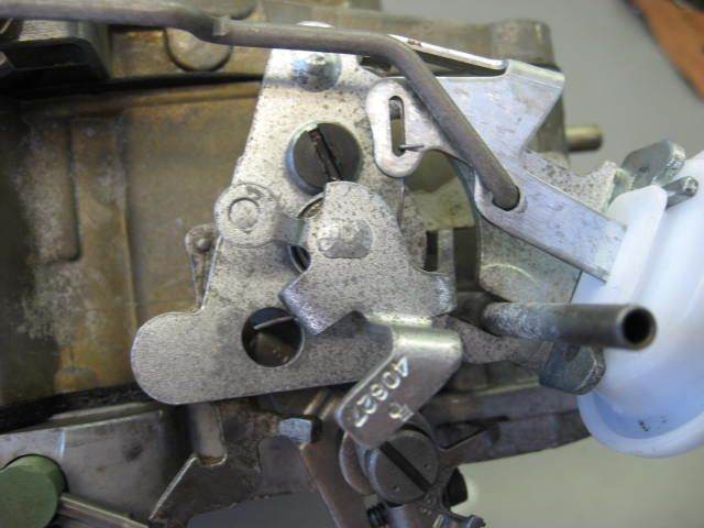

One thing I can see right off the bat is that the choke pulloff spring is not hooked up/correctly attached for your 1970 carb's choke system. You might want to start by assembling it correctly.
Correct 1970 choke - note the spring attach point in the pulloff lever:

I have no idea how you could even see that. I got out a magnifying glass and sure enough, there's the spring end laying below the attach point....

I was just looking at your engine pic again and don't see any vacuum advance line to your distributor from the carb. Do you have it blocked or is it tee'd off the line from the single manifold fitting behind the carb?

Lars do you have any more pictures of the correct 1970 carb? I would like to compare to mine to see what I'm working with. I can already see that my choke pull off rod looks different from this one you've posted.
