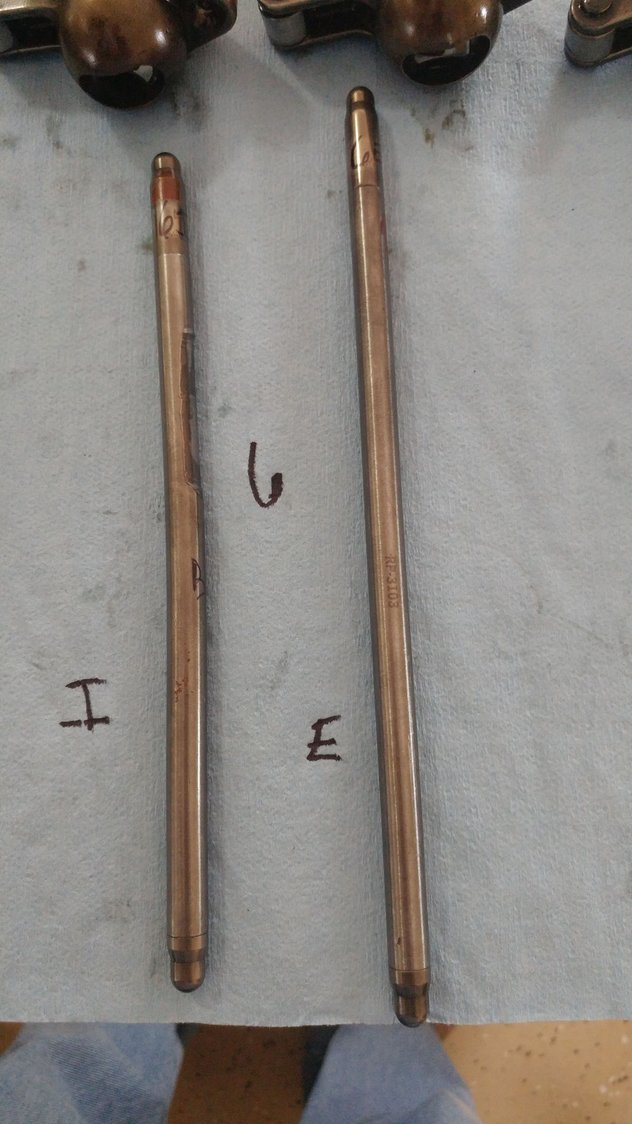

Replacement Cam and you don't know what. you need to know the valve lift. You can get pretty close with a good little steel ruler. Stand up next to a valve and have somebody bump the starter. obviously subtract up from the down measurement go around and check a bunch of them. Intake and exhaust separate. 20 buck digital caliper would be better. What 427? Head casting numbers? Orig o-ring valve seals or umbrellas or positive seals under springs? You also want to get a cheap lever style spring compressor and feel the valve that bent the rod for binding. Is valve bent? Compression test. https://www.ebay.com/itm/OEMTOOLS-25...cAAOSw7thb-KAa
The heads are original cast iron. 3931063
L36 427 3963512

Originally Posted by Z06CE
Excuse my ignorance but how did you determine the push rod is 2 piece. Is the ball removable?
I'm at work so I can't examine the rods.
If you look at the pushrod you can see the parting line. Basically they take a piece of hollow tube and pres in the ends. Those are cheap pushrods. Pony up the $$$ and get a set of god one piece rods. Find out what bent it in the first place. As said above coil bind or some other clearance issue. I would pull all the pushrods and check them all. Also the tip of that rocker arm has some scoring. Pull al the rockers and check them.

Valve stems are much stronger than the light weight push rods. So it is good that they can flex and bend. Flexing and bending also decreases the valve lift and effective cam duration. That is why some of the other poster said to go to stronger push rods. You can do a leak down test and a bent valve or leaking valve can be heard from the hissing of escaping air. Who ever installed the bigger cam cheaped out and used some marginal parts. Bent push rods are a sign of over revving the existing springs. Hydraulic flat tapped lifters use lighter pound compression springs compared to the other 3 types of cams and they are the red line rpm limiting factor. Because they go into valve float at a lower rpm.

x3 get some proper springs and pushrods your valves are probably fine. Check clearance for binding & set them up right then you can beat on it all day

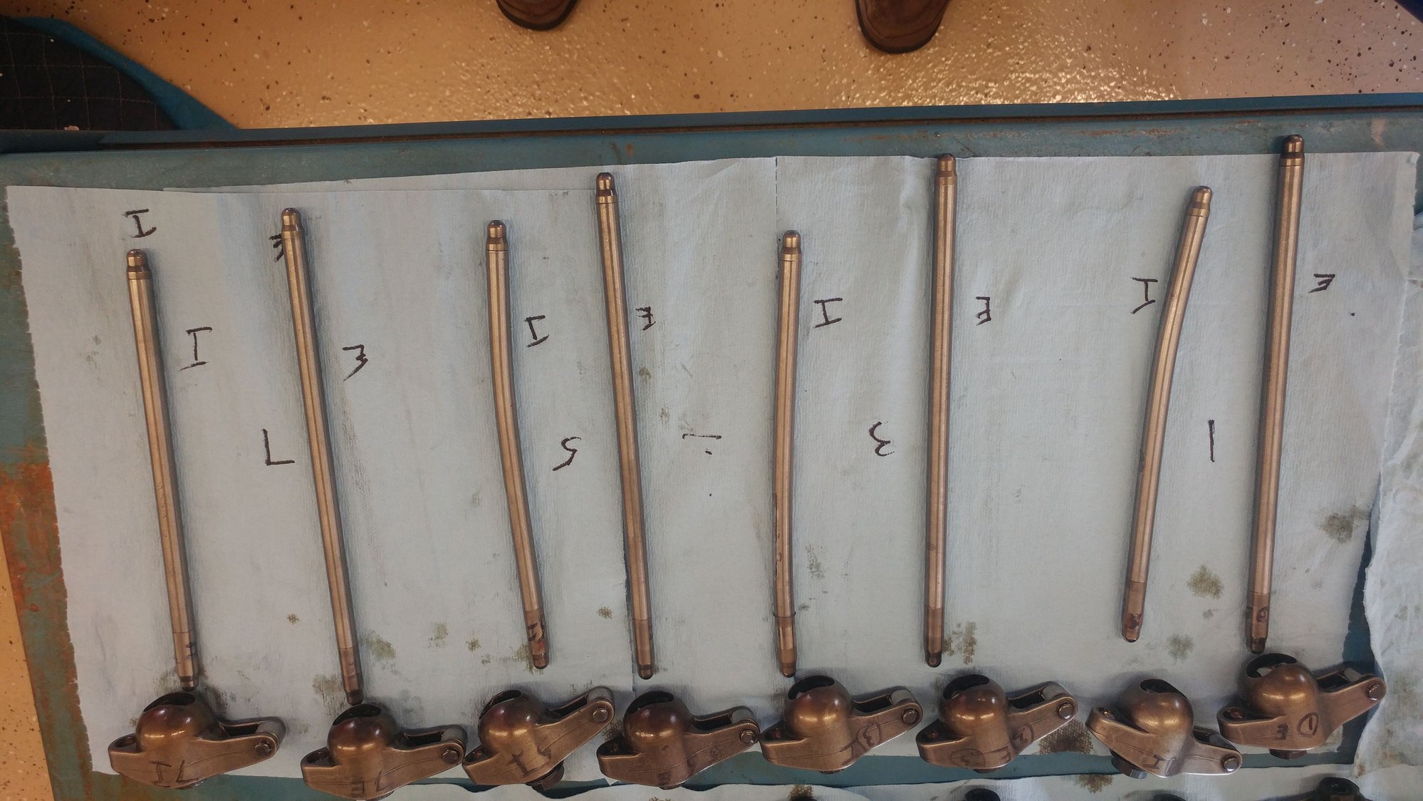

Default More Bent intake push rods
On cylinders 1, 3, 5 intake push rods are bent
Cylinders 2, 4, 6 intakes are bent
Now what? Remove intake to inspect lifters and cam?

Yes. And valves so you might as well get guides and seats. I am putting 11/32 guide inserts and new valves. Then figure how much valve travel you have and measure how much valve lift that cam makes. If that guy is. 6 lift, it is overwhelming all of the stock 40 year old valvetrain.

Need to inspect all RA studs and RA slots to see if they hit.
Need to determine if there's any coil bind.
Measure several lobes lift both intake & exhaust
I'd have checked the above w/ valve train assembled but you can do it disassembled.
or straighten a couple PRs (I & E) enough to reassemble One cylinder. Roll motor through and check gaps between coils / coil bind when valves fully open
count your blessings ... seriously ... you caught this before it got much worse!

I'm still of the opinion that this is straight coil bind because somebody cheaped out and didn't replace the springs with the new cam. If you look at Comp Cams website for example, even with one of their fairly mild cams whether it's a roller or flat tappet hydraulic, you must replace the stock 427 valve springs in stock heads or risk coil bind. I think that's what's in the pics, not pistons hitting valves. It isn't a valve timing issue. When you're changing the springs (throw in some valve seals at the same time) and using compressed air to hold the valves up on that cylinder you will know right away if you have a bent valve. You will hear it and it won't hold pressure. Your main problem is figuring out what cam you really have and what or whose springs to use.
