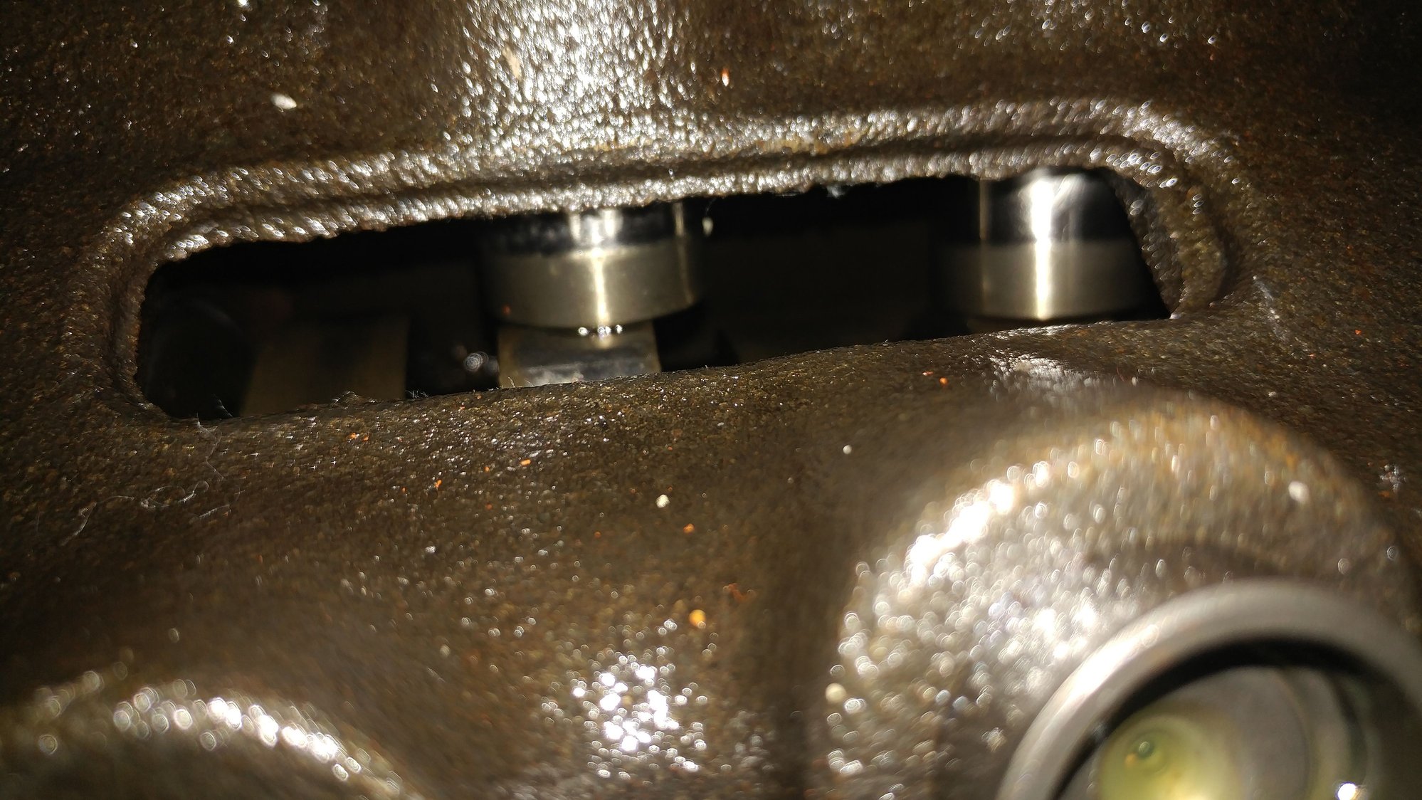

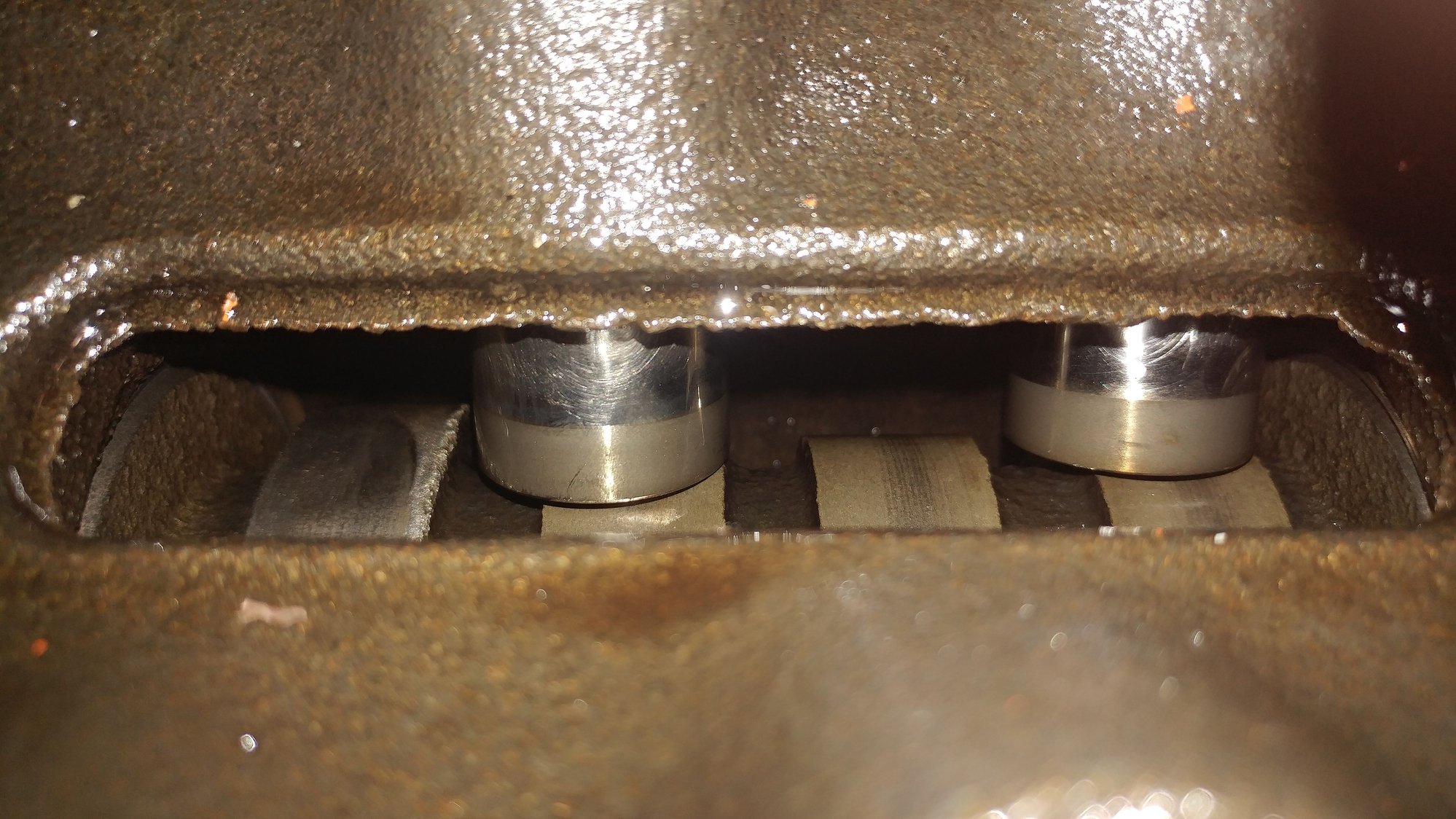

Update.... Took the intake off.
This is crazy but the rockers are hitting the rocker covers.
I believe I have solid lifters! I took one our And I can't push it down.
Check out the pictures where the cam and lifters meet... Should the lifters overhang the cam lobes?

On a clean paper .. Take the snap ring out of lifter ... DON'T lose any parts ... carefully take lifter apart ... lay the pieces out in order ... snap a pic and post it here.
take a second, hi-res pic of face of lifter so we can see any wear pattern ... post it here.
To '69 427 Bent Push Rod

And yes the lifter face is bigger dia than lobe face length. So it has to overhang. Rockers hitting valve covers is not uncommon.doubling up valve cover gaskets gets more room without replacing valve covers.

ZO6C3,
The cam lobe is designed to actually rotate the lifter ever so slightly, ever time the lobe comes around. That keeps the lifter from getting a flat spot.
Now, lets hear more about the valve cover interference. Are they stamped steel? If they are strong cast aluminum that could really put a damper on (bent) pushrods.
