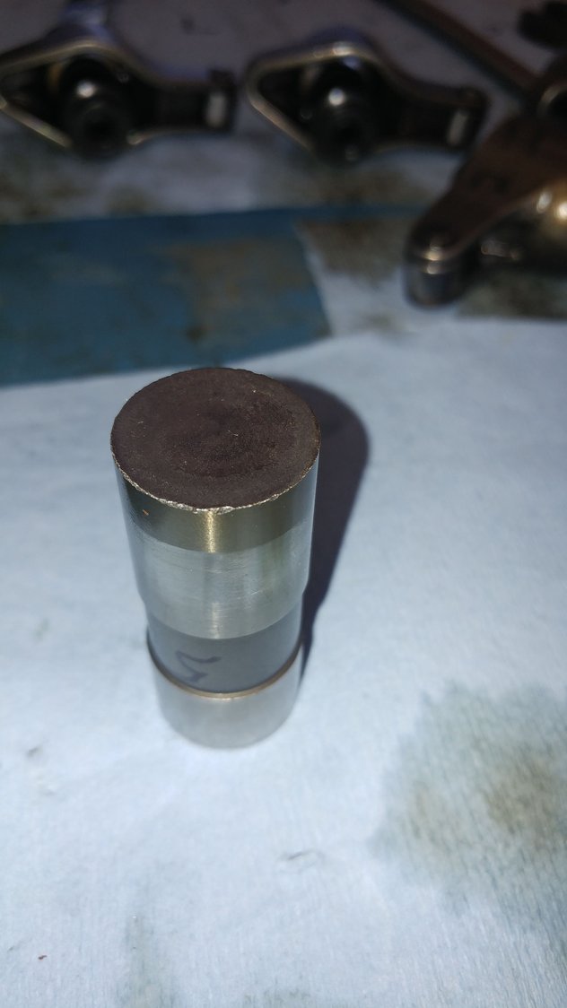

Jackson, Here is cylinder 1 intake lifter... It is hydraulic
II

I'd buy some springs, P/R's etc. and enjoy the Car. Granted, I can't be sure that Lifter is not worn (seems decent from the Pic.), but if it's not worn, I wouldn't go further
II
Yes, It IS Hydraulic ... perhaps even an anti pump up/Hi Rev version.

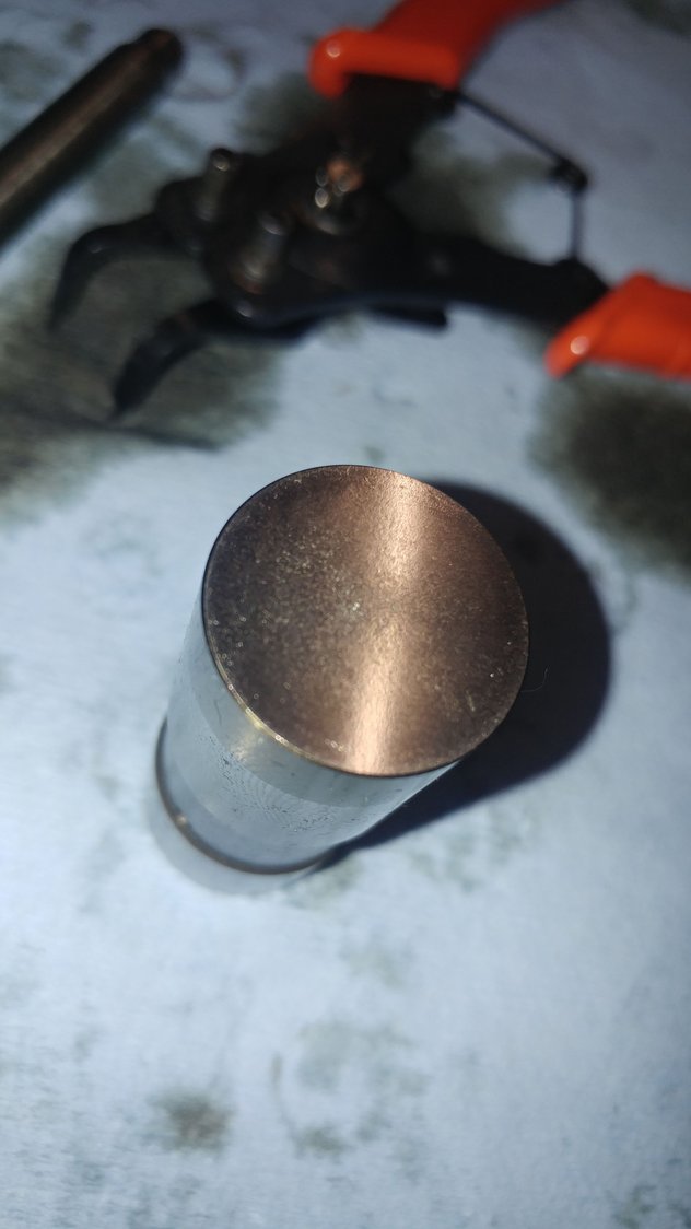

Well more bad freakin news, found a bad lifter and Cam Lobe while checking cylinder 5 exhaust lift with the dial indicator. Should be .505 lift, measured .357.
Inspected the Cam Lobe and it's nfg

Nope. Somethings not right there.
.505
- .357
= .148?
You measured incorrectly. That's too much meat missing, over eight of an inch.
Are you really shocked another lifter was bad? Everybody saw that coming. Shocked it was not all 16.
I don't know what that last picture is.
.505
- .357
= .148?
You measured incorrectly. That's too much meat missing, over quarter of an inch.
Top of the lifter.
That's the only lifter bad
.505
- .357
= .148?
that is the face of a badly worn and dished lifter. And it could have a tenth inch worn out of the middle. Which would give .170 lost valve lift.

Plus the wiped cam...

The colorization of the lifter base is just weird. Almost a bronze / copper / rust, or maybe even burnt. Never seen that before.
.505
- .357
= .148?
Yes believe it, I measured several times.
What's not to believe? material from lifter plus missing material from cam lobe.
What I don't understand is why the exhaust when all the bent push rods were on the intakes not the exhaust.

As I wrote before ... there's probably sine error from your measuring technique.
SEEMS .. those four intakes are in reasonable agreement.
BUT those four exhausts are NOT ... BOTH Exhausts C#3 & C#5 are WTF Out!
BOTH Cam & Lifters are destroyed You've wiped some 0.080" - 0.090" off Ex Lobe C#5 Alone!
Still don't know what bent Only Intake PRs, but PROBABLY coil bind.
BOTH Cam & ALL Lifters must be replaced. JMO but flat tappets AOK if all valvetrain correct and cam broken-in properly.
