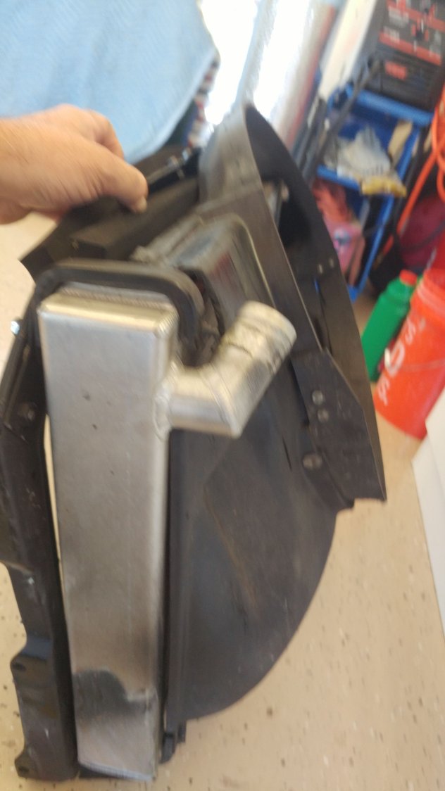

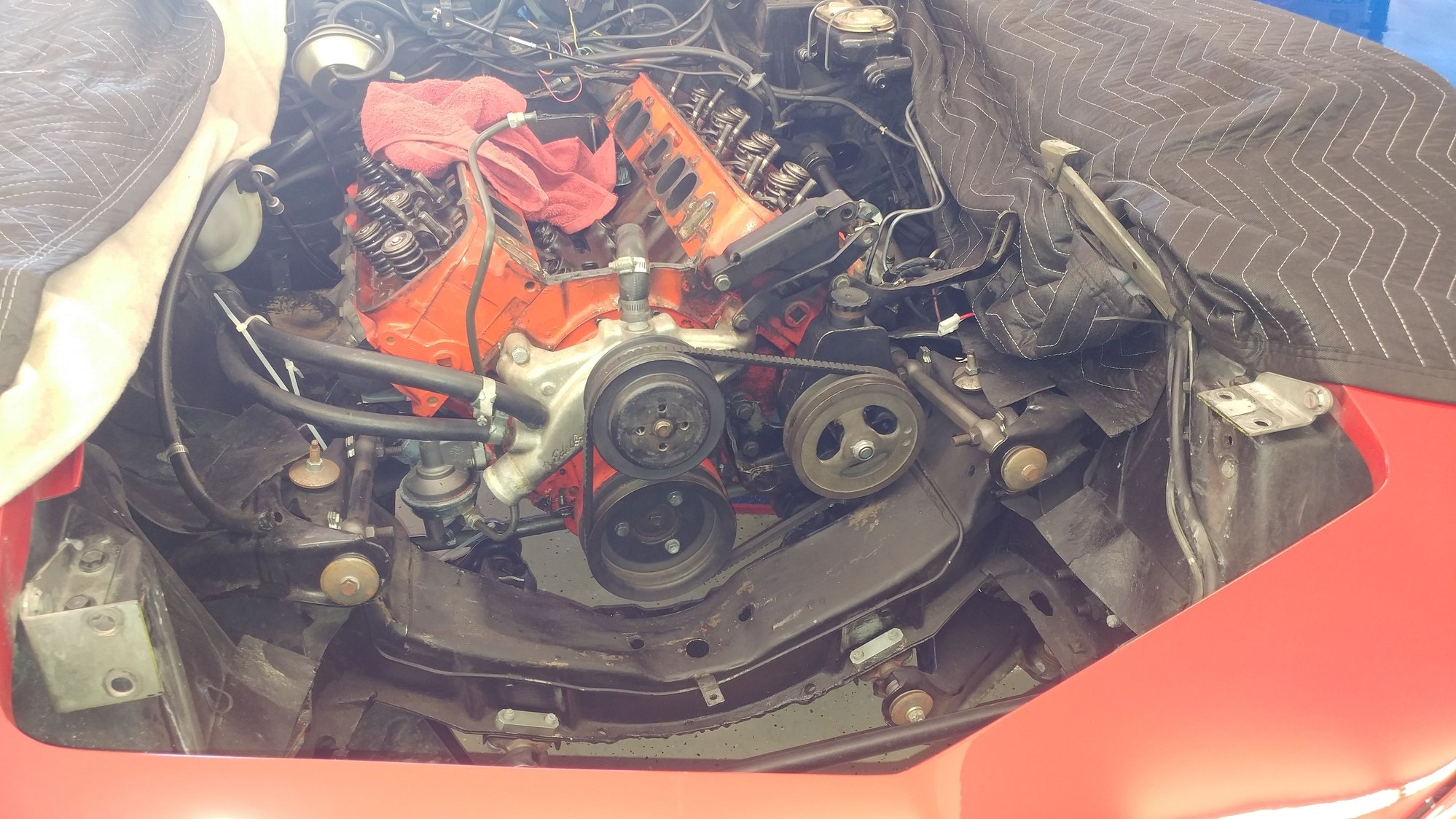

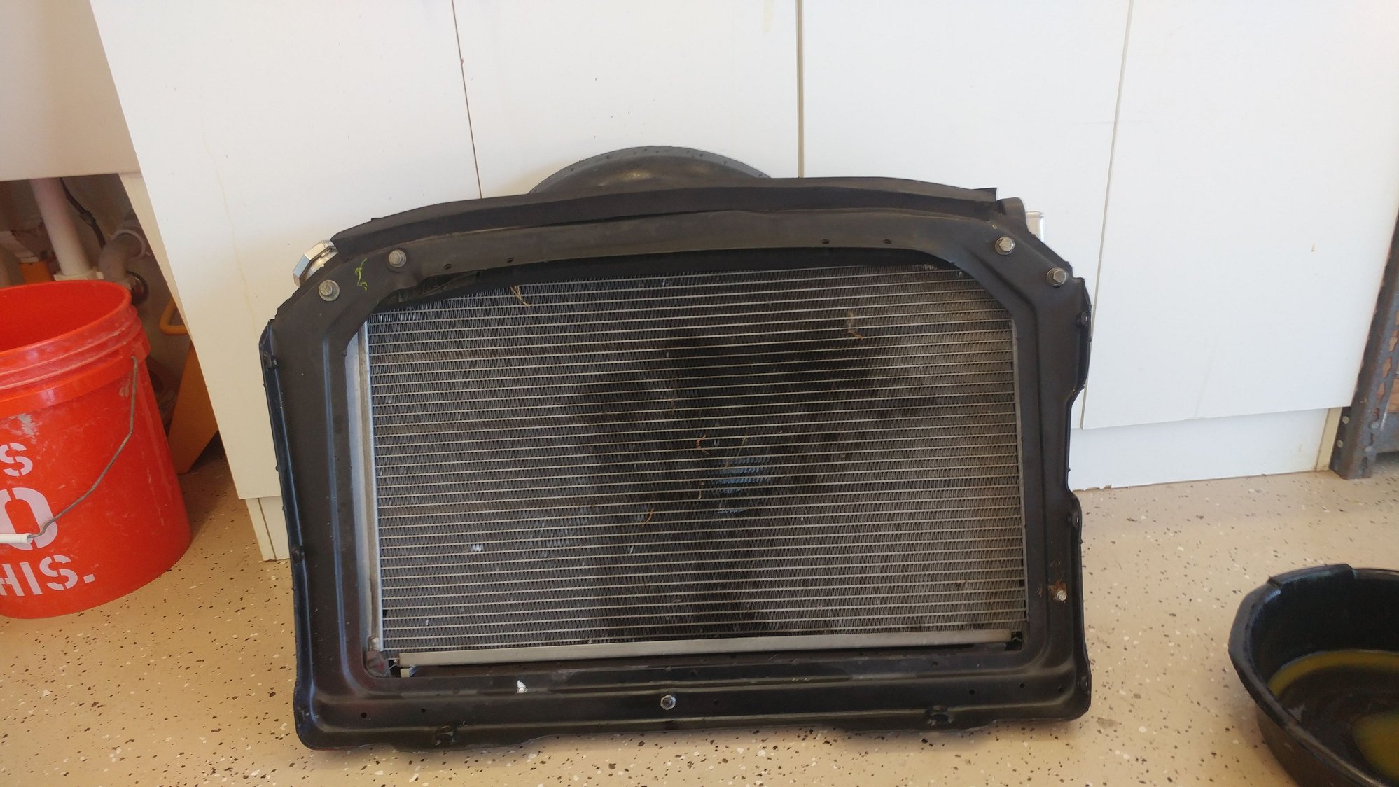

Today I got the radiator support out, alternator, Power steering out of the way and removed water pump.
I'll be pulling the harmonic balancer off tomorrow
I found pulling the whole support along with the radiator is very easy

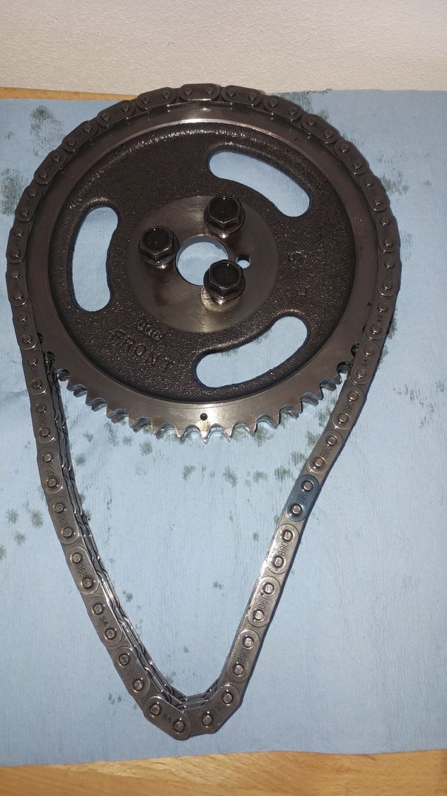

Default Timing Cover is off
The timing cover and timing chain are off,
How is the Cam removed on a BB.
Timing sprockets look good... Timing marks line up..
There is no model number on the face of the camshaft.
Mike

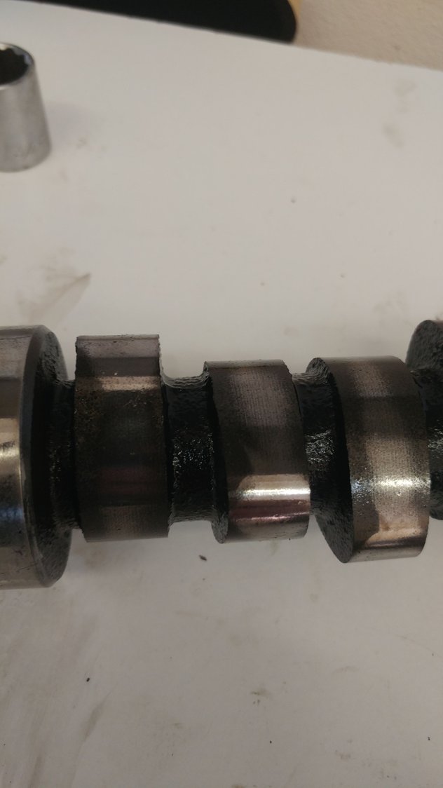

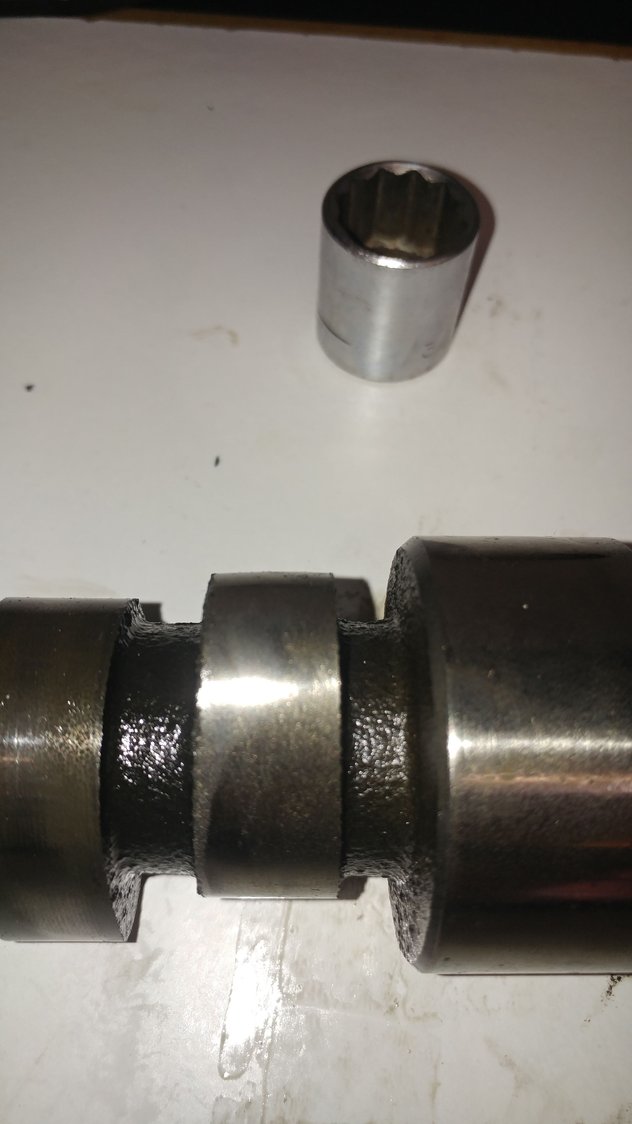

Here's what it looks like

The cam is trashed.
