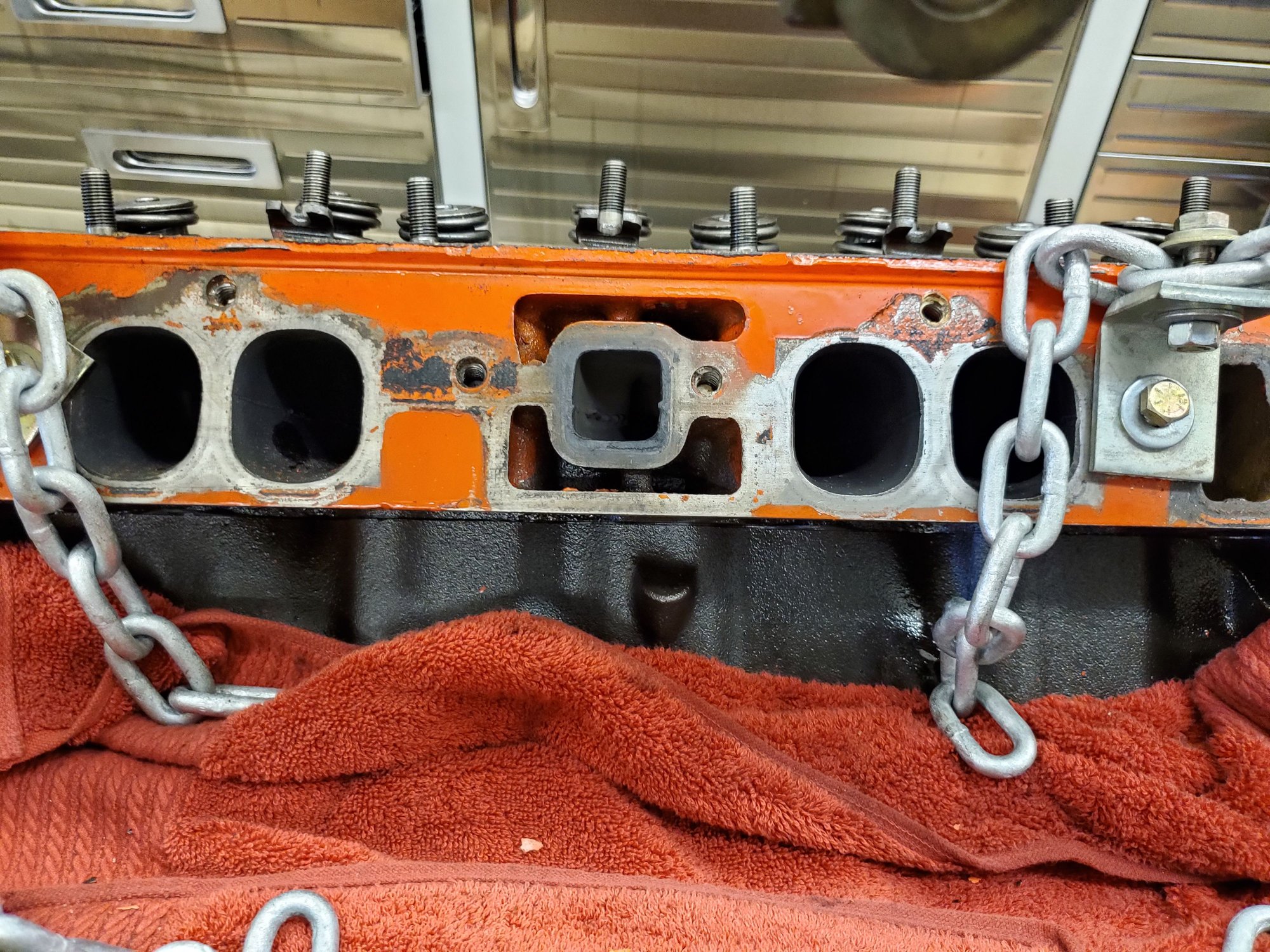

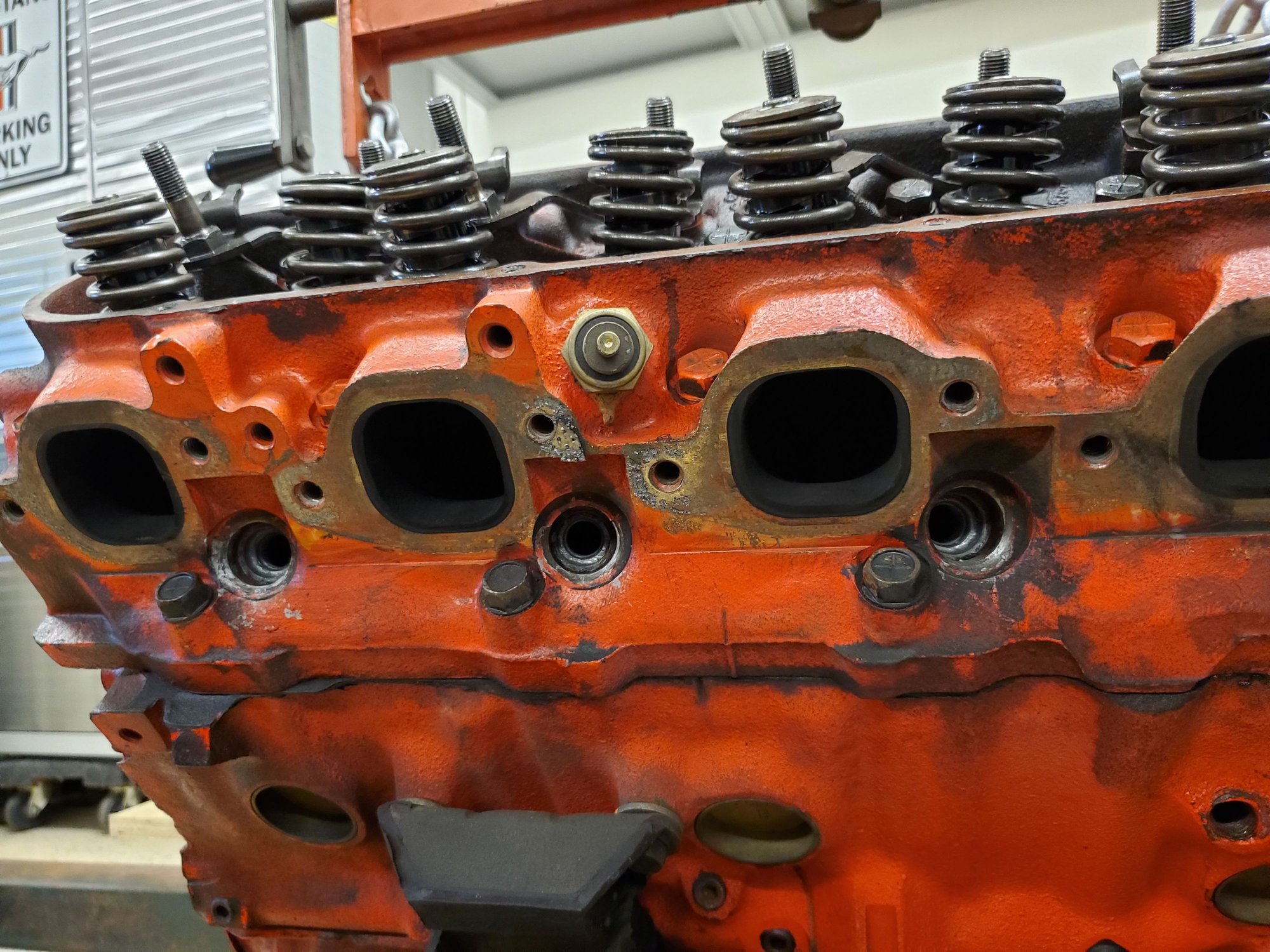

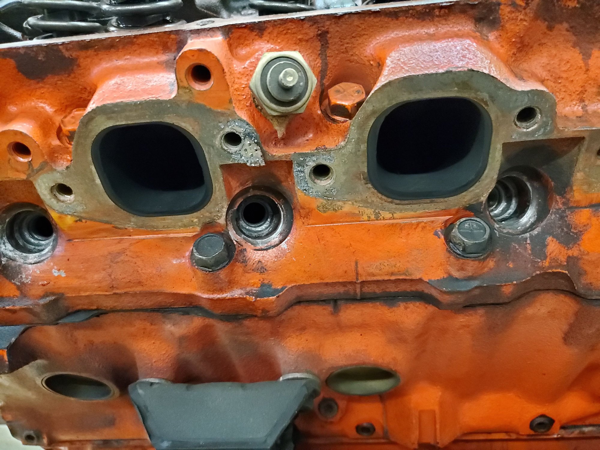

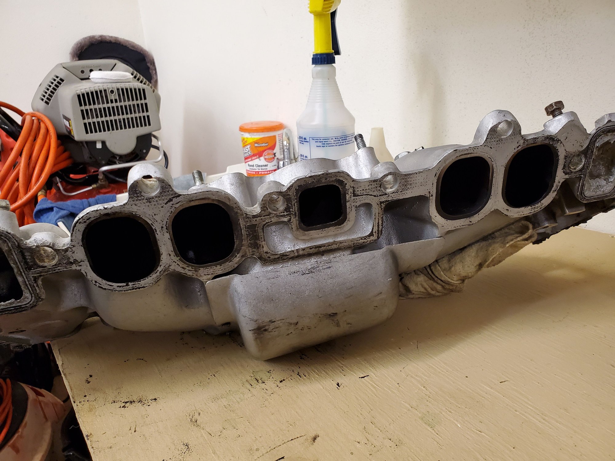

I don't think there is a stock aluminum oval port intake. How about a close up pic of the intake and head ports? And the head casting number .

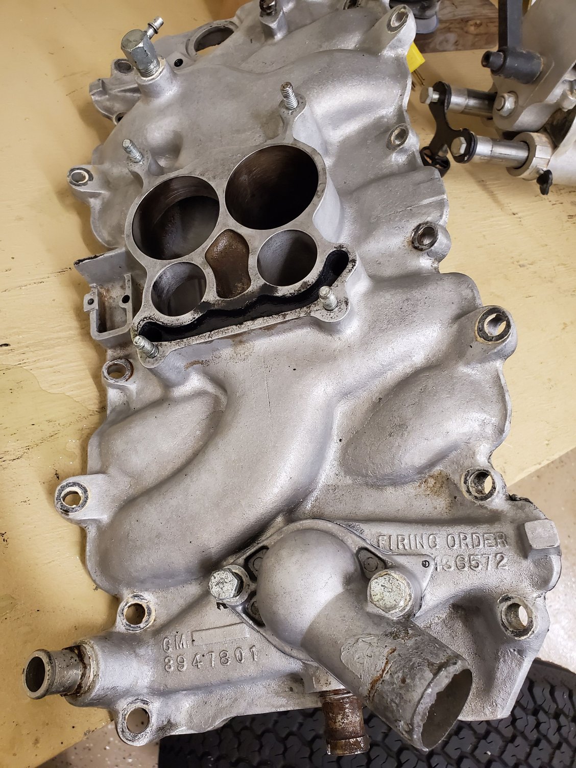

In 69 Winters made the stock aluminum quadrajet intakes for all the oval port head big blocks. I think the intake casting number is 3947801.

Glad i said i don't think it. OK, you do have the cam retainer plate face and bolt holes already tapped. So you can run a stepped nose Gen 6 cam. As long as cam has fuel pump lobe.

Quadrajet intake in aluminum for the 69 BBC. If your going to use a square bore look into the LS6 intake.
The LS6 is a rec port though so make sure to use rec gaskets.

Has to. He has rect port heads. An oval intake won't even cover them.

If you look at the intake ports in the first and last pic in post #325 I think you will see that those are stock oval port heads.

They look bigger than ovals. Then I compared them to rectangles and they are not as tall. I think those ports have been opened up quite a bit. I have a set of 215 heads done like this.
The intake is aluminum
I'm going back the 063 heads

There is also a date code on your intake but it's stamped (cast in) under the tin oil splash shield that is blind riveted to the bottom. Makes you kind of wonder why they bothered...
