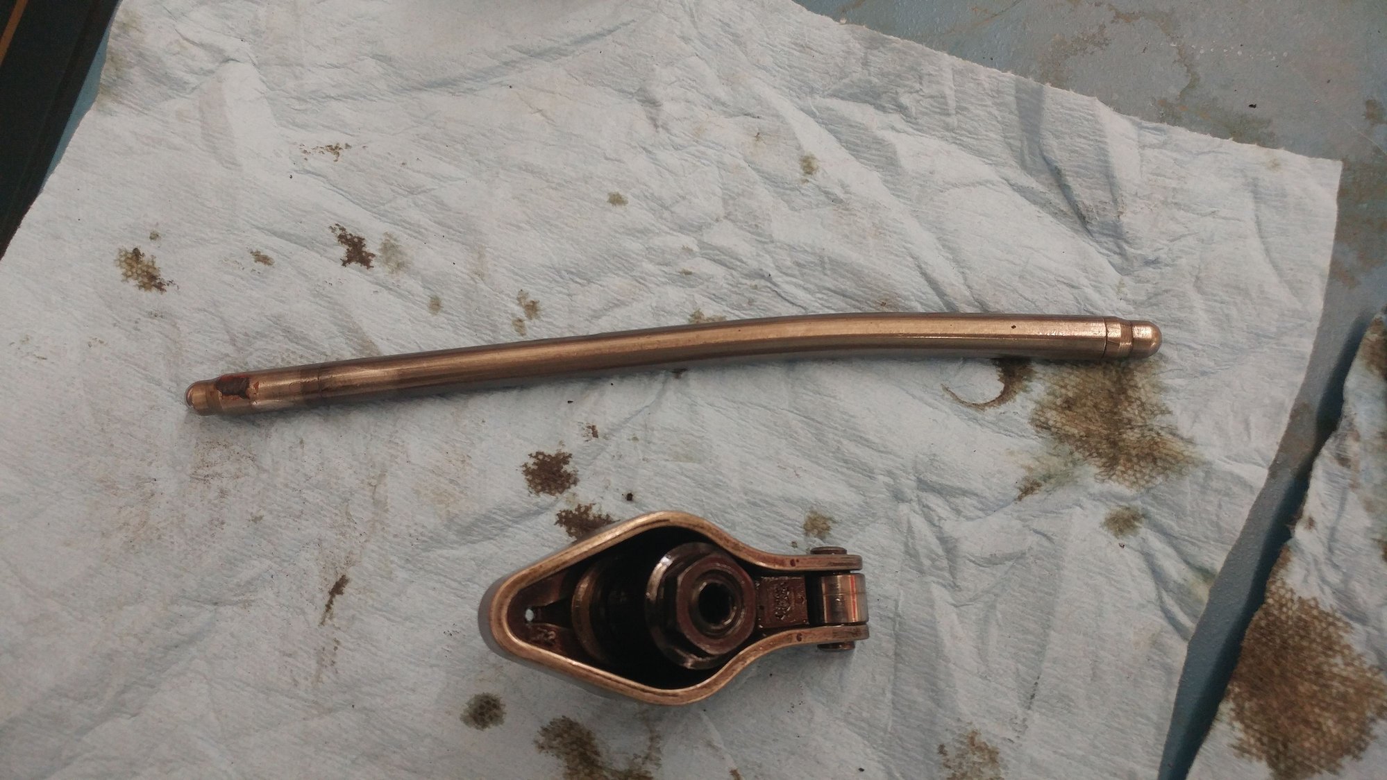

Old Mar 8, 2019 | 08:00 AM
Z06CE's Avatar
Z06CE
Joined: Apr 2013
Posts: 302
Likes: 16
Default Bent push rod pic
Damage from rod guide
Comp cams 1411 1.72 ratio
Old Mar 8, 2019 | 08:38 AM
HeadsU.P.'s Avatar
HeadsU.P.
Joined: Aug 2017
Posts: 8,336
Likes: 2,810
From: Cool Northern Michigan
Those appear to be two piece pushrods. In laymans terms: crap.
Summit has the one piece rods you need. Just match not only the correct length obviously, but the correct guide plate diameter slot too.
And I wonder if those are 1.7 rockers instead of 1.6 causing binding at the fulcrum?
Old Mar 8, 2019 | 08:51 AM
stingr69's Avatar
stingr69
Joined: Mar 2004
Posts: 7,477
Likes: 1,495
From: Little Rock AR
Pushrods bend from some valve train interference. There is something binding. The bent pushrod is not the culprit, it is the evidence of the other problem not yet identified.
Old Mar 8, 2019 | 09:05 AM
redvetracr's Avatar
redvetracr
Joined: Aug 1999
Posts: 18,126
Likes: 174
From: WI
those are "roller tip" rockers not roller rockers, there is a significant difference
Old Mar 8, 2019 | 09:14 AM
Z06CE's Avatar
Z06CE
Joined: Apr 2013
Posts: 302
Likes: 16
They're 1.7 ratio , thats what is stamped on the rocker.
Old Mar 8, 2019 | 09:23 AM
Z06CE's Avatar
Z06CE
Joined: Apr 2013
Posts: 302
Likes: 16
What should the clearance be for the guide plate?
Old Mar 8, 2019 | 09:36 AM
HeadsU.P.'s Avatar
HeadsU.P.
Joined: Aug 2017
Posts: 8,336
Likes: 2,810
THAT! I don't know. Just sayin' like in post 8, you need to know what size guide plates somebody put on there, 3/8 or 7/16. Should be 3/8, but measure your guide & pushrod dia.
Those 2 pc rods are a accident waiting to happen. Sometimes they separate. And its not pretty.
Old Mar 8, 2019 | 09:40 AM
Z06CE's Avatar
Z06CE
Joined: Apr 2013
Posts: 302
Likes: 16
Old Mar 8, 2019 | 09:47 AM
derekderek's Avatar
derekderek
Posts: 13,082
Likes: 3,399
From: SW Florida.
A few thousandths. Mebbe .010. If 7/16 guide and 3/8th pushrod, there will be 1/16th wiggle room. 1/32 each side. It will be pretty obvious if wrong size.

Old Mar 8, 2019 | 10:06 AM
Jebbysan's Avatar
Jebbysan
Dr. Detroit
Joined: Mar 2012
Posts: 10,097
Likes: 4,027
From: New Braunfels Texas
Ok...so you have the Comp rockers that I mentioned......that is why the pushrod bent because those particular rockers are pretty tough with a thick cross section.....GM rocker would have probably broke right off......
So......you have a crash going on....you need to determine if it is the retainer to boss or spring coil bind.......I personally pop one off the I and the E (use air holder or the rope trick) and start inspecting....you can put a light tension spring on both I and E and use an indicator to check distance to bind and distance to retainer crash. Record these number and compare with the cam lift. Don't know your cam? Take the same indicator and go off the tip of the pushrod while rolling the engine over.....it will move like .300, record the movement and multiply by 1.7.......subtract that number I and E from both the retainer and spring bind number.....you need at least .060
If you do not have clearance.....you will have to find a retainer/spring/locator setup that works......
But buy new one piece pushrods......99% of them are made by Trend no matter what brand name is on the box.
Jebby

Old Mar 8, 2019 | 10:35 AM
Z06CE's Avatar
Z06CE
Joined: Apr 2013
Posts: 302
Likes: 16
Jebby
Excuse my ignorance but how did you determine the push rod is 2 piece. Is the ball removable?
I'm at work so I can't examine the rods.
