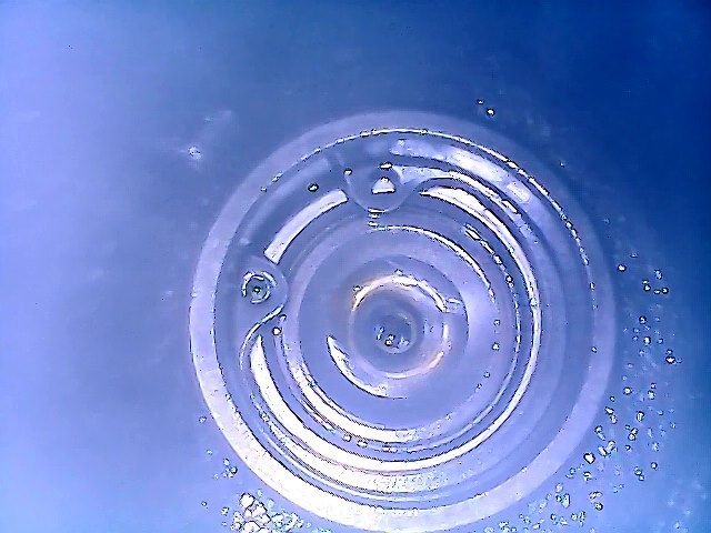

I'm borrowing a bore scope today and I will have a answer for the lifters.

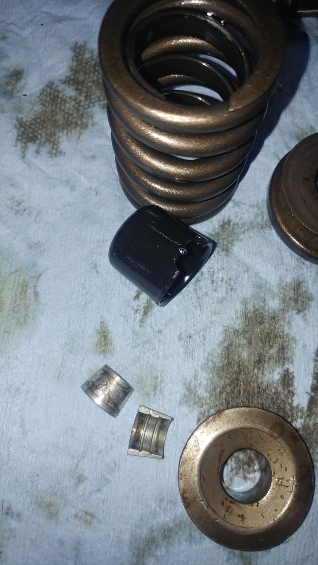

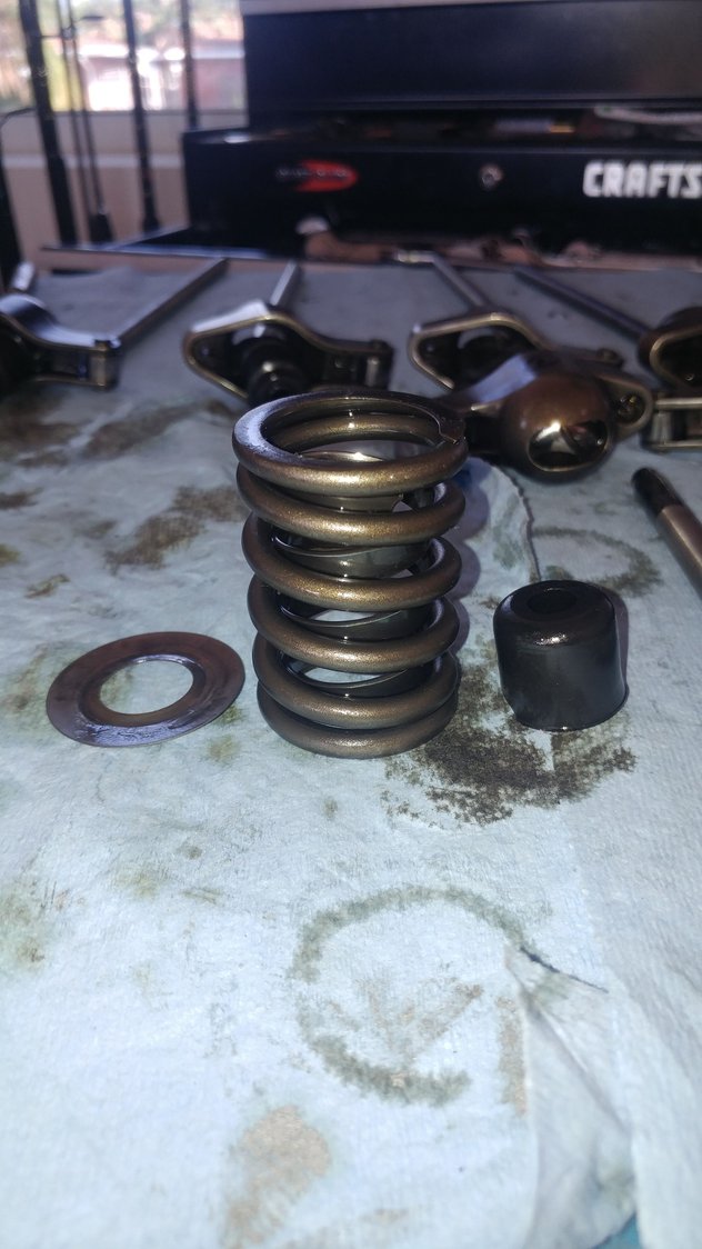

Got the springs off #1 cyl...
Exhaust has a shim then a rotator then spring
Intake has no rotator, has a shim then spring WTF Installed height Exhaust: 2.154 with no rotator or shim Intake: 1.916 no shim... Was no rotator

Suggest you look now to coil bind and/or retainer crash. Find a pair of straight PRs and inspect-measure.

Default Retainer and Top of guide measurements
Intake retainer to top of guide : .863
Exhaust .813
Plenty of clearance
Lift intake is .501
Exhaust is .505
Umbrella seals look like crap

can you see all 16 lifters thru the PR holes?
If they all have snap rings in place ... then there are no wire retainers.
