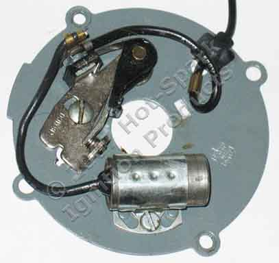

Mine does not look like this. The points and condenser are attached to each other. There are weights above it. Super hard to gauge the gap. I might have shorted the ground wire out. Have yet to see how to remove the plate the points screw to

(that was just a random pic I found showing the black wire going to the points, not necessarily like yours)
If you open the points (piece of cardboard, match or anything), the black wire should have no contact to the car ground when you check with a meter or test light, when they close, the ground connection is made.
Sounds like you may have a short (coil is "firing" all the time)
M
