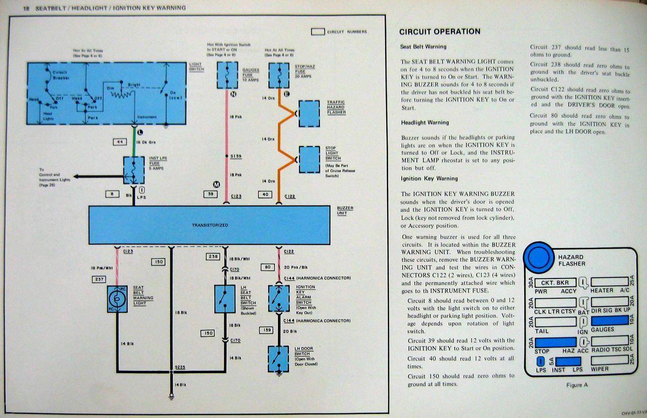

It may be good to start with this. From the 77 troubleshooting manual: The circuit numbers and wire colors may be different on your 78 but the buzzer is the same 77-78.
If you find your circuits read correctly as shown in the circuit operation portion of the page you can always open it up.
If you grind off the 4 corner plastic rivets you can carefully open the buzzer. My original 77 buzzer would not turn off like yours. I found the contacts pitted and actually welded together. A points file cleaned them up. "CAREFULLY" (wire is the size of a thread) open the unit and check the contacts.
Also found a wire that was almost broken so I soldered it.
