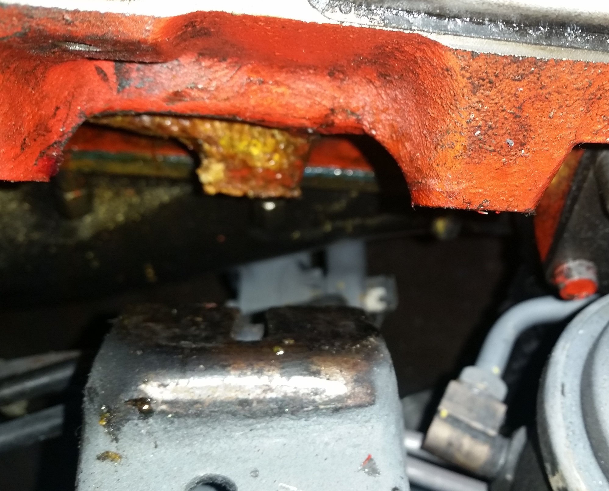

Removed the engine mount this morning.
Mount itself.
Almost hate to post this! Looks like what I left on a barroom floor in Key West once. Disgusting!
Not much room to work with. I can make a little more room with the jacks.
Got one of these doo-dads, but may not need it if the plug's about to fall out anyway.
Updates to come.
Steve

That bad boy is ugly fugly - I suspect they didn't change those out on the rebuild?
Old Apr 9, 2019 | 02:54 PM
  #52
Cavu2u's Avatar
Cavu2u
Joined: Oct 2013
Posts: 2,569
Likes: 126
From: San Diego California
I'm afraid they was me, and I did. BUT with steel plugs. This is a perfect example of why not to use steel.
