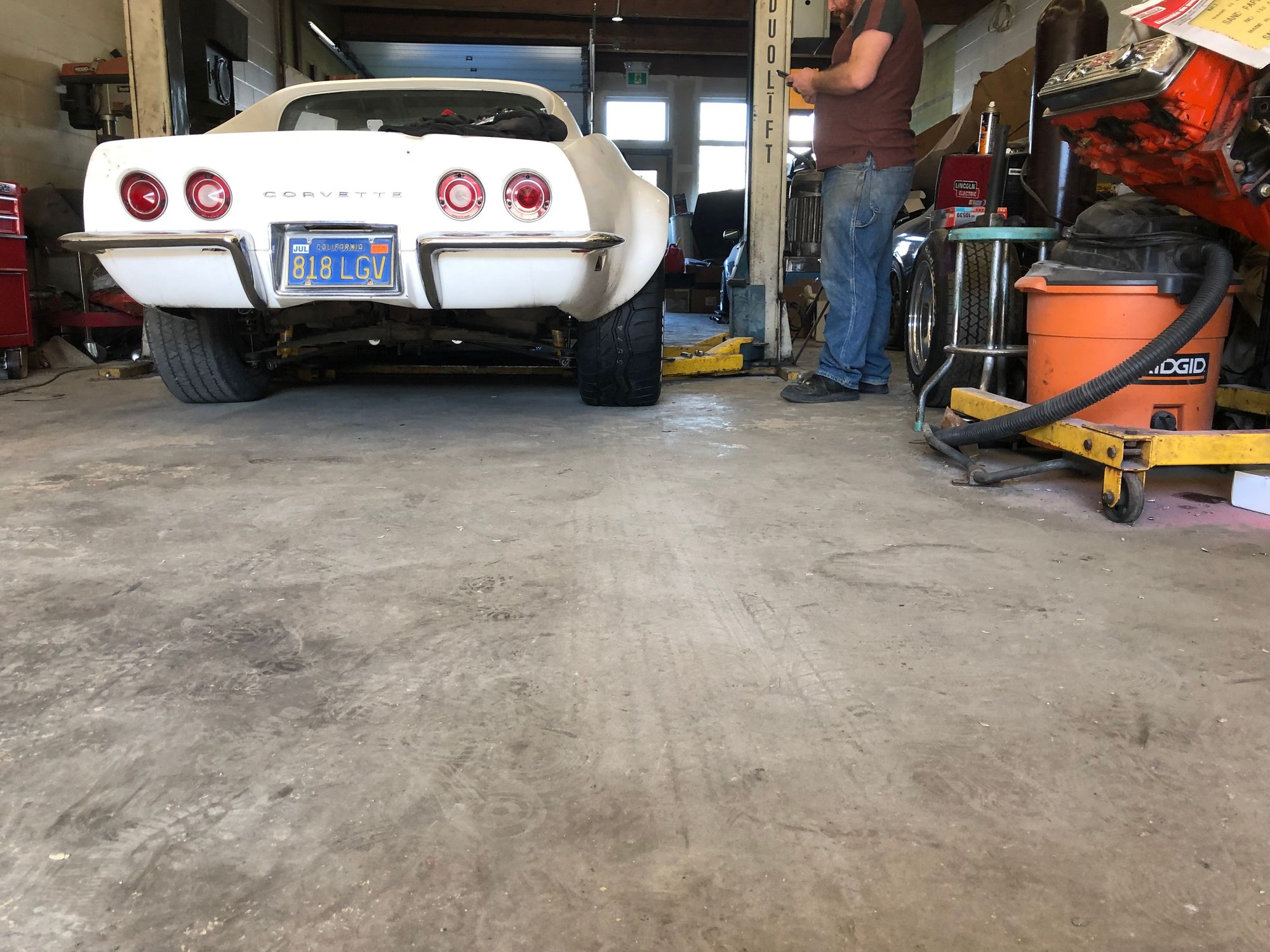

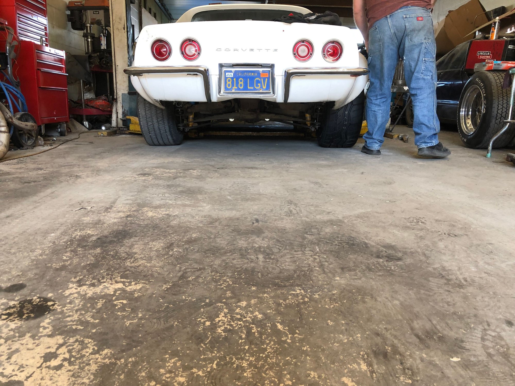

Here’s a shot of the 295 tires on a 11” wide wheel with 4.00” backspace. Looks like I’ll need to add a 0.50” spacer in the back.

It looks like you could fit a 315 tire on your 11" wheels and easily keep it under those rear flares, maybe even a 335 on a 12" wheel if you go with a little more backspacing.

Yeah I think I can as well. I had these 295s laying around so I figured I’ll run them for a while and then change the reads to 315s and add a 0.25” spacer
