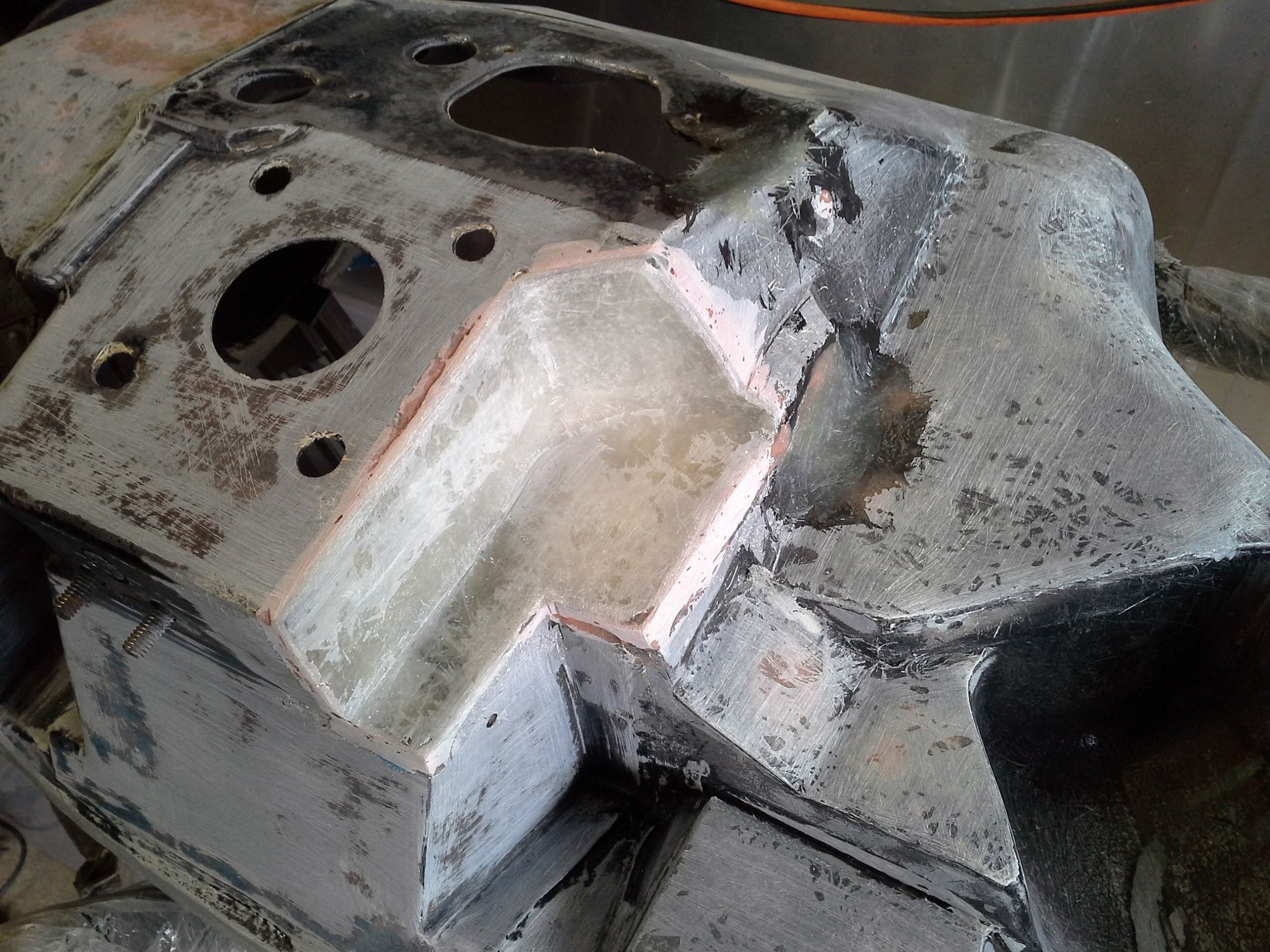

with those tall valve covers on , the engine wont fit in there if you have a vacuum brake booster . take the booster away and you can drop the engine in OK ,but you wont be able to remove the drivers side valve cover without lifting the whole motor.
unless you modify the firewall a bit

I ran roller rockers on that motor in its previous build, I had lower profile covers that fit ok in the 69 vette. This new version has a girdle in there , that's why I HAD to go so tall covers.

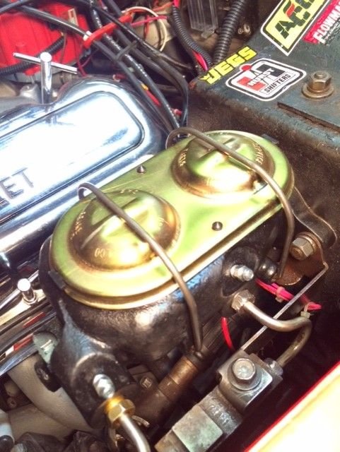

You will find the big block is wider and will have close quarters near the steering g
ear, pitman arm and brake master cylinder. I have roller rockers and taller aftermarket valve covers. You can see how close it is without a power vacuum booster. If you use long tube headers you may need to dimple one of the tubes on each side to clear the steering gear and pitman arm mounting bolt.
