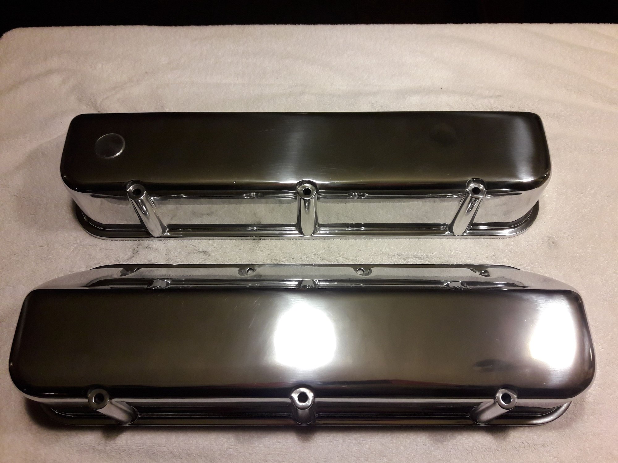

I’ll be running Crower stainless roller rockers on mine.
Stronger and smaller than aluminum.
The speed/machine shop helping me said they use the crower rockers, remove the oils drippers, and machine the locks so everything fits under the stock valve covers.
It you really want tall valve covers, check out Teague Marine tall aluminum valve covers.
They are designed to fit off shore racing boats using custom exhaust.
They will clear everything on my 73 big block.
They are top quality and look awesome.
