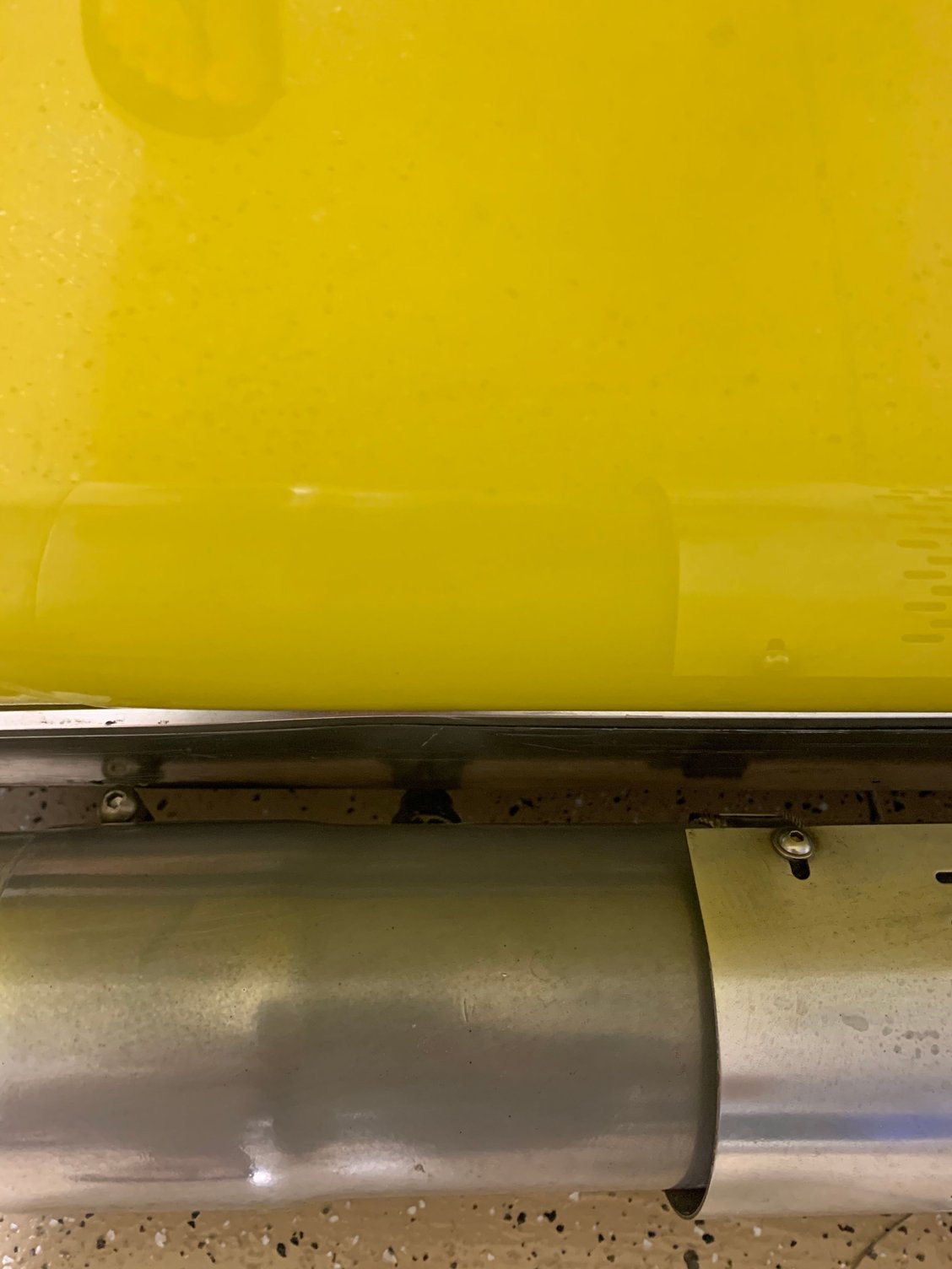

My setup. 496 BBC with FAST XFI 2.0. We installed the bungs in the actual sidepipes. I have bungs on both sides, previously for wideband AFR. Now just using driver's side for the EFI. Angle is not ideal but since the sensor is heated, I have not had any issues.
