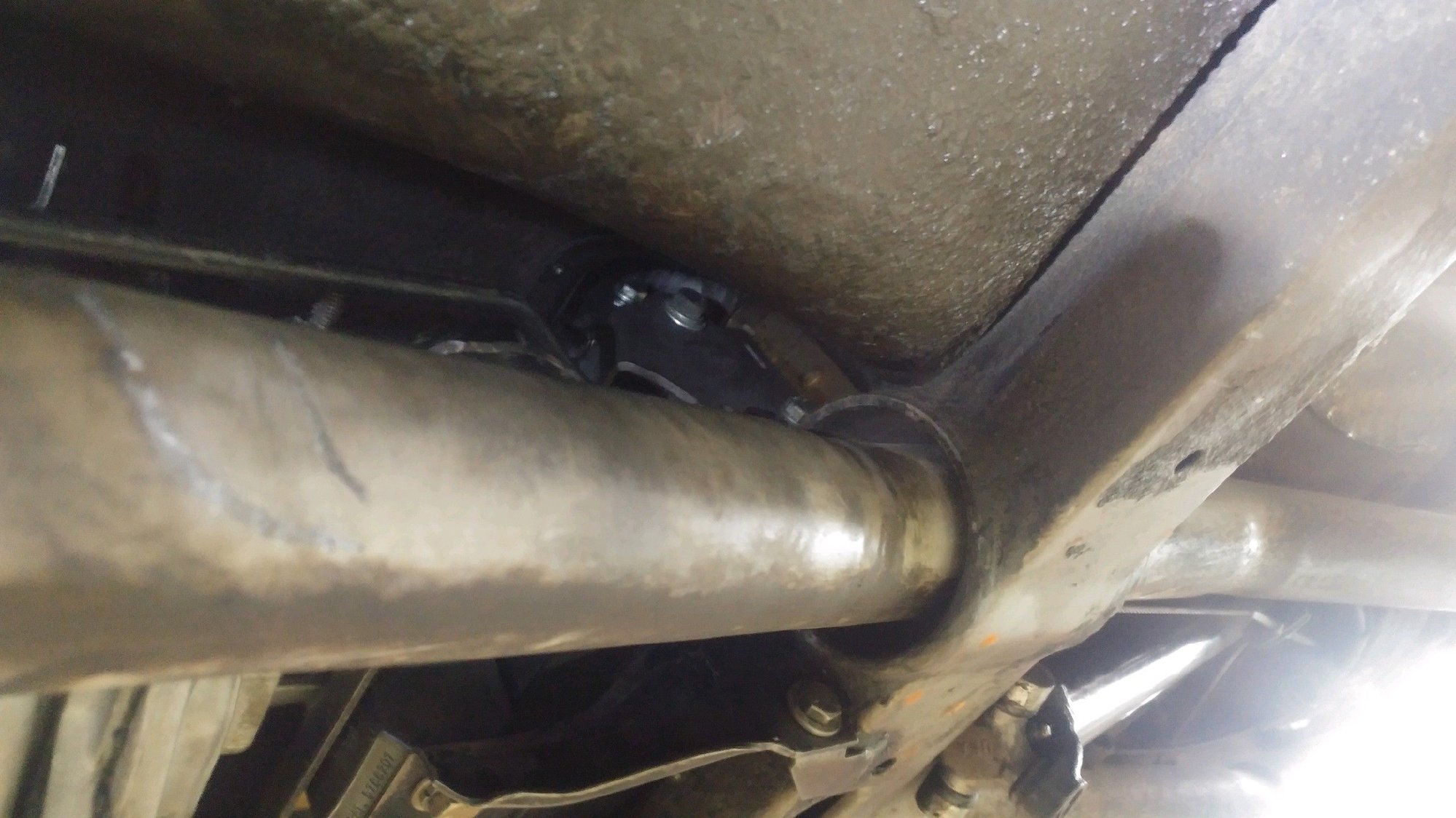

We did the crossmember mod on Friday. Putting in a new clutch and flywheel, fourth time and swore, I'd never do it with the welded crossmember again. Got a nice kit, just for this mod, that came with two sets of parallel brackets, that included Grade 8 hardware. My bud, Jesse is a talented guy and he volunteered to take it on. You will need both a disc grinder and a sawsall, with at least four discs and blades each. You're going to be cutting a lot of steel! Hint: Cut the exhaust! It's far easier than cutting the top of that big piece of hanging piece of steel to drop it. We dropped the emergency brake wheel off've it and then dropped the headers and pushed the beam forward into the trans tunnel. This got you more room as you move forward. Working an angle grinder at that crazy angle is not the way to go. Just cut the exhaust, for God's Sake!

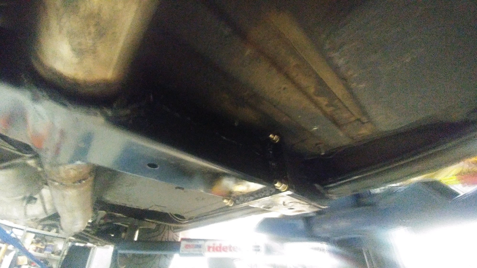

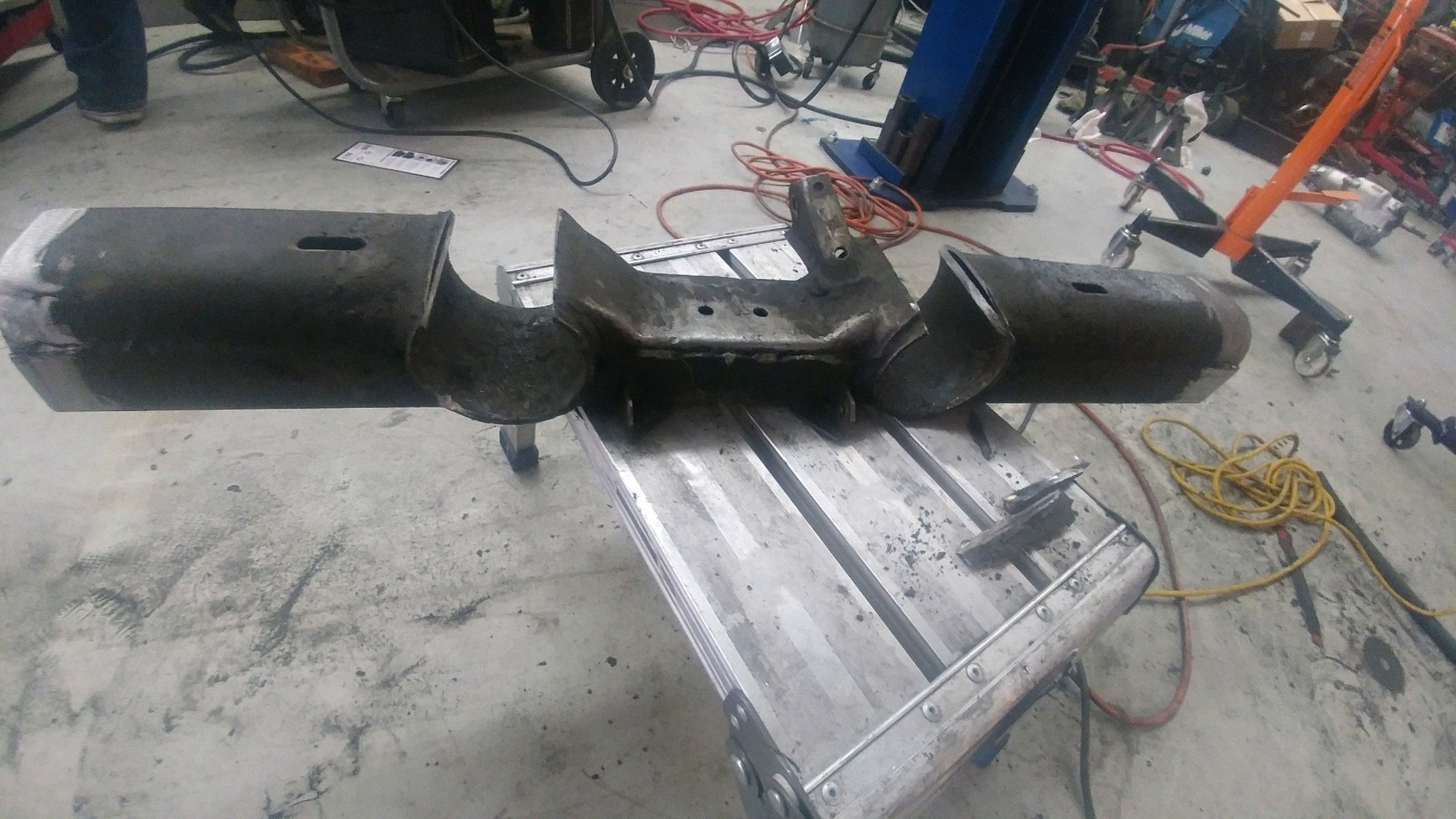

Jesse had never done this and I'm mechanically good, but he's a guy who uses power tools for a living, I don't mind conceding that one. Let an expert Iand a good bud) do it. It had to be a perfectly straight cut, it had to match, flange to flange and it had to fit tightly, with the bolts easily lining up. Then the welding (not me!) and final fit. Jesse nailed it. It's just a little over a press fit. A couple of soft hits and it's in, totally tight Big job and thanks, Jesse!

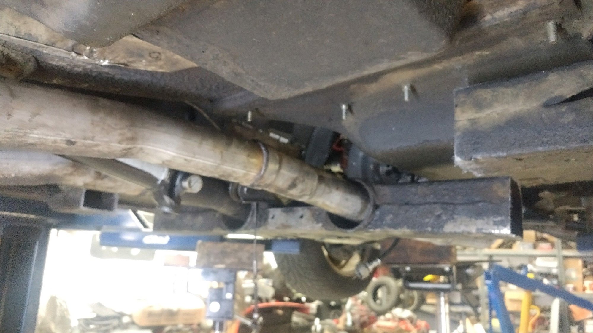

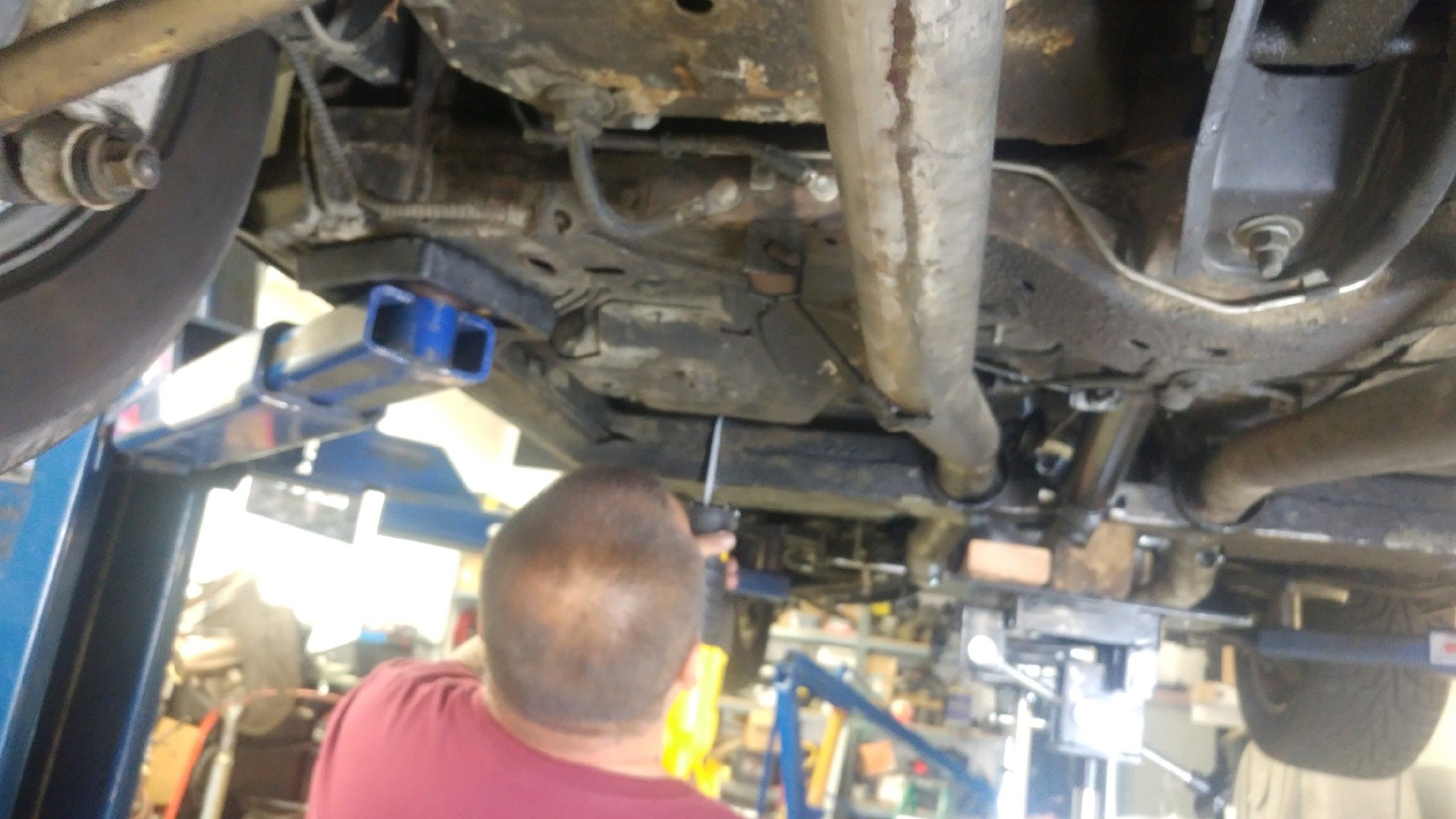

Jesse cutting the driver's side, after finishing the passenger side.
Cross member cut out, but still hanging up on the exhaust pipes.

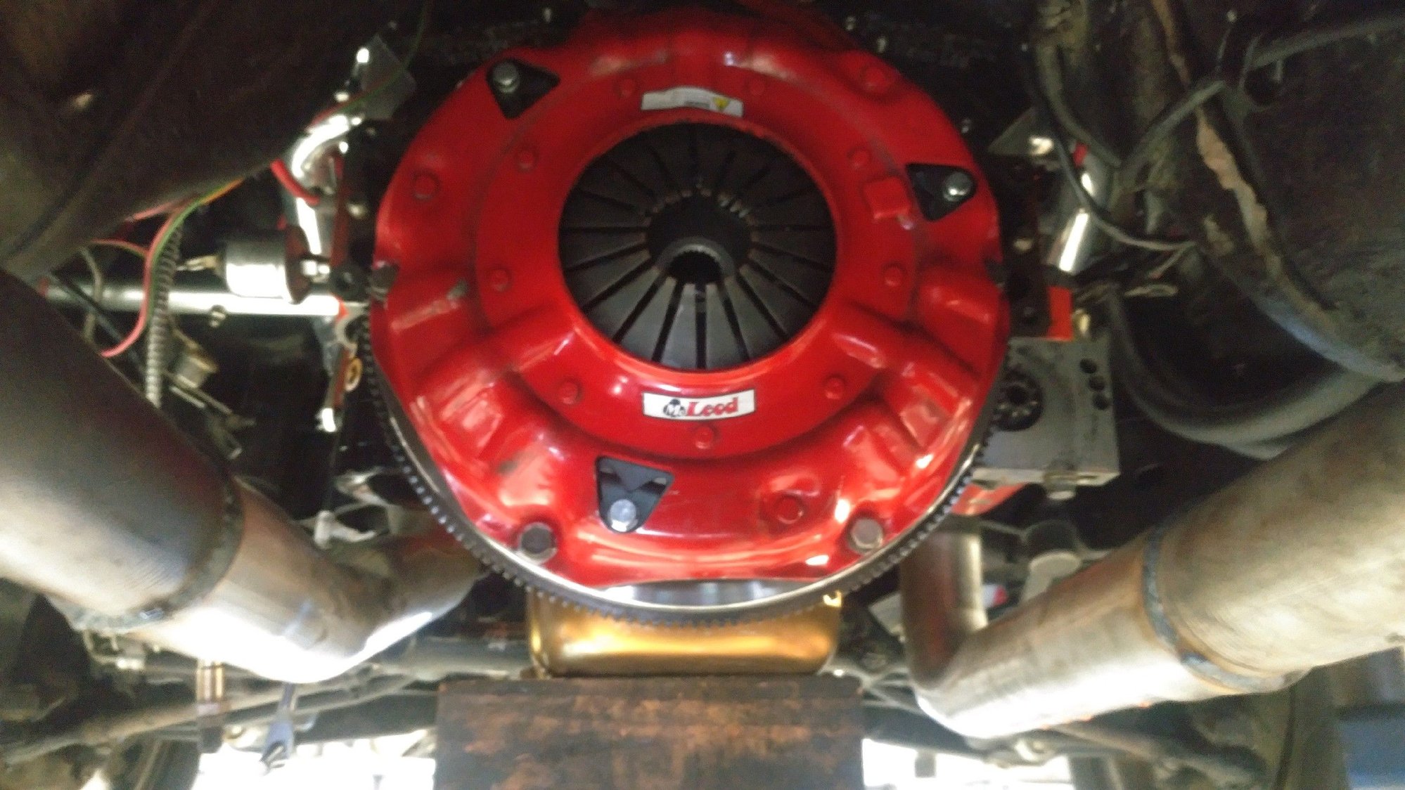

Crossmember out.

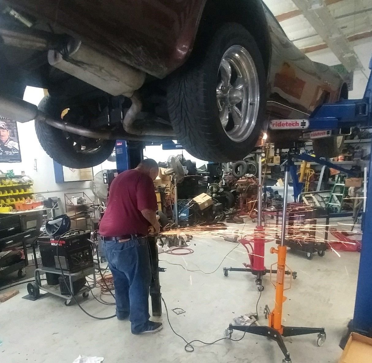

A lot of grinding (careful grinding).
Easier to do here!
Two minutes to finish stabbing it in, with the shifter attached. Straight up and in.
