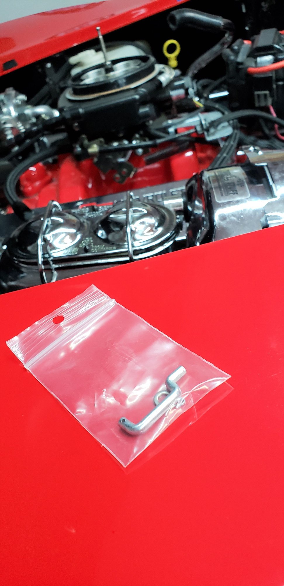

[QUOTE=Tiger Joe;1599277797]
Originally Posted by redcruz1120
I installed the Holley Sniper on my 74 small block.The only issues that I encountered where both "Major". The first was a bad control module on unit right out of the gate! After Holley made it right with another unit the in tank pump didn't build up pressure and turned out to be a faulty pump and Tanks inc. made it right and shipped me another two days later.After those two issues were dealt with the car was running as good as expected. That was over a year ago. Just last month I upgraded the throttle with a progressive linkage and the car just flat-out got WAYY better! before that progressive linkage change the car just had too sensitive on take off and that resolved that! Overall I'm very, very pleased with the change!! one more thing I truly believe that the best way for me was to go with a in-tank pump on a FI ready tank!
could you elaborate on the progressive linkage? I have a sniper on a bbc.
This piece right here is the linkage. You need to remove the old piece and replace it in the proper position as per instructions to allow the primaries to open before the secondaries as opposed to the way it is from Holley where all four open at the same time. You will have to update software in system to the latest version too.. There is a Youtube video on this.

Taking off for example,from a red light was too sensitive like too much throttle since the Sniper throttle body linkage opens all four barrels evenly when you depress the throttle. Had a few backfires so I would have to lightly goose the pedal to avoid embarrassing moments with all four . After doing the progressive update it's more like a more of a modern car with constant smooth advance right from take off and when you drop the hammer the response is incredibly better.The progressive linkage that opens only the two primary barrels at first and then brings in the secondary barrels at a later point at about 40% into the throttle . If you're not having similar issues I would just leave it as is. I hear that progressive linkage and the software that comes with it is not for everyone tho. Thanks!!!
I splurged and let go of the $9 for the linkage! What the heck - I tried it to see how it felt on my car. I wasn't having the issues you were experiencing. However I think I like the progressive linkage better. Its still learning so it may get even better. I agree it is more like a modern car feel - less like a dragster! But power is available! Thanks for the suggestion.
I did have to play with the system settings as to letting the system know when to start dumping the fuel on the second set of barrels!. I was having very mild hesitation when dropping the Boot. after adjusting it to just one percent it made a difference! ...Thanks!
