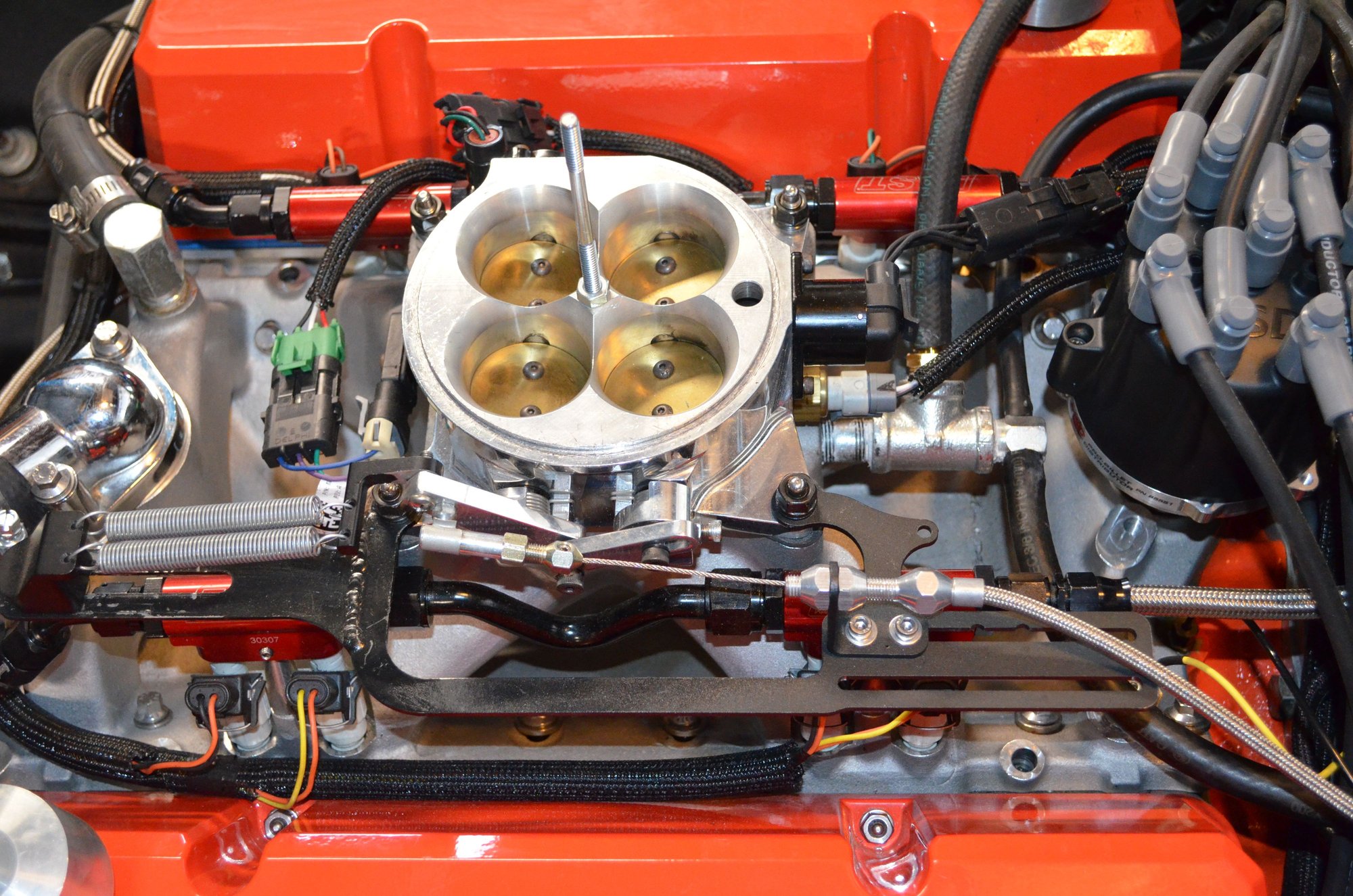

I installed the FAST EZ EFI 2.0 multiport. Jury is still out. I had some installation issues. Nobody makes a throttle bracket and return spring setup that works right with this throttle body so I had to make my own out of an off the shelf FAST bracket and a welded on extension/other manufacturers return spring.
On the engine dyno, it fired right up and idled great. We pulled 7 times and gained a lot of power through the ECU learning to put more fuel in.
On the street, it hasn't quite had the same success yet. I still have some off idle problems (manual trans), and the power isn't near where it should be according to the dyno numbers. It starts and runs great, but it doesn't seem to learn at all. I have fixed a lot of minor issues (unrelated to the actual FI system) that may have caused it to not live up to its potential, but as of right now, I can't tell you to go ahead and buy one. The online support is terrible. They don't return emails and their message board isn't even staffed by their own employees.

Update. Spent the entire day Sunday correcting 2 major issues (with relatively easy and cheap fixes) that were causing me problems. I am positive both of these issues were screwing up the learning function and power level. One was totally my fault and one I consider to be a mistake on FASTs part. I spent a lot of time scratching my head and chasing things, but these were the last two and made all the difference in the world. Engine now runs fantastic in the car. It fires and idles perfectly, and I am feeling every one of the 500+ HP. Wish I would have had some more info in the manual and online to help me but I think its there now.
There is definitely a learning curve with installing an EFI system!
