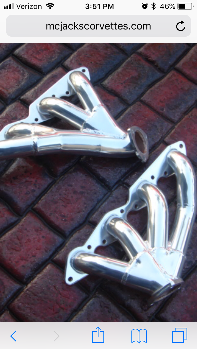

Mc jacks shortys direct fit and bolt right up to your stock system, expensive but a pleasure to bolt right up
Thanks for reply ! I am looking for full length headers only.
Thanks again!

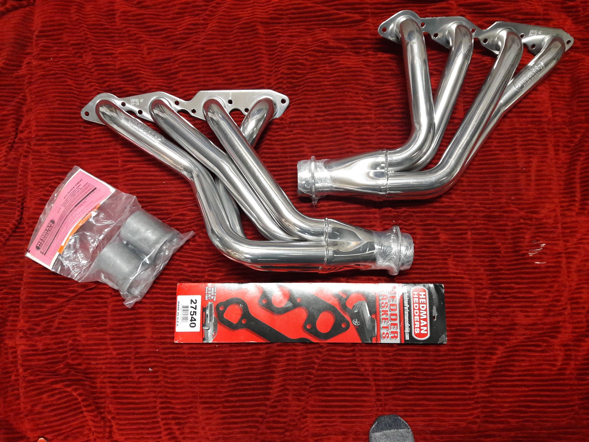

You are correct only two options for long tube big block headers for C3's.
I purchased a set of Hedman P.N. 68096 for my 496 project.
2" primary tubes, 3" collector, ceramic coated, with ball and socket style collector flanges.
The Hookers only have a 17/8" primary tube which would be ok for a 454 but was marginal for my 496.
It was a toss up between the Hedman's and Hooker's but I heard Hooker was having some quality issues lately so I went with Hedman.
I did have a set of Sanderson short tube headers originally and their quality was the best I've ever seen on a header.
I called Sanderson who told me they would custom build a set of long tube headers for my 73, but the cost was through the roof so I had to pass.

I have the Hedman on my 71 LS5. Easy install, even with factory A/C for me. Fit was awesome even with 4 speed linkage.
Thanks for the reply! I have a 454 that is being built right now - 550-600hp. The alum heads I am using have rectangular port exhausts, I noticed the Hedmans have round exhaust ports. Also didnt seem to find them without the socket style flange?
I called Sanderson several times now and can't seem to get a call back - apparently don't need my business.
Have you heard of anyone using the Doug's headers with success?
Thanks for the reply - unfortunately the pic won't load

I have edelbrock bbc heads with the D-port exhausts and Hedman Headers. No issues there but we did have the massage the passenger side pipe closest to the frame.

Unless things have changed (always possible), Hooker has 2 long tube headers for BBC C3's. The 1 7/8" fit well. The 2 1/8" are more race oriented and have ground clearance issues.
It's been a while since I got my Hooker 1 7/8" set, but at least back then the ceramic coating was garbage. If I got a set today I'd get them bare and have them coated by someone that does quality work. I had mine re-done after the factory coating flaked off. This is what they look like recoated.

I've had both, the 2" Hedmans and the 1 7/8" Hooker Super comps. The Hedmans fit better, with virtually no massaging, although mine does occassionaly bump the steering box. The Hookers needed a good bit of "dinging" to clear the idler arm. Also, the Hedmans are pre-clearance'd on the flanges to clear the head bolts, whereas the Hookers, you'll be grinding notices in the flanges to clear the head bolts.
The Hookers are equal length tubes and the Hedmans are not...Collector design of the Hookers seem like it would make more power. Primary tube lengths and collectors are longer. I think power wise, its probably a wash between the two, maybe leaning towards the Hookers.
The Hedmans are cheap, have ball collectors and install very easy. Can't go wrong with either option, but neither is perfect.
You could have Lemons build you a set for about $1500 if you're really building something trick.
