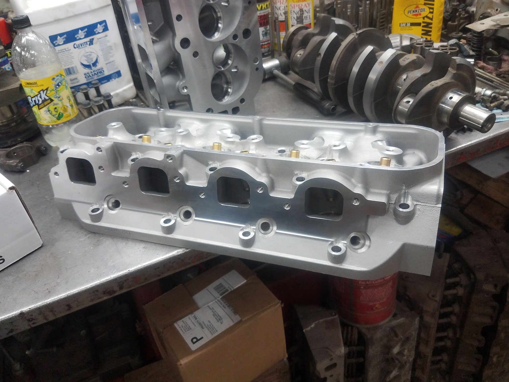

My concerns with the Hedmans is the oval port primarys against my D port heads - it will leak and header leaks are no bueno.

Curious, what brand are the Heads and what are the Exh. Port dimensions?
I have AFR Heads and am considering making my own long tube headers but I'd rather find a good source (the BB's are painful for this type of stuff)

Shape of primary doesn matter as long as it covers the port.
My Edelbrock heads have D shaped exhaust ports and the primary tubes will cover the ports.

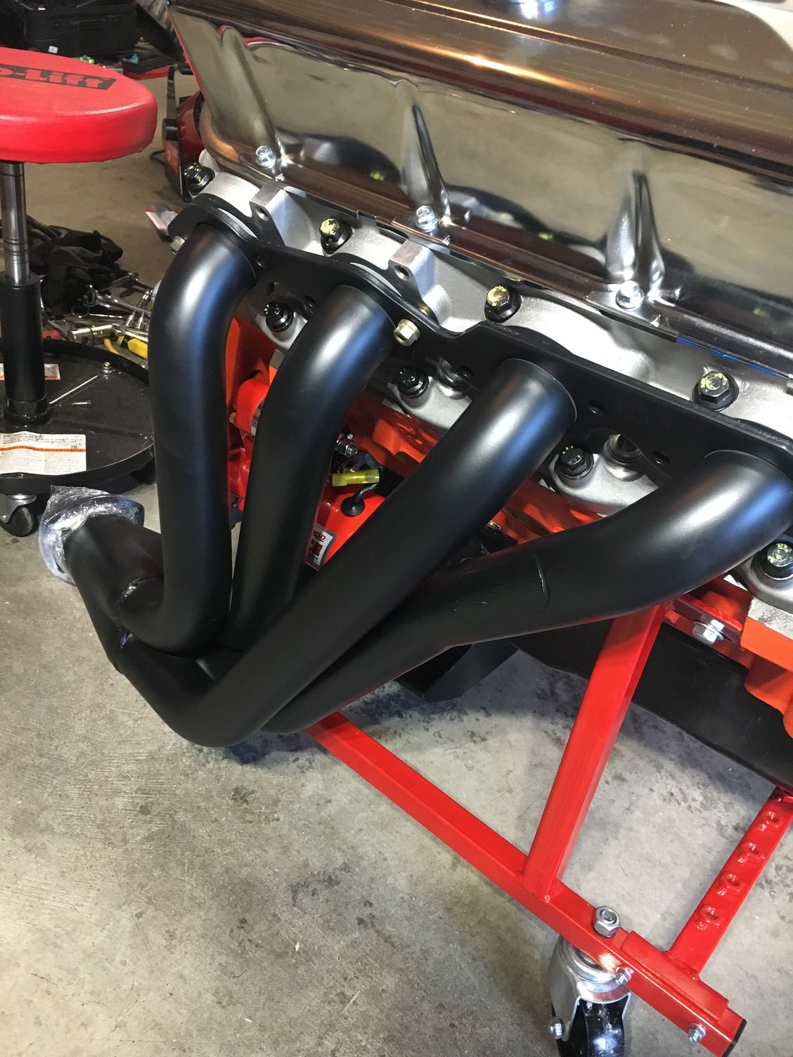

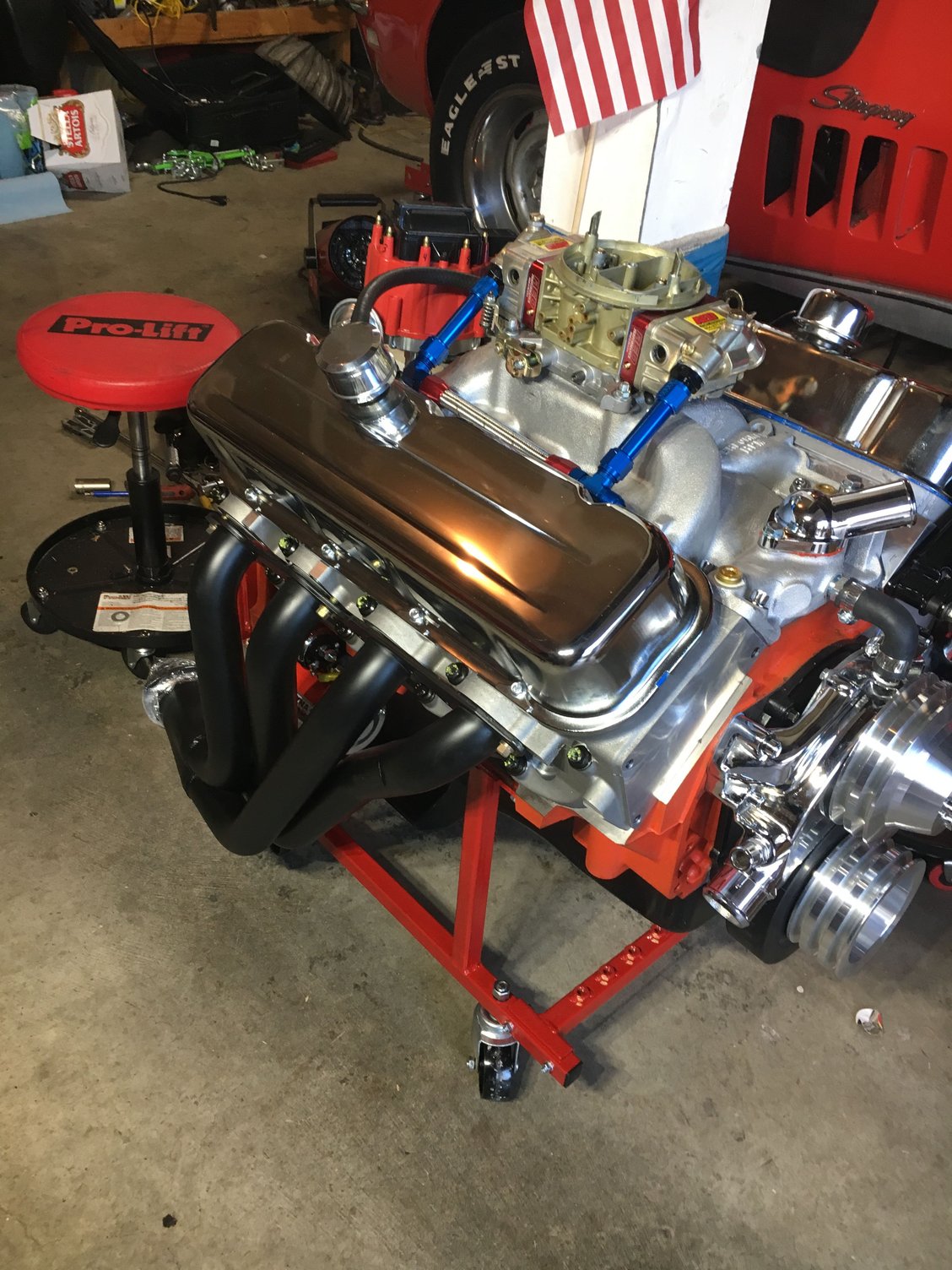

I'm running Hedman and they fit very well. With my aluminum heads, they had to be slightly dented on the #3 pipe to clear the steering box, but now that I have rack and pinion, they clear everything beautifully.

What are you engine specs if you don't mind me asking?
What carb is that?
Looks sharp!
