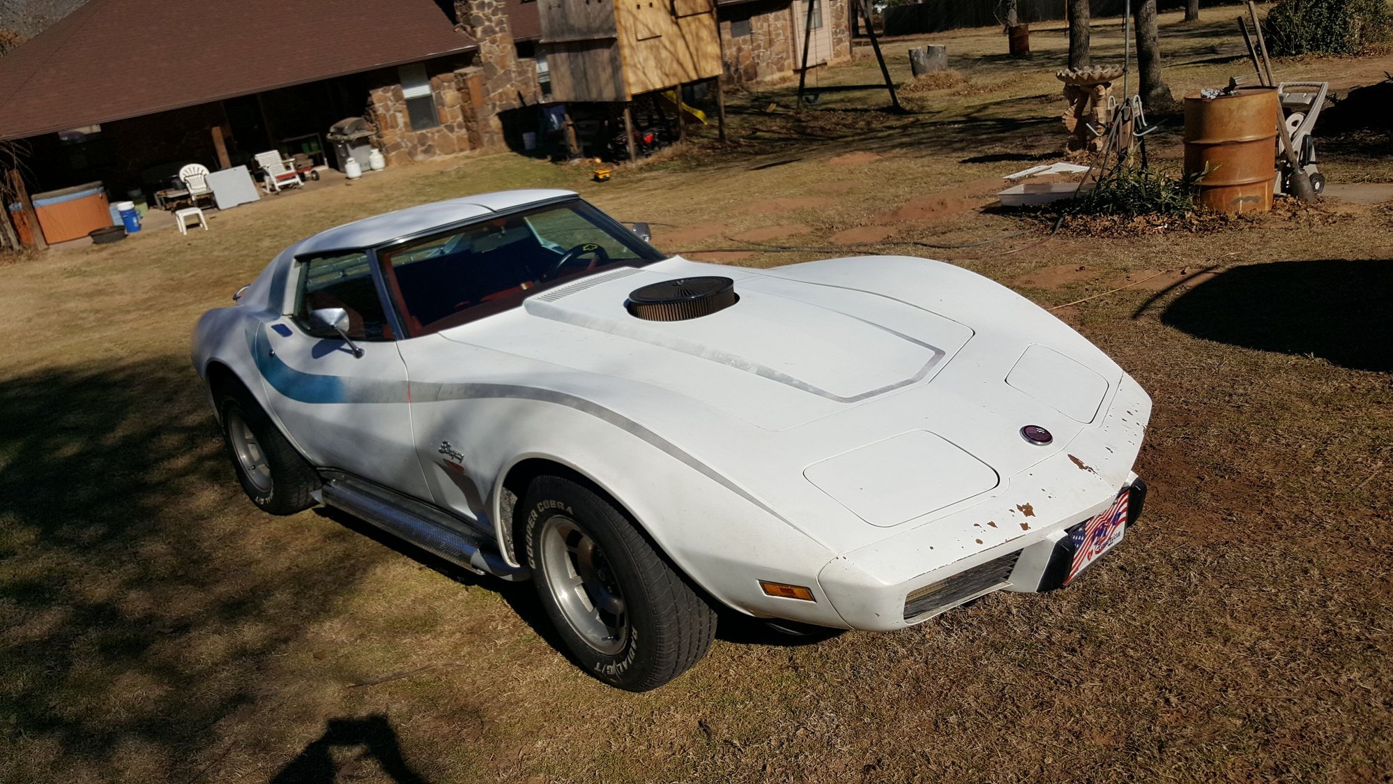

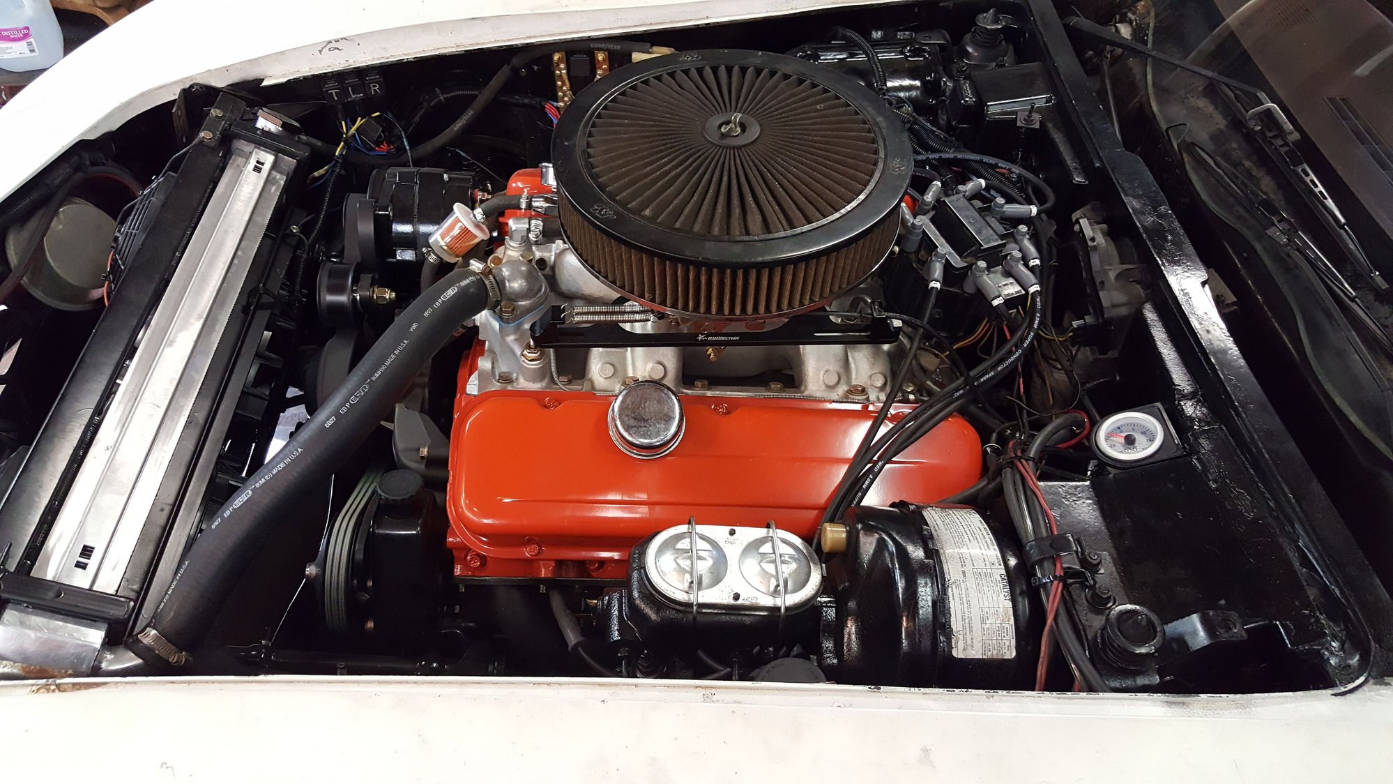

I call mine the 1/2 inch car. I have at least 4 spots that clear by about 1/2 an inch. Thank God for poly motor mounts.

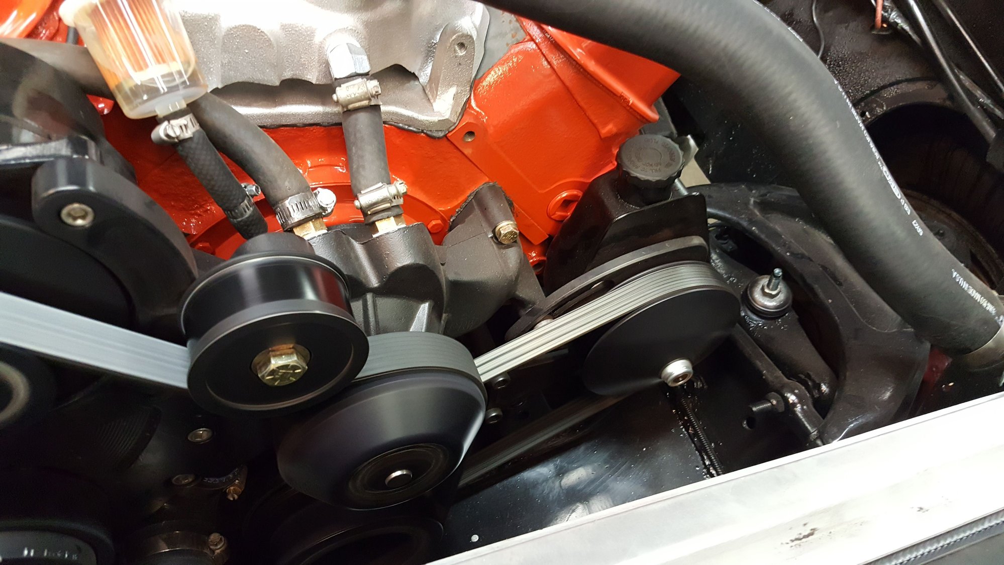

Love the belt set up Gilmer? The idler/tensioner is a slick idea
OP what kind of intake do you wanna use? Incorporating a spacer? How tall a filter do you think youll need, dont want to compromise on that for the sake of "fitting".

Thanks for the response guys! Great set up godrocksus1.that sure is nice and snug. How much hp do you have in that bad *** machine. I’m ready to spend the money haha. I already ordered the poly mounts. Did mounts need to be moved or original spots are good? I see you have AC in there. Where did you get the belt system or did the engine come with? Any other advice do you have for me. Sorry for all the questions man.
Im putting in coil overs, rebuilding the rear end, and disc brakes all the way around.
I do plan on getting a cowl hood for hood clearance And a slimmer filter.

The front end assembly system came from a company called Black Mountain precision it was pretty expensive I'm not sure I'd do it again because it's really really tight but it works I had to shim the passenger side motor mount with a couple of nuts you noticed my engine is clocked clockwise just a tiny bit I was also able to use the truck 454 pan but I had to fabricate a new power steering mount on the frame rail to drop it down a little bit to clear the other interesting thing is I've got roller rockers most Corvette guys say you can't run roller rockers because you can't put the tall valve covers cuz they won't clear the power booster on the brakes Fram makes a double gasket system that allowed me to use stock valve covers that gave me just enough clearance on both sides I'm running 373 gears in the back and it has been rebuilt new Moog U-joints everywhere I'm hoping I don't ever blow up that rear end I haven't dyno'd the motor but it's a full roller motor bored to 468 we are estimating right around 500 hp
