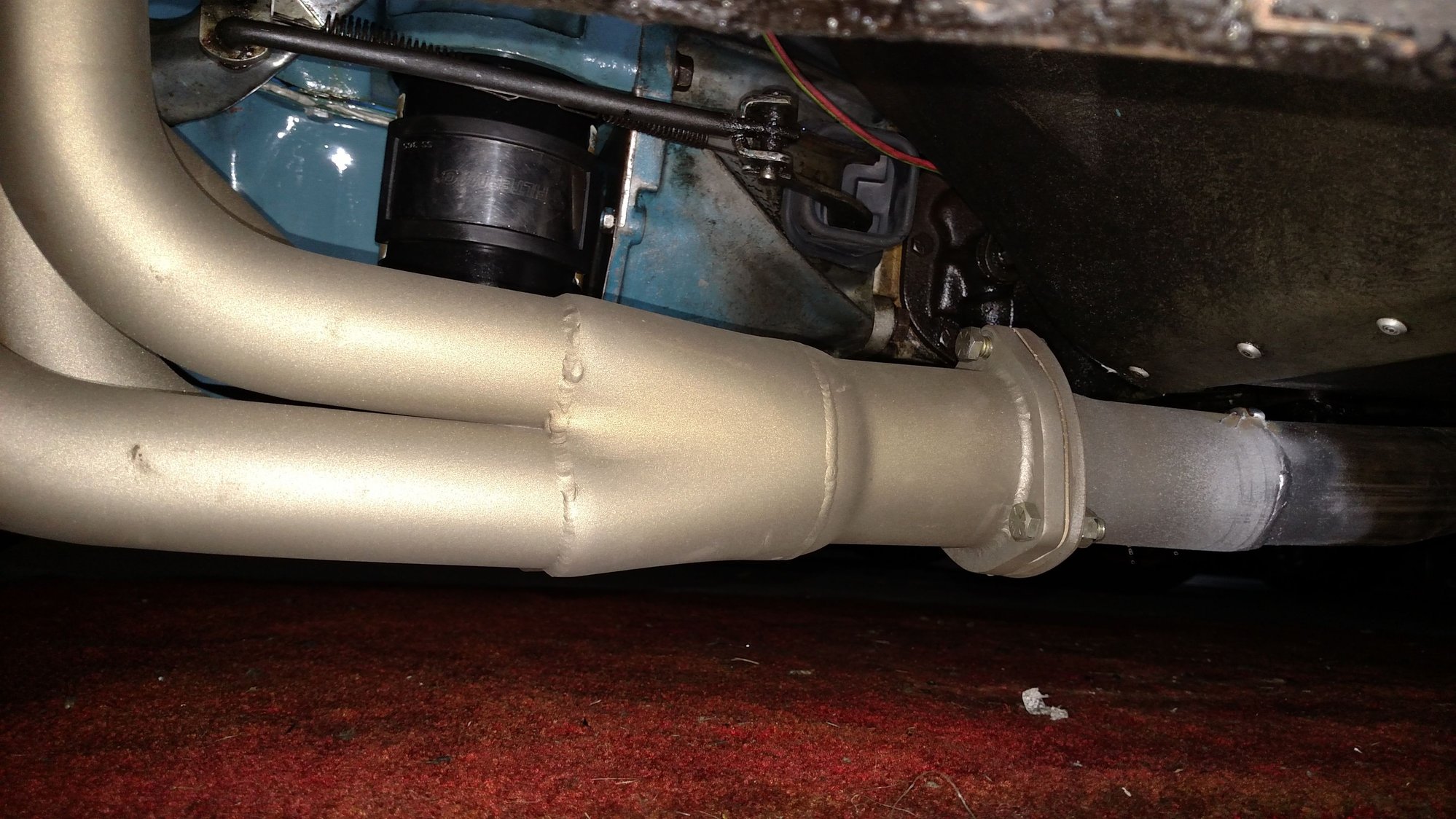

If you are concerned about ground clearance, check out the Sanderson short tube headers.
They offer several long and short tube headers for small block Corvettes.
They are top quality and come silver ceramic coated inside and out.
Originally Posted by F22
Indeed they are nice headers. Just installed their blockhugger pair on my straight plug heads. They are so tight, that you can barely get the plugs in! Plus, you should run boots over the spark plug wires, because the wires run so close to the pipes. They are coated for sure and that might help with the heat problem, I had with my last (unnamed brand) block hugger headers, that the number 3 pipe, ran only an 1/4" from the steering box. In the past, this pipe would heat up the steering box, which in turn, heated up the steering column shaft and then the floor mounting plate. I measured with a temp gun, from the inside of the car and got a temp reading of 160 degrees! Here's the kicker, the Sanderson headers run even closer! But due to the silver ceramic plating inside and out, the heat, might just be reduced. I will report on this, as we go, as I just got my C3 back on the road, with a 383 stroker and of course, Sanderson Headers.
I used Sanderson block huggers on my rebuild. Actually toured the factory and picked them up there. Excellent build quality and the ceramic coating doesn't carry the same bs break in warning as some of the others. Install as per instructions, took about a quarter turn on a few bolts a few weeks later. I did wind up using Taylor ceramic boot plug wires to keep two plugs, # 5 and # 6 from arcing. I have been very pleased with mine. They are not discolored and do not seem to project excess heat. And no hammer mods required, either.
https://www.sandersonheaders.com/san...category_id=26

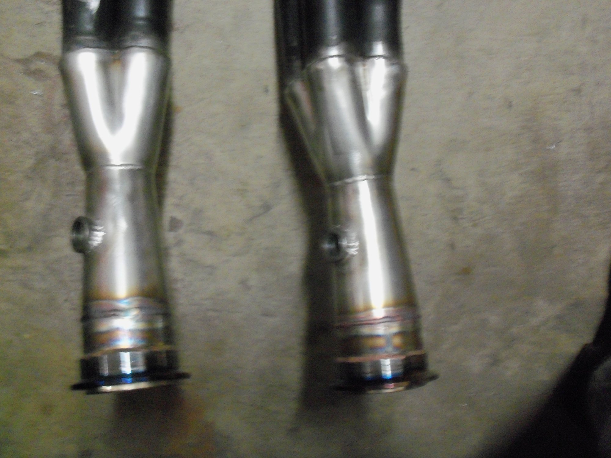

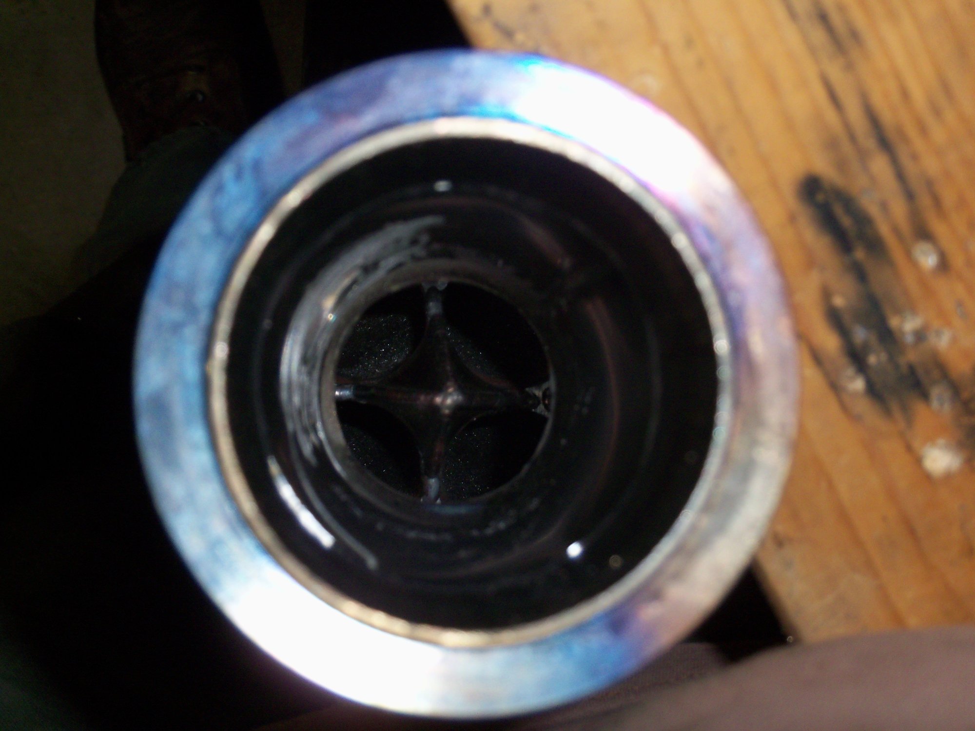

I disagree that you can buy a cheap set of headers and add features like O2 sensor bungs and maybe merge collectors and not have them "look like crap".
Point well taken!! You did a good job....
